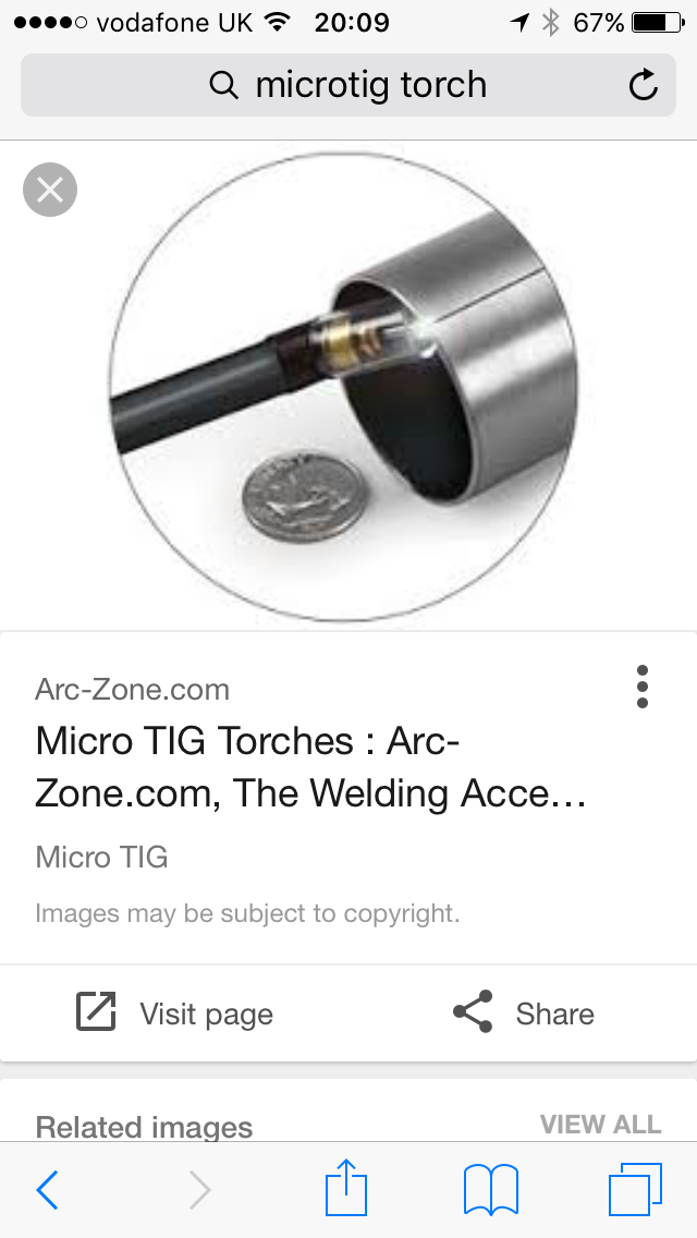

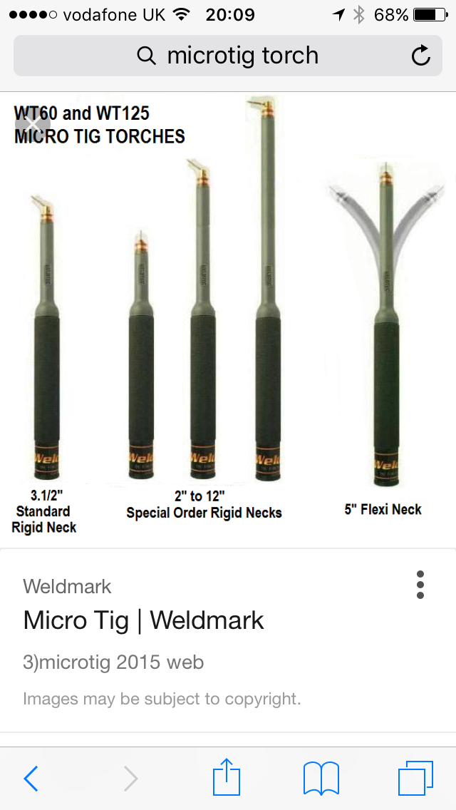

WP26 isnt going to be ideal, a WP9 would help you but even that may not be able to get to some places.
Yes it is Chris, a more ergonomic would be brill.This link will give you some ideas as to sizes and whats available,
http://www.rapidwelding.com/dynamic/Category.aspx?c=CKGAS&o=0&zl=2&sq=14
You can get better prices if you shop around, and Other brands are available.
Many members are very happy with Speedway torches .
