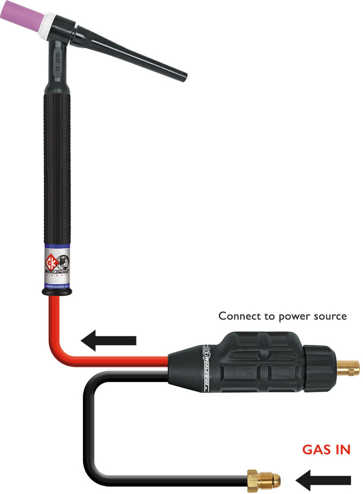

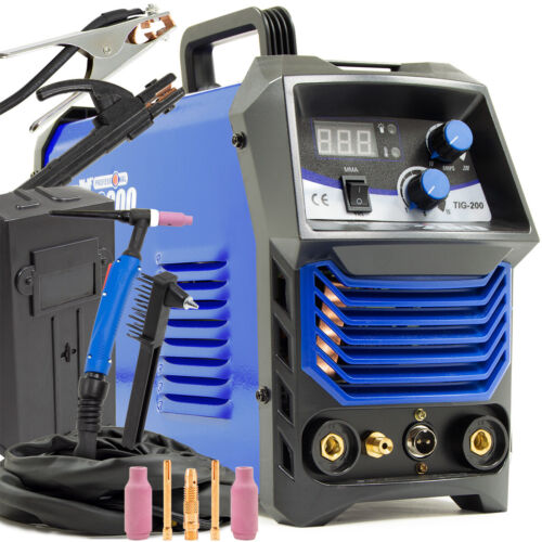

The gas connector on these chinesey machines usually doubles up as the torch power connection, not sure if this has been said already as this thread is somewhat confusing, so for tig you'd use the pos dinse (it'll be 10-25) for the return lead, and the gas connector for the torch lead, thats it... usually, try and find a manual for your machine if you're unsure, honestly its what i'd bet on though, if not, use the adaptor and a piece of hose and a barb for the gas connector
WP17 TIG WELDING TORCH GAS TRIGGER SWITCH HIGH FREQUENCY HF AIR COOLED 10-25 4m | eBay
WP17 TIG TORCH. - Torch model: WP17. This torch is ideal for high frequency TIG welders that require trigger switch operation. The gas inlet can be attached directly to your regulator with a hose so no connection required to your welder, or alternatively the Dinse power plug can be unscrewed and...
