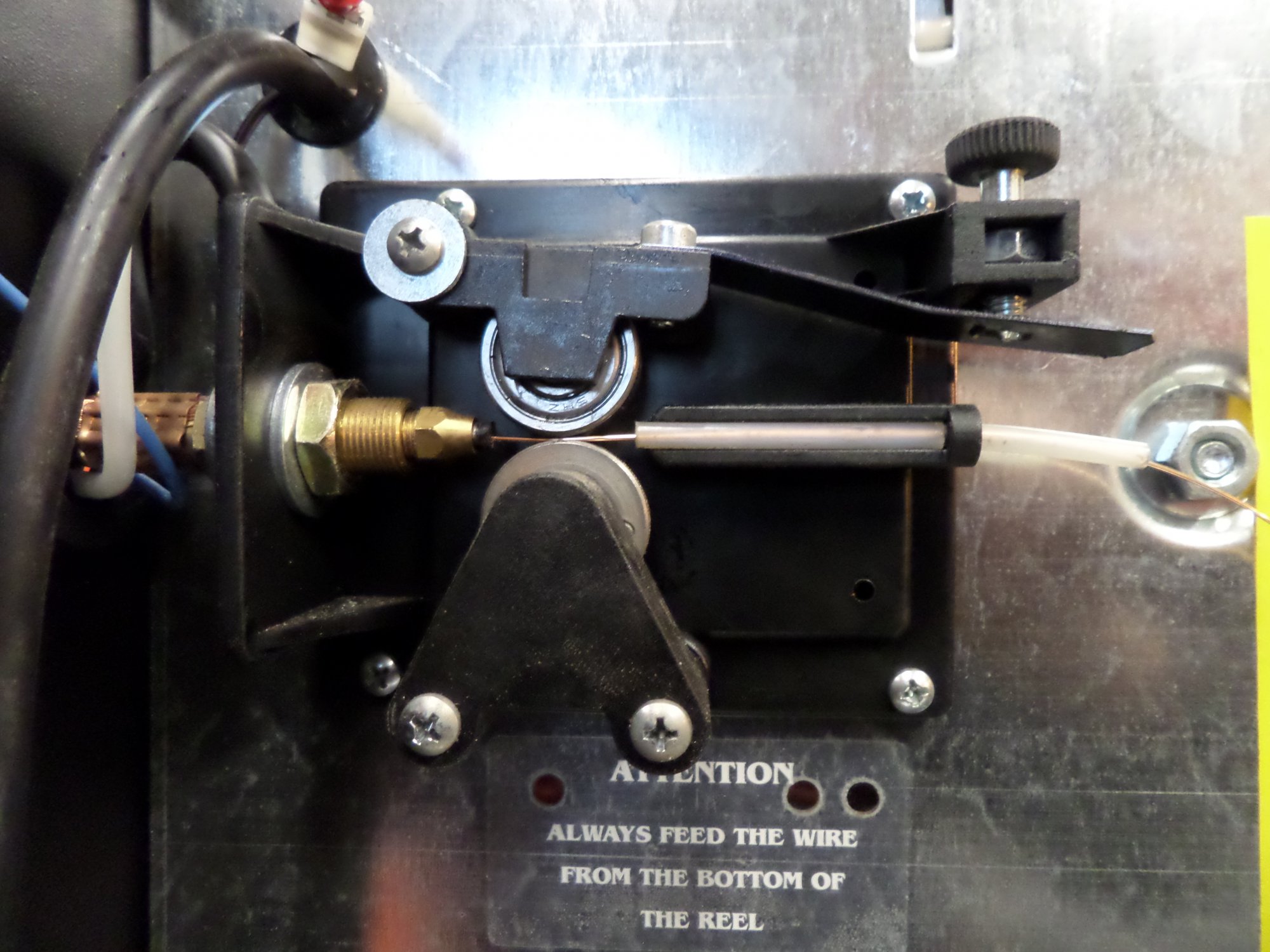

- Moved the wire feed off of the welding transformer and onto a permanent 240V switch mode power supply, as here
- Bought a steel liner and torch repair kit for around £30 from weldequip
- Threw the bell-wire earth strap in the bin and replaced it with a 300A 6M cable and clamp off ebay for, I recall, around £10

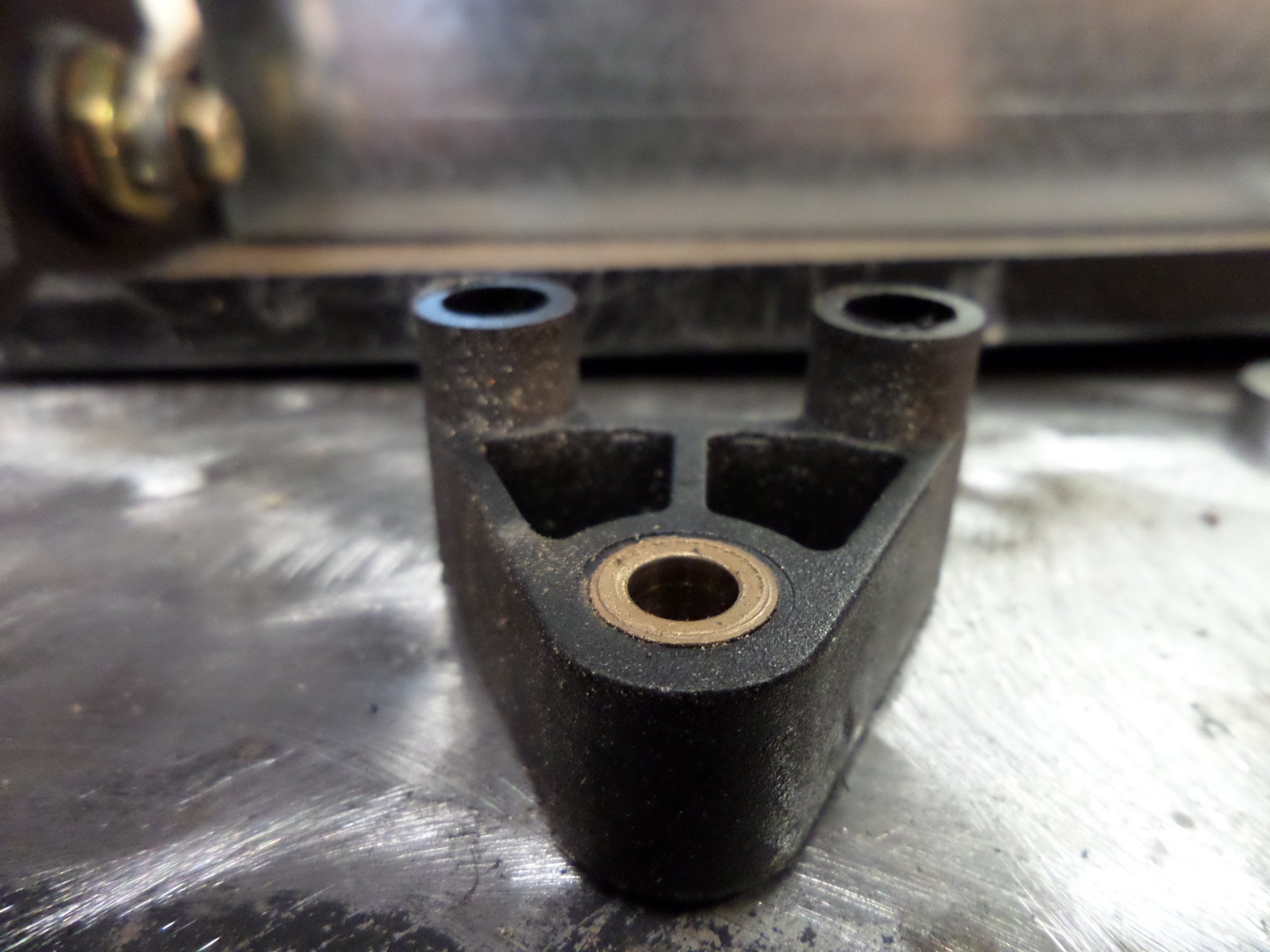

- Fitted a brace across the wire-feed mechanism, as here
- Replaced the 1K wire speed pot with a 100 ohm pot, which gives far more wire speed control. Discussed halfway down here
