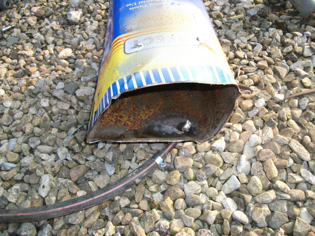

anyone worrying about there comp tank

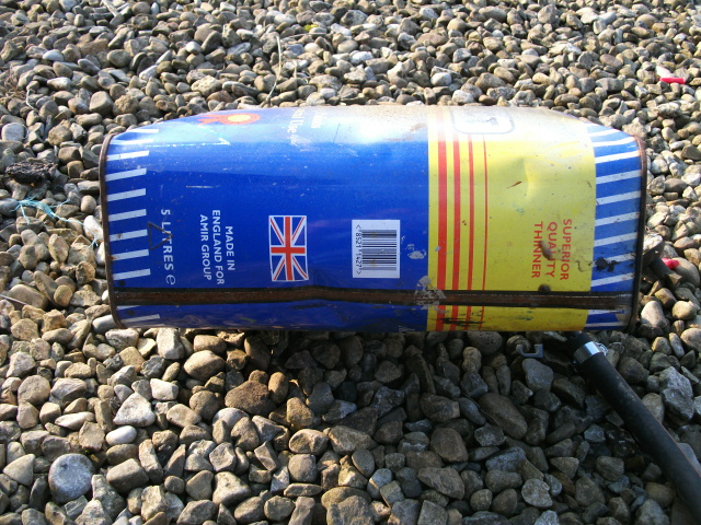

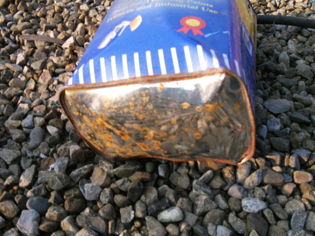

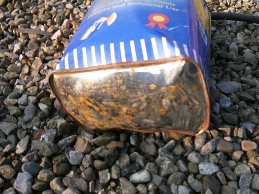

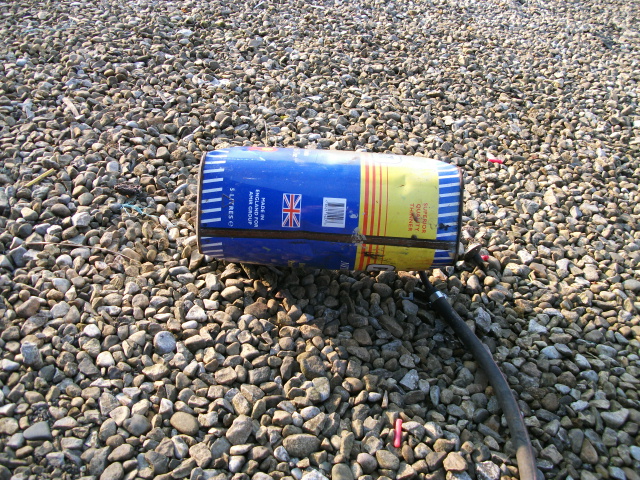

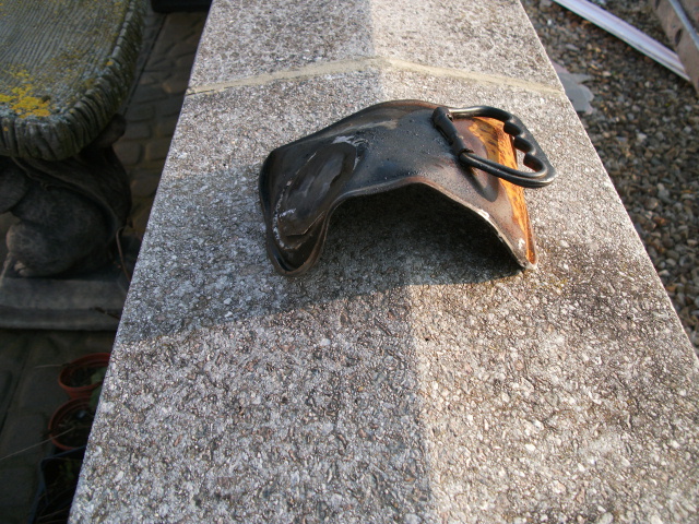

generaly if there rusty on the bottom they may pinhole after years of use an easy way to check for any serious problems is turn it upside down and tap along the base with a hammer .if theres no dents apear the metal will be good and tank should be sound and safe to use .many of the older tanks are a lot thicker than the new ones . heres a test i did out of curiosity to how much presure a 1 gallon can will stand up to. it was pumped up in 10 lb increments till it burst at 50 psi . the only thing that gave was the crimped top
heres the results
needless
to say it was behind a concrete wall when i blew it up
