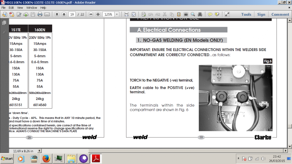

yes- see the front page of the manual,item 14, indicates the black panel below the wire feed housing, figure III on page 4 shows the orientation of the leads for GAS/ NO GAS.
Make sure you snug the fasteners up firmly, if they are loose they will arc.

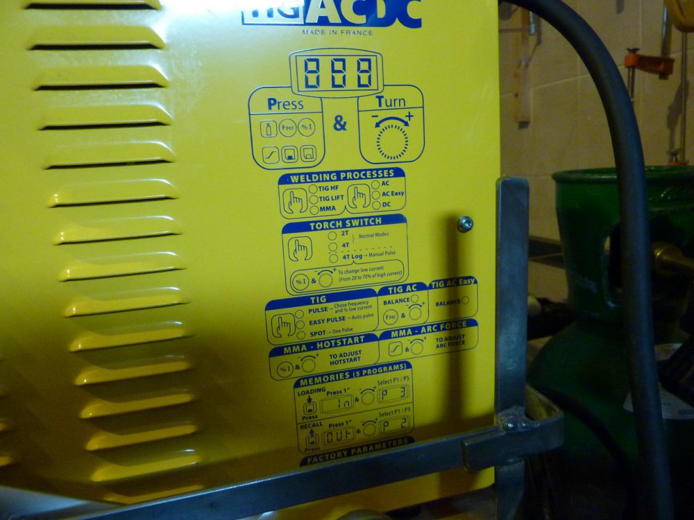

My Smartmig is on site so can't check, but mos GYS machines have information and diagrams printed on the casing,handy feature sometimes when yaint got the manual in yr pocket.

AND, in the case of most GYS kit if you cannot put your hand on the manual-look at the case
