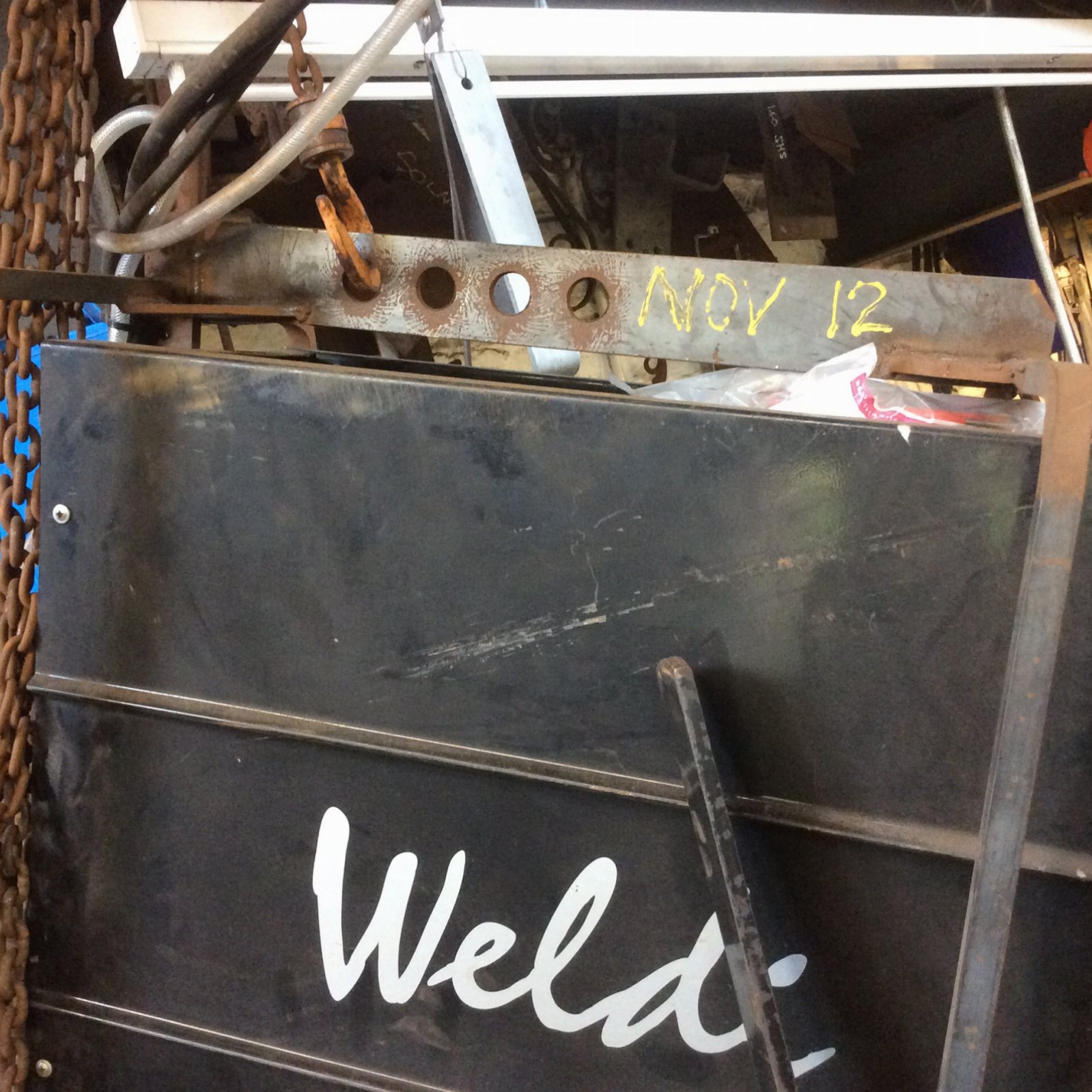

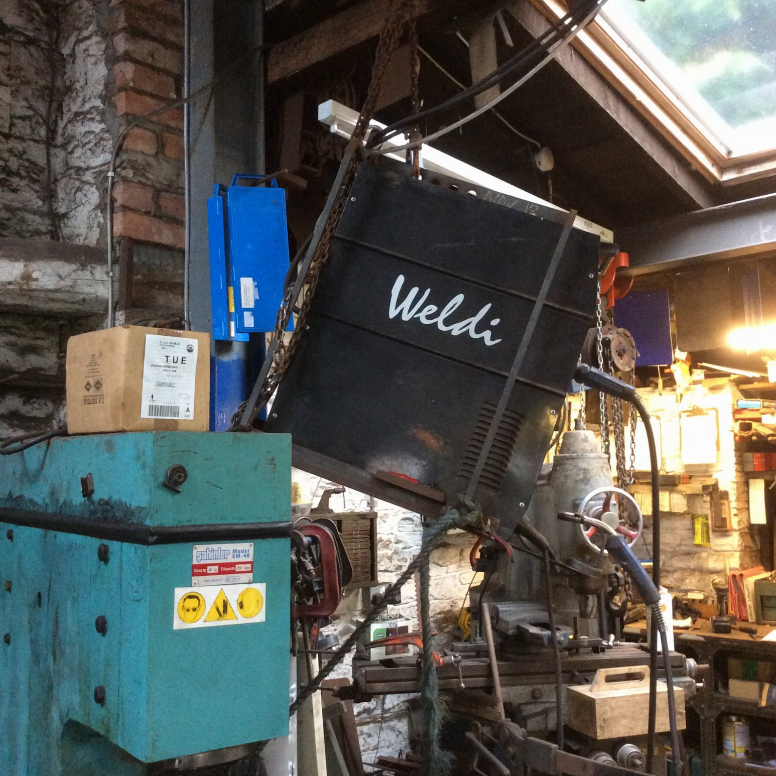

    whilst I'm convalescing from my back op & being slightly bored ,I trying to grasp this technology thing by the balls & post more,
    Many years ago I hung my welder from an overhead runway for better ergonomics & tidiness,it's a boon will do the other one in the big shed eventually,the hoisting cradle just utilises existing holes.

    Hi Nickk, hope you are not in too much pain there with your back.
    Can you post a photo from further away from the actual welder to give some perspective to what you are demonstrating ?

    yes i had clicked 3 times[thinking it didn't work ,then my assistant told me another icon to press,which worked ,will take another photo when back at work monday.in detail to show the suspension carriage.

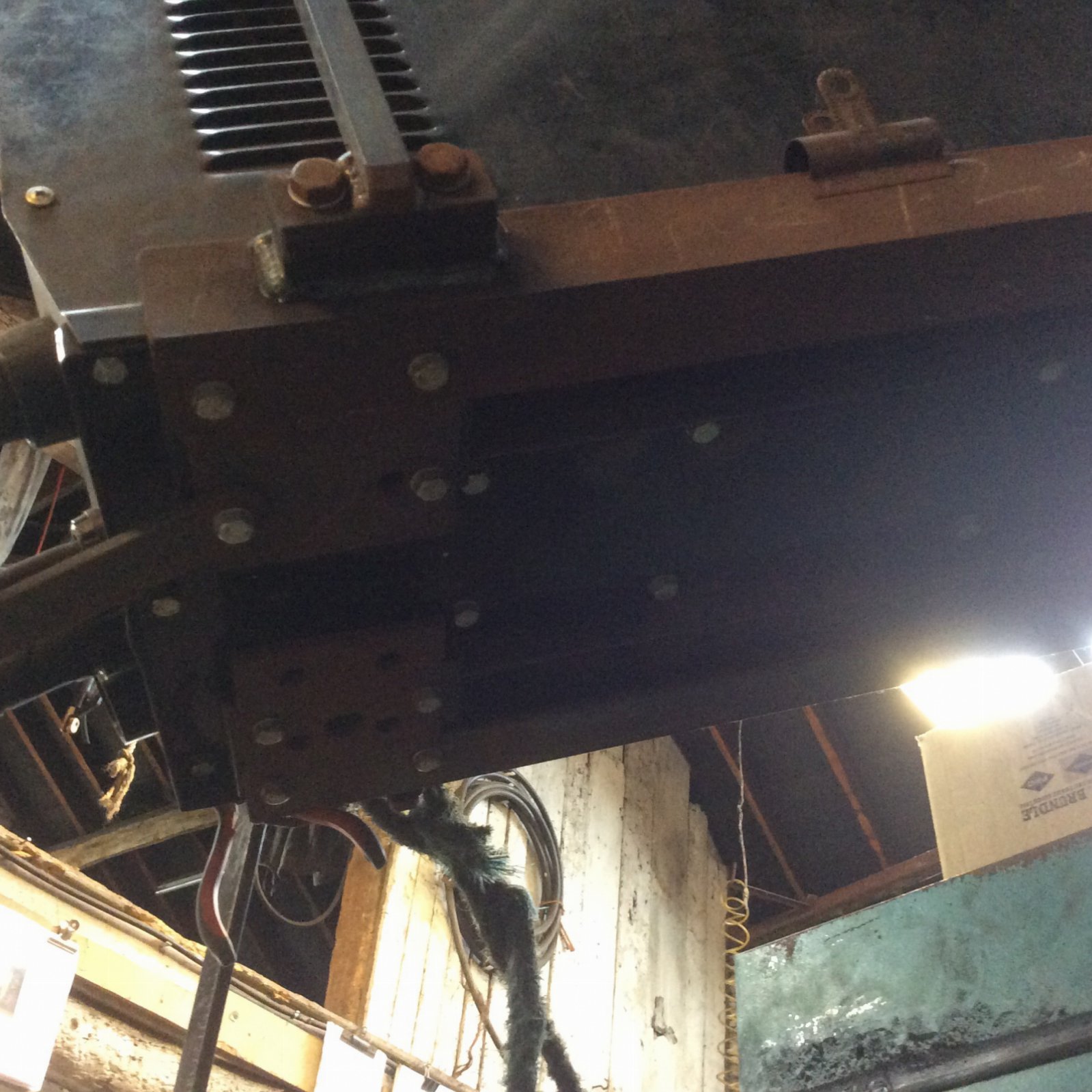

    image.jpg Can't yet work out how to upload more than 1 photo per post!

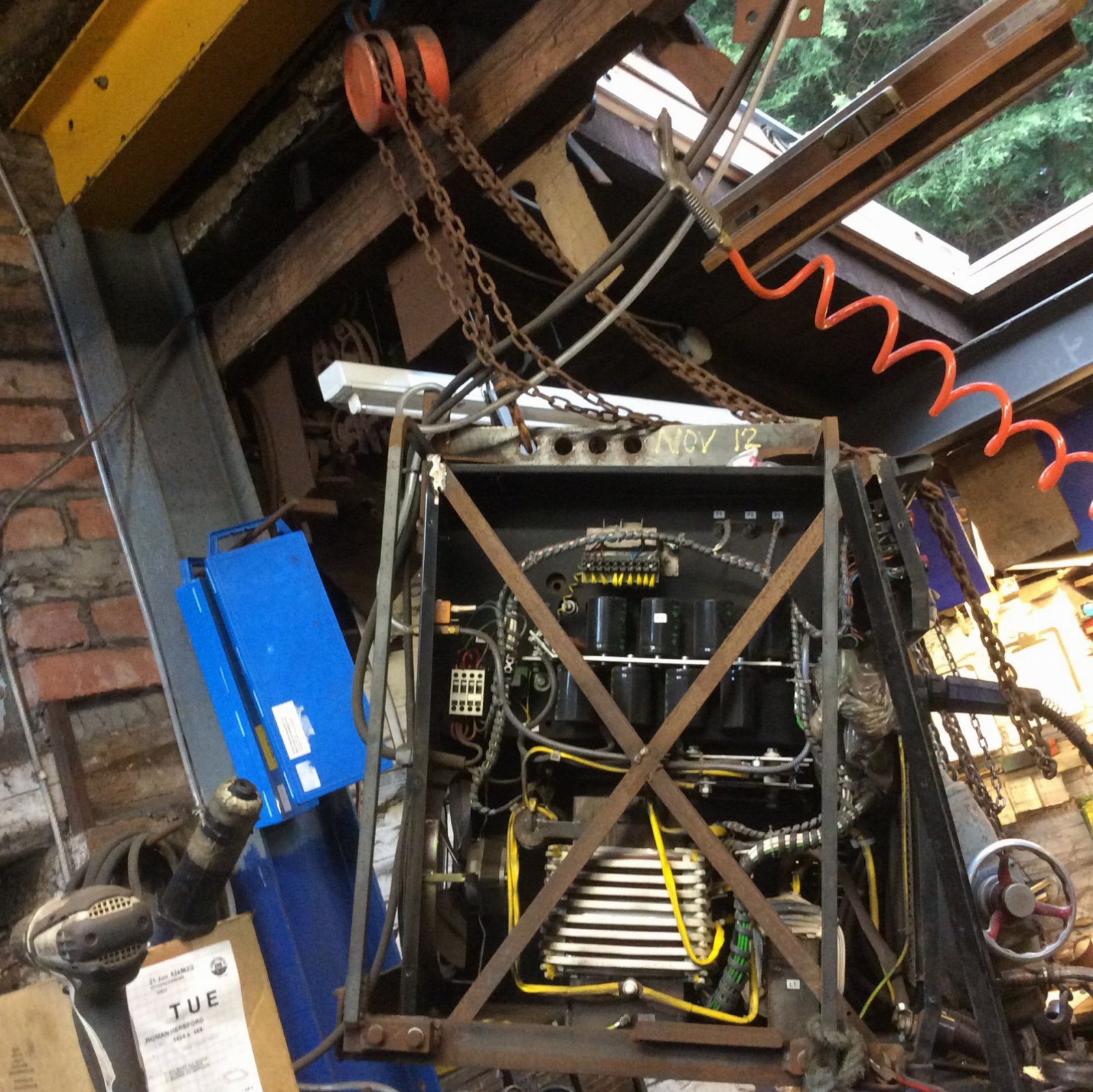

    image.jpg The frame utilises exists bolt holes underneath where the wheels fit.

  14. steve t Member
    Messages:
    459
    Ireland
    is that a sahinler power hammer I spy?
  15. nickk Forum Supporter
    Messages:
    1,545
    powys
    sure is ,the 40kg one.

  16. dannyp Member
    remote wire feeds make doing the suspened welder trick much easyer :)
    that boom i think is 7.5 mtrs made from 50x50x3 box top and bottom rail, uprights and diagonals are 40x40x3

  18. Jim Davey
    Jim Davey RH Davey Welding Supplies
    Messages:
    5,013
    Location:
    Southampton
    Well done for suspending your welder. I wish more fab shops would adopt this approach, it saves the set and cables from so much damage, gets them further away from the grinding dust and frees up valuable floor space while removing cables as a trip hazard. Why more steel shops don't do it I'll never know.

  20. Jim Davey
    Messages:
    5,013
    Location:
    Southampton
    It's not a lot of weight if you just suspend the feeder, which is what most shops do. Suspending a compact welder makes less sense but it's what the guy had so it's what he did.
