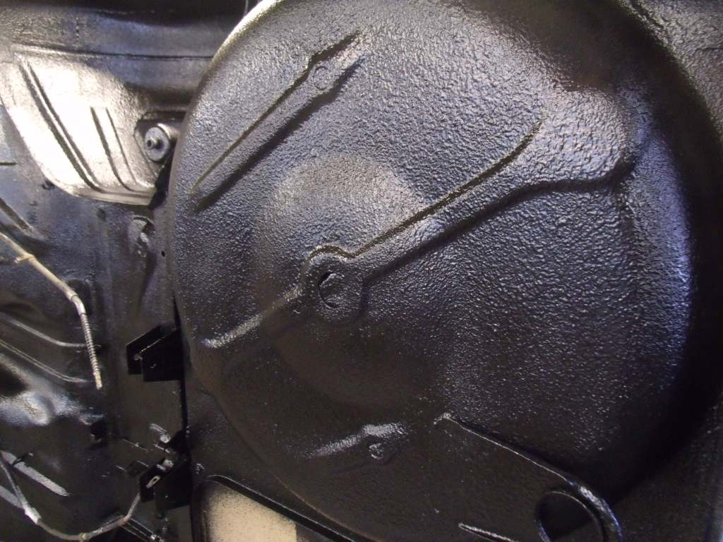

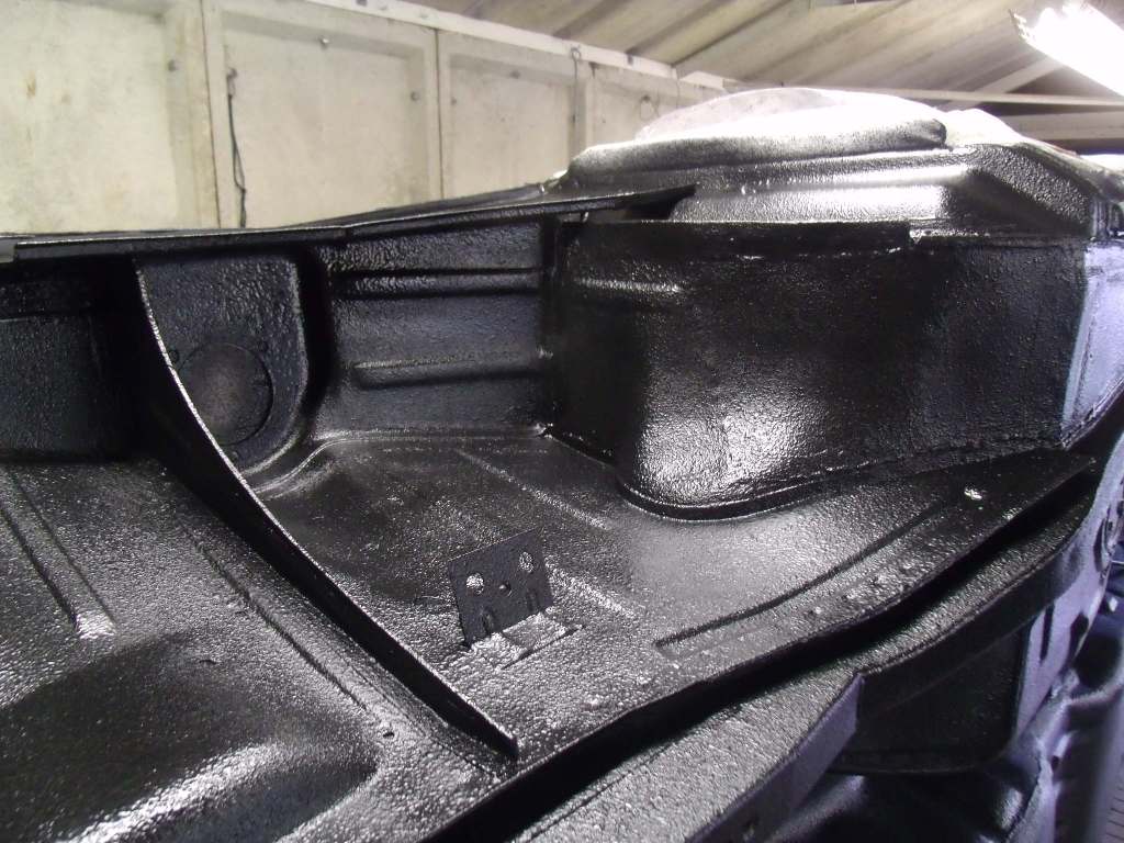

I've used Raptor on one of my projects. I used it over some epoxy primer, with just a surface key. I can't see why it would be any different going over paint. I would use a coarse paper, since Raptor is textured you wont notice the scratches and you should get better adhesion.
