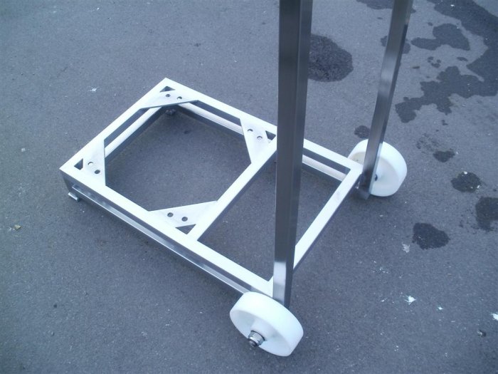

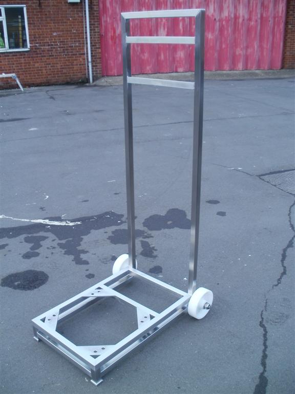

Finished this one off today, its a trolley / stand for a scale used in the packing of cooked meat products, a bag stand sits on the scale and is fed by a conveyor. All stainless steel as usual.
The 2 sets of holes are to allow for 2 different types of scales to be used, they just locate on studs in the base.

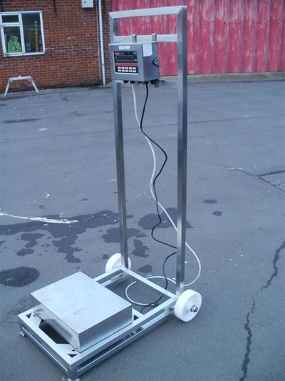

And with the scale fitted
