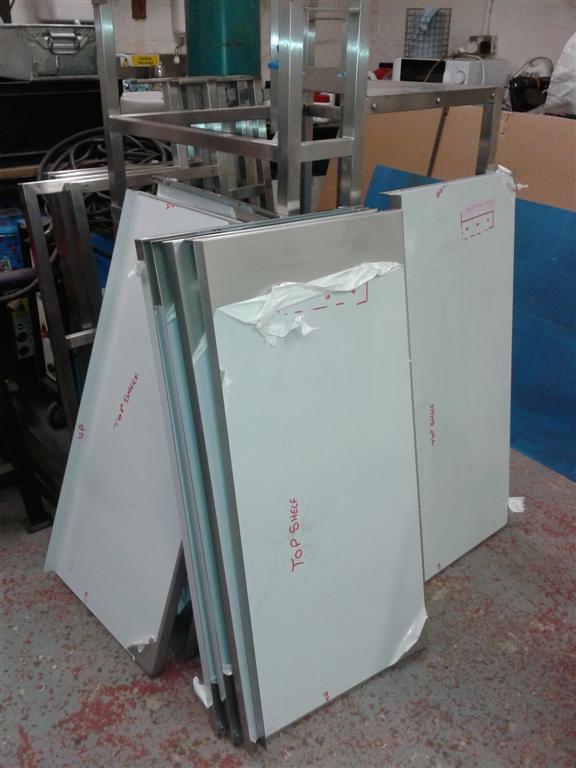

Been making some metalwork for a new bar in a club, its a very simple structure just frames and screw in shelves, a bit like Dexian,
The frames are all the same, so make one up and use it as a jig to build the rest on,
The bar is "L" shaped 6 metres x 2.5metres so two of the frames are fabbed up into a corner unit, this will be the cornerstone of the structure, the bits screwed on the side are just mock ups of the shelves, just to prove the bending before carving up four hundred and fifty pounds worth of sheet
Frames and corner built, and fitted with rivetnuts. the space behind the shelves is for the services, pipes etc
Some of the shelving, all bent from 1.5mm stainless
A bit of pre assembly, this section has a narrow shelf underneath to accomodate a cooler at the back

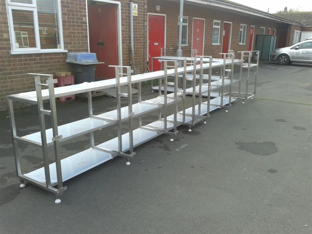

Then move it outside to do a trial assembly and get the customer to come and approve it

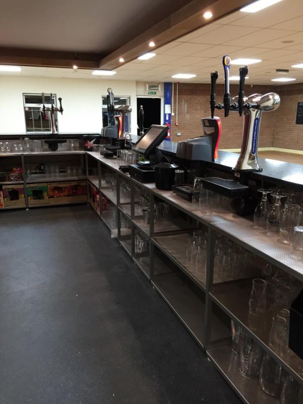

When its finished it will be fitted with a black granite top and oak faced panelling to the front, thats being done by someone else in a couple of weeks time, I'll try to get a picture when its finished
