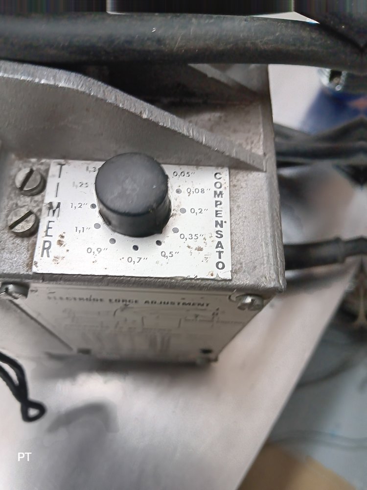

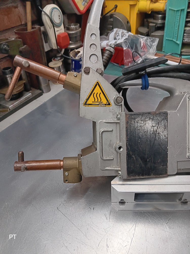

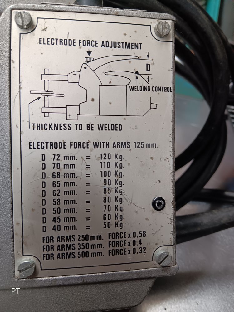

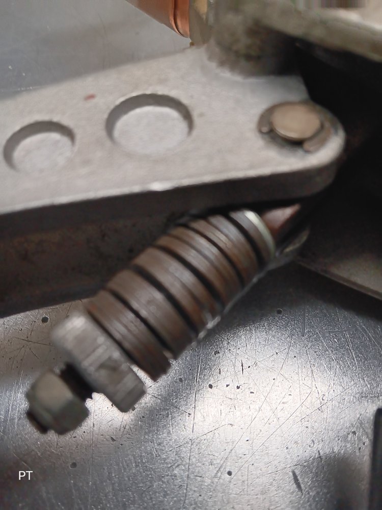

Hi all. I wonder if someone could help.
I have a Spotmatic M2 spot welder, and the clamping force adjustment spring is missing. I can't find one, so in order to source one from a spring supplier, I need to know a few details, namely:- the spring free length, the internal diameter and importantly the springs wire diameter, so that I can find one with the correct rate. If anyone out there has one of these machines I would be extremely grateful if you could measure the spring for me.
Thanks.
