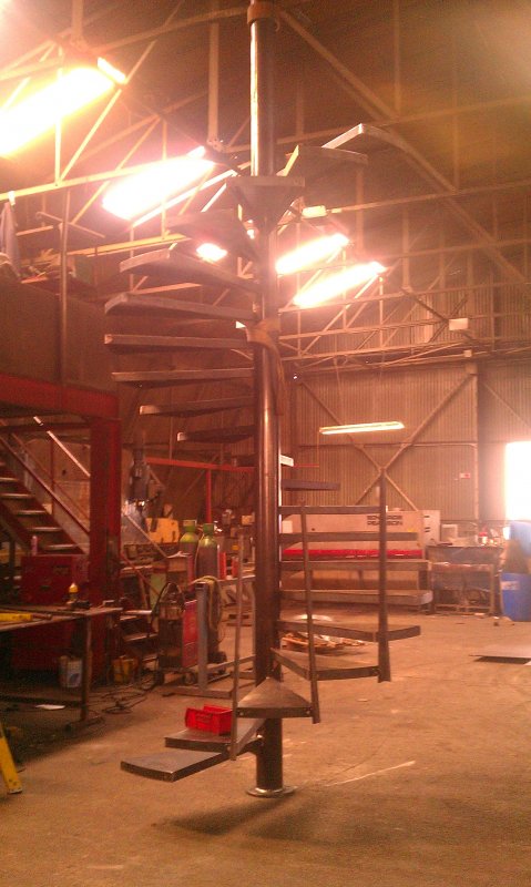

Not made one like this for sometime. Nothing spectacular.

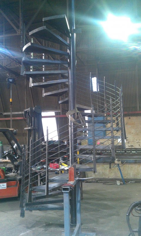

All welded up, none of this adjustable tread stuff. Handrails fit on after.

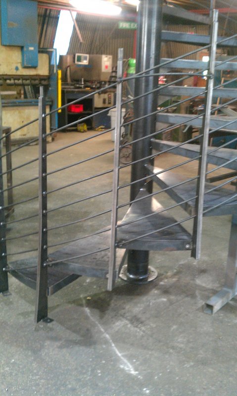

Last section of rail to fit at the top. The shape of the posts makes them look as if they are leaning, keep checking them.
Joints, the rods are supposed to slip into stopped holes in the posts. Temporarily spragged to hold it in place. Enough movement in the finished panels to allow the joint to separate. Some site welds required i'd think.

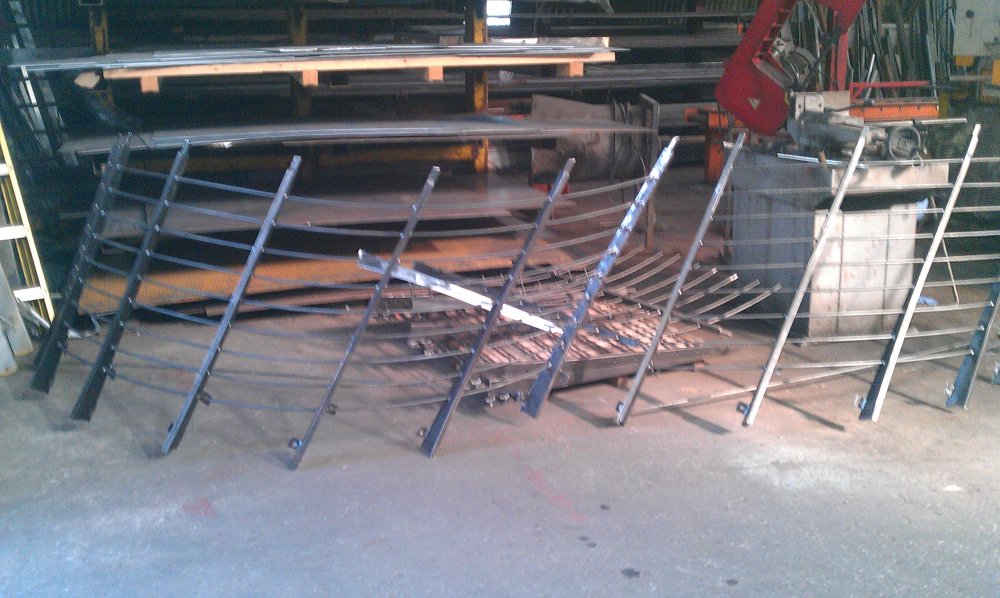

Some kind of floppy whale rib cage.... Or the handrails. Temporary ties across the bottom to help keep their shape.
