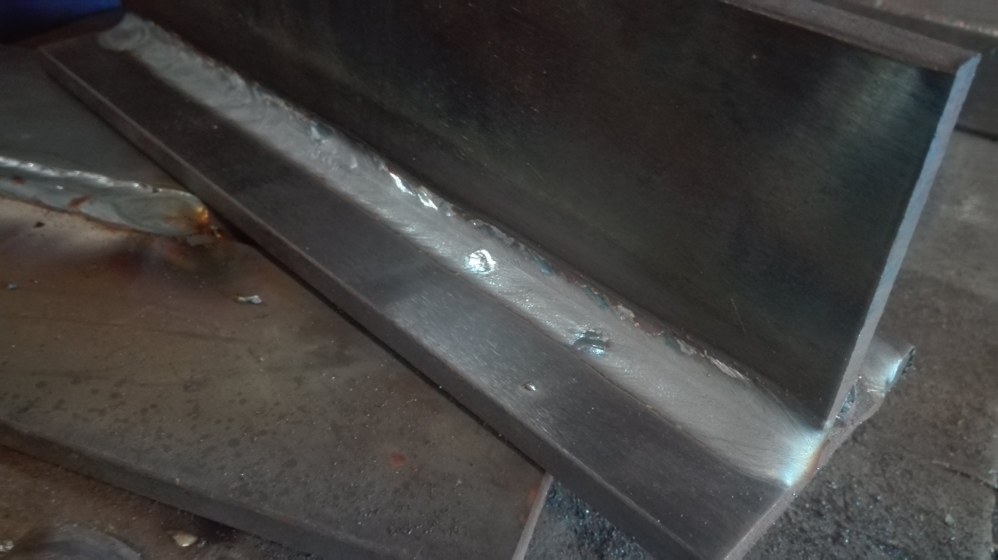

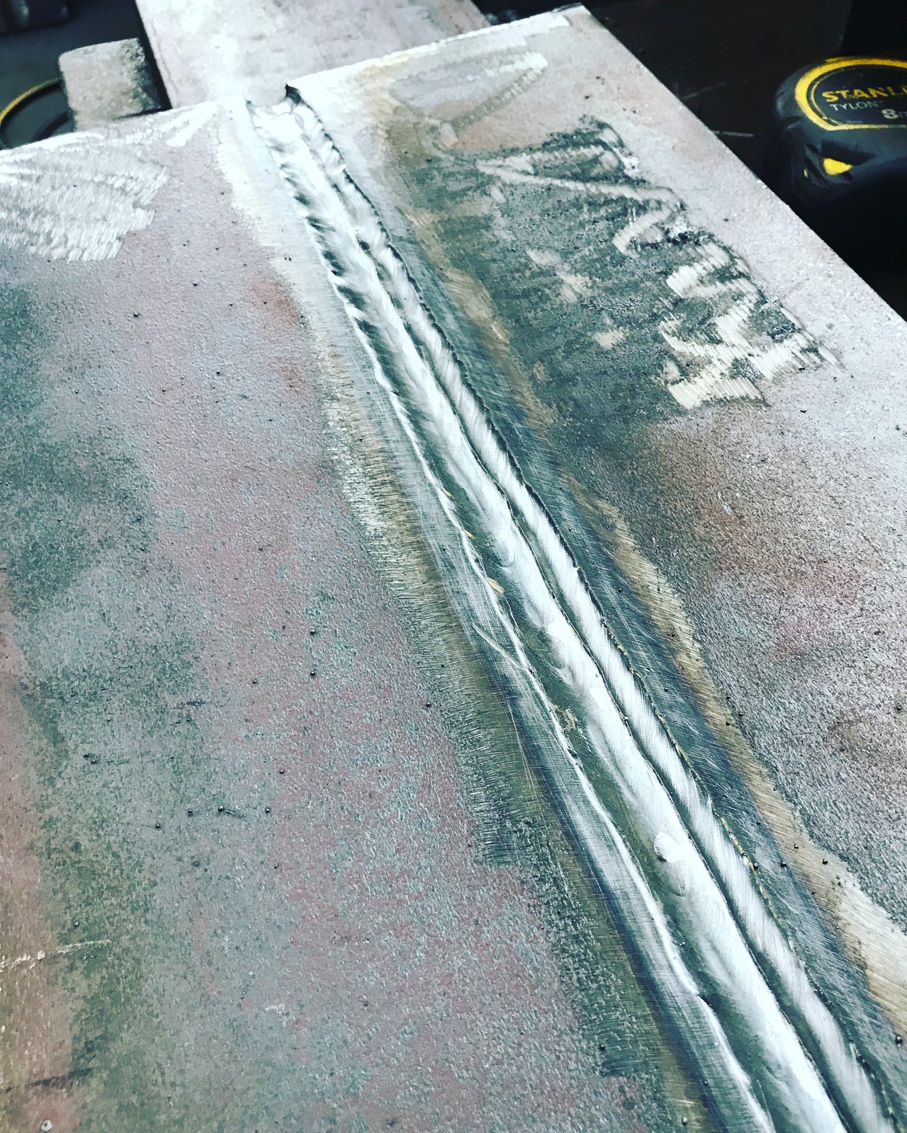

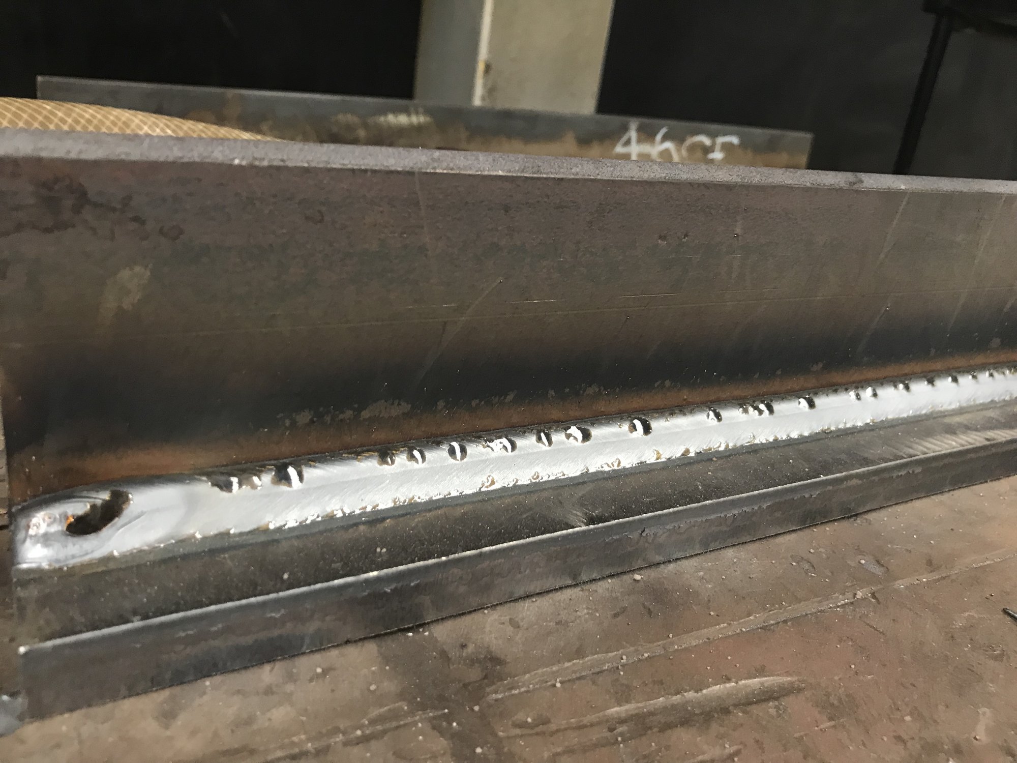

I thought some of these images would be of interest to members:
Photo 1: 15mm V-Butt S275 1.2mm G3Si1 - Two Cap Runs Not Suitable - Lots of undercut/lack of fill.

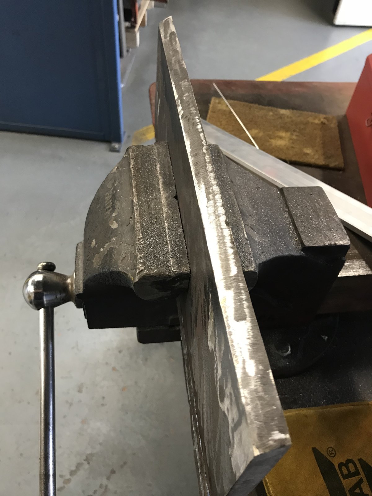

Photo 2: Trying to get a nice 8mm Leg Length fillet weld with Metal Cored Wire

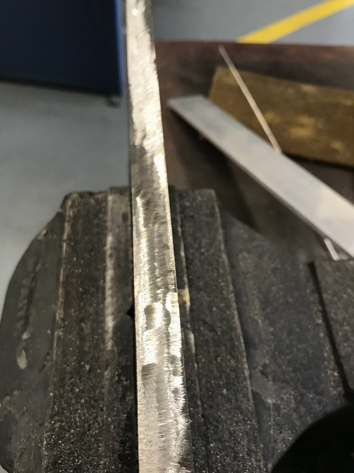

Photo 3: Coreweld 46LS

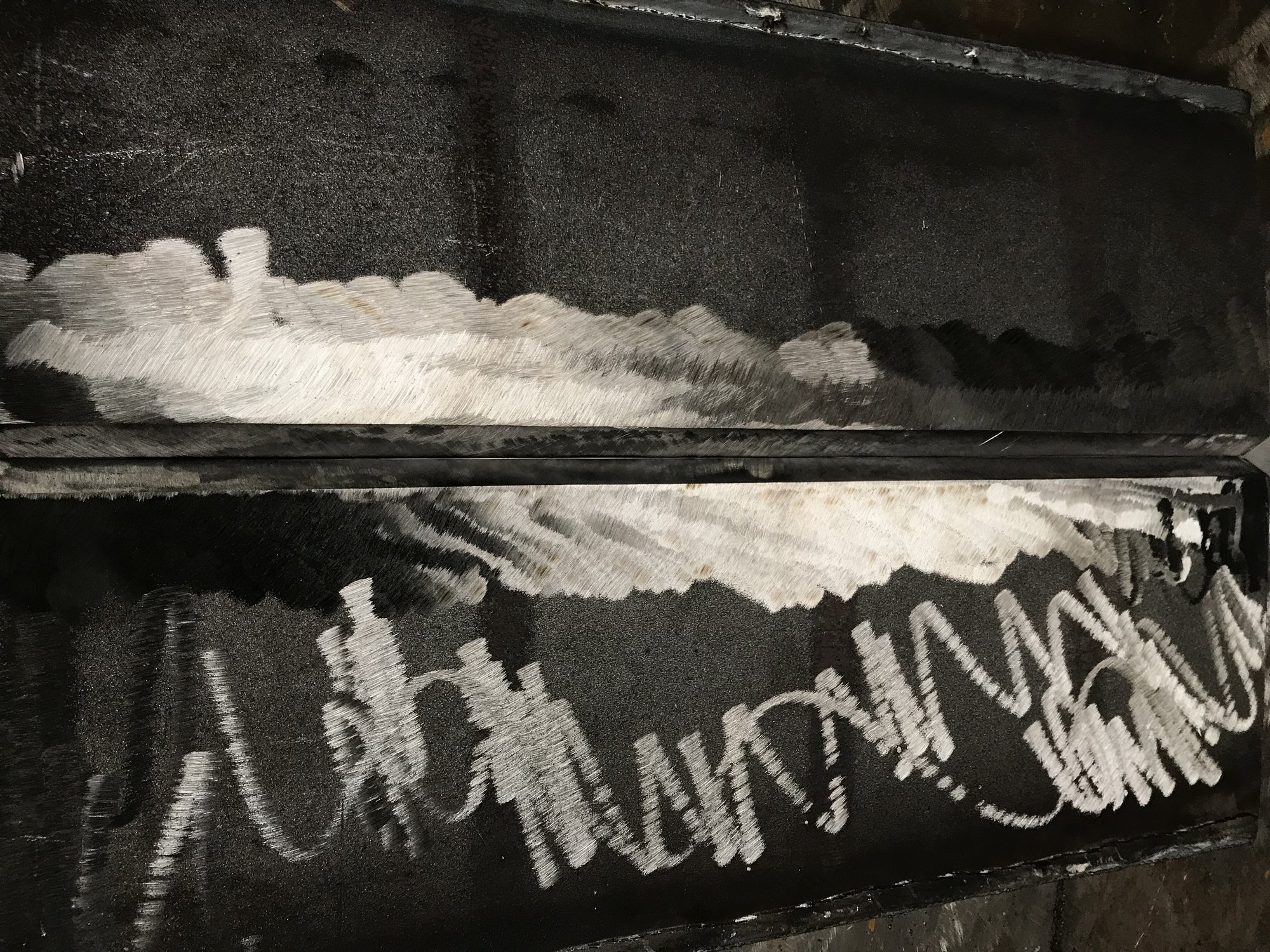

Photo 4: Etch of 8mm Leg Fillet
