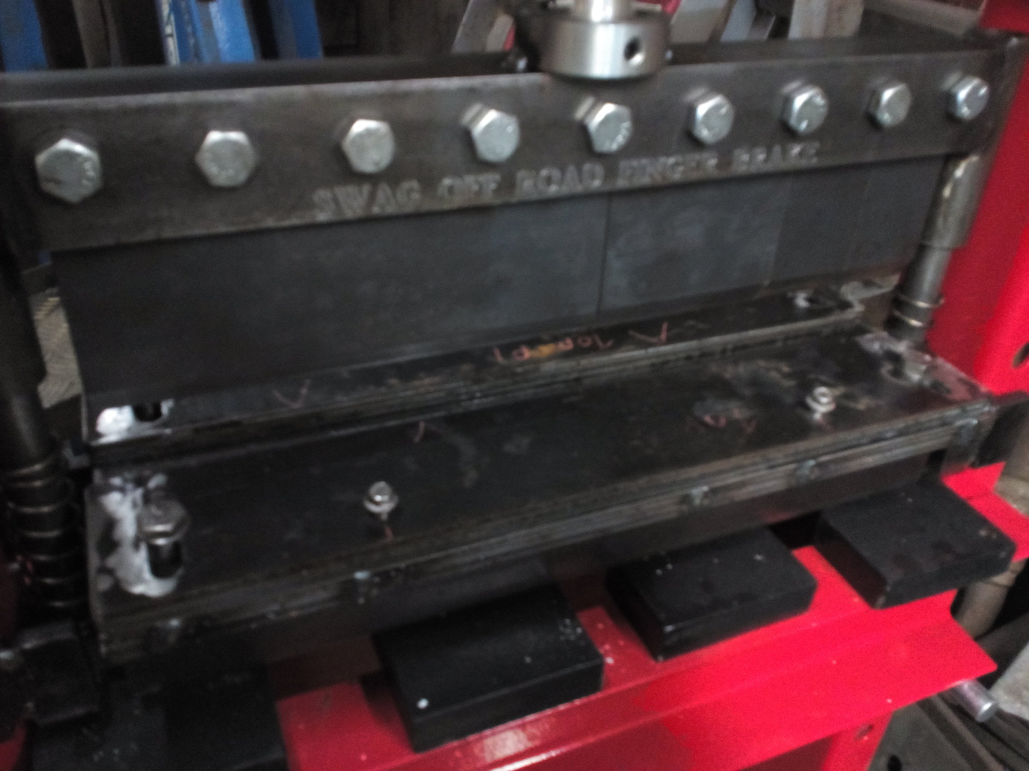

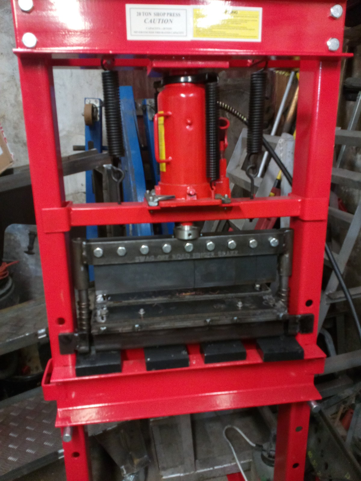

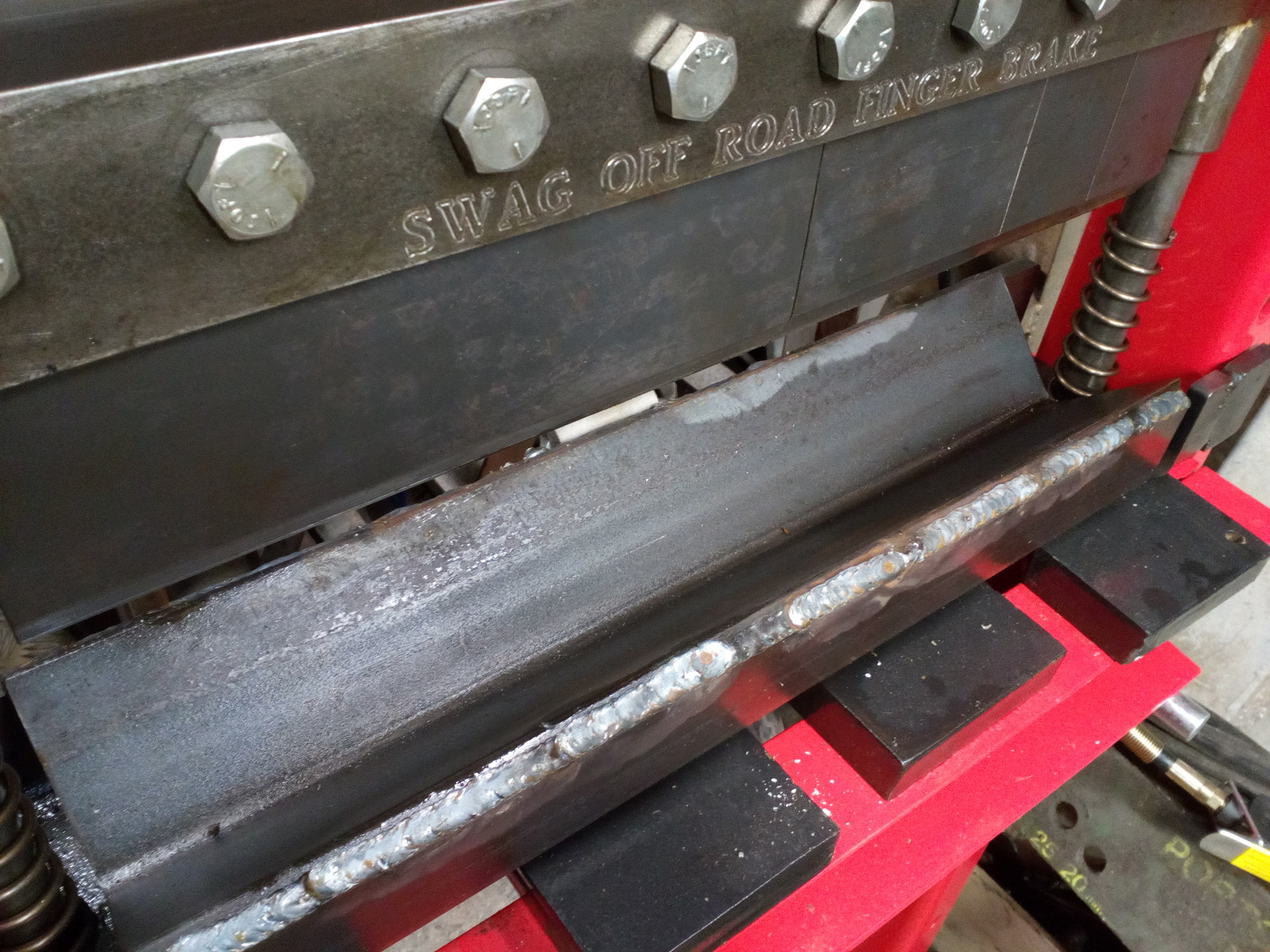

After a lot of deliberation I have splashed out on swag finger folder I have put it together in my free time over the last couple of days and today finished making the adjustable removable botom plate to get tighter bends and use on thinner metals

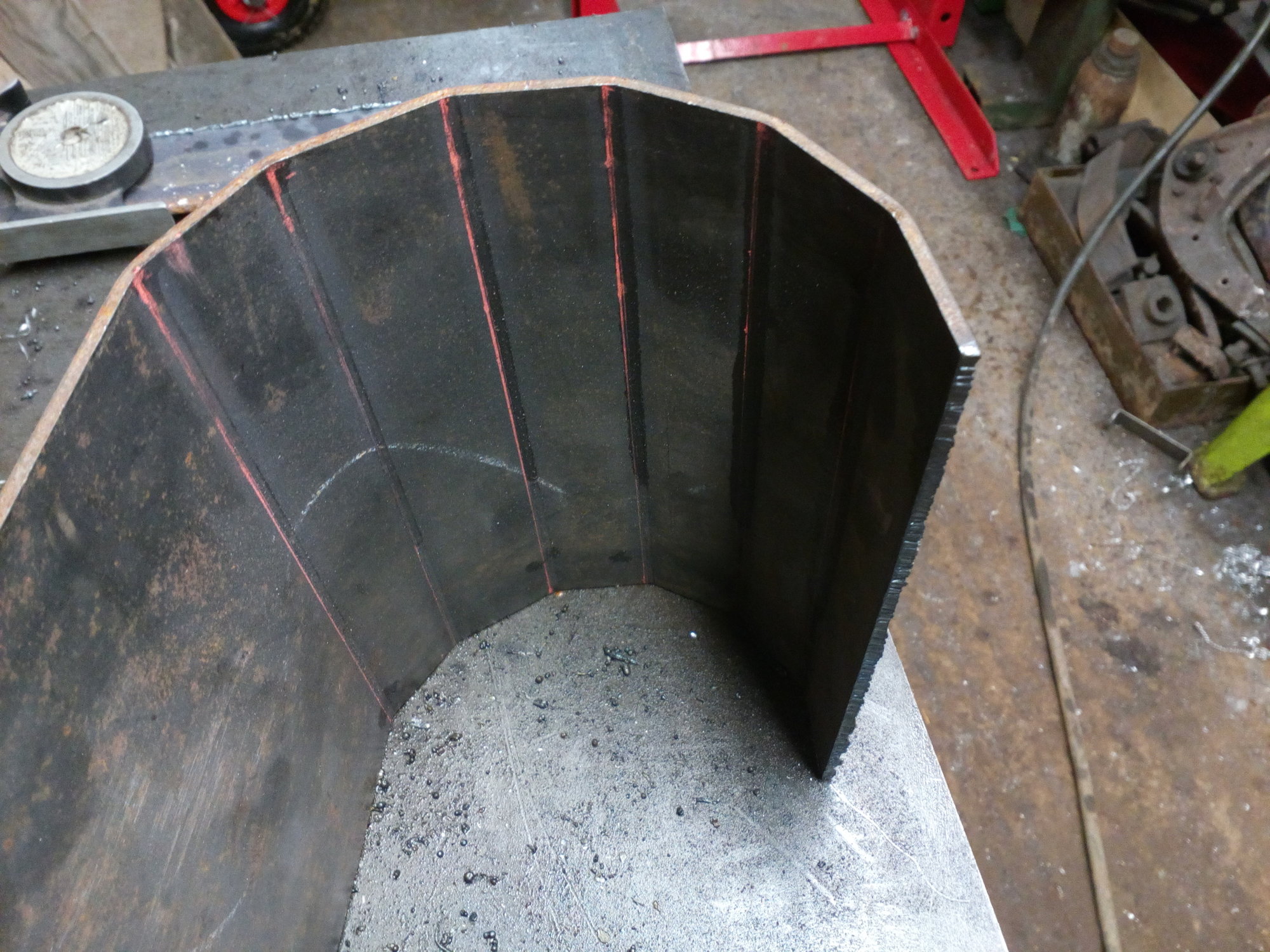

Gaz1 I have a very good idea without reading as I spent a lot of time at what was our local blacksmiths years ago and know the lad who did most of the folding work at that time ☺im glad that youve posted that up as it does do a nice fit
also the half round proves it can be done and I see that youve been reading
to get a better round do another inbetween those but less fold in on the folds
Yes it is and the press has had a air over oil jack fitted so there is no need to pump the Handel I would of loved a bigger one but couldn't justify itIs that the 20ton 19" version?

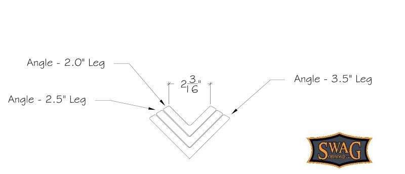

Yes by fitting extra pieces of angle stacked on top of each other in decreasing sizes to narrow the v or by adding a flat top plate with adjustable strips on for thinner materials and a even tighter bend
