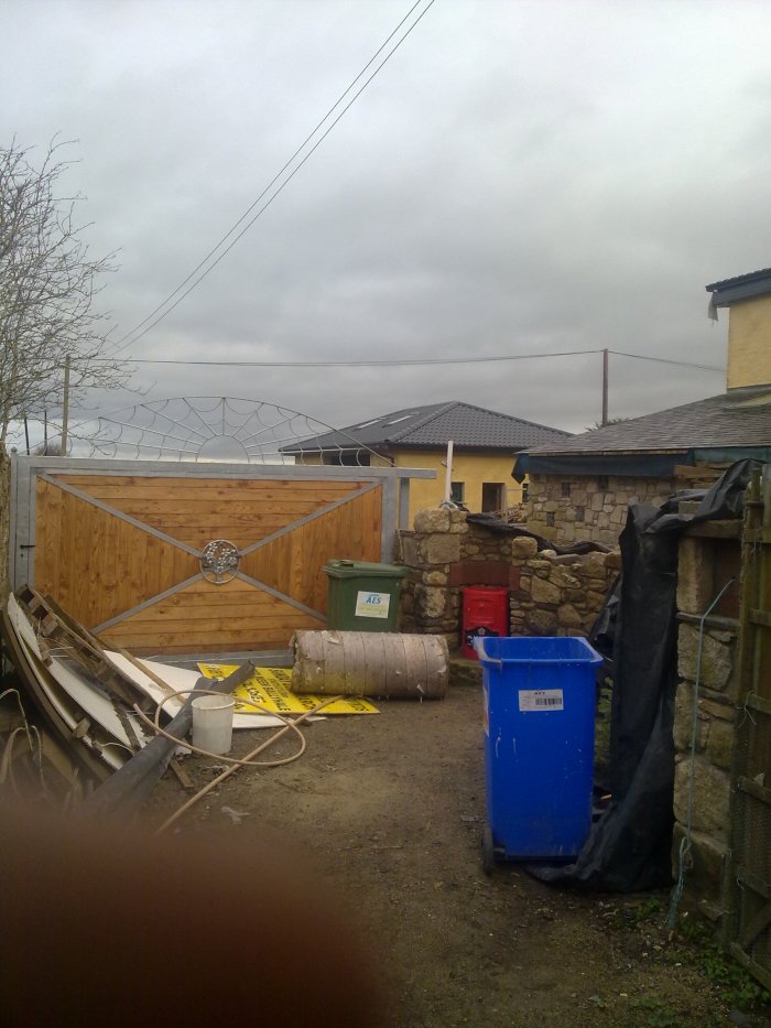

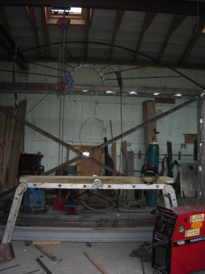

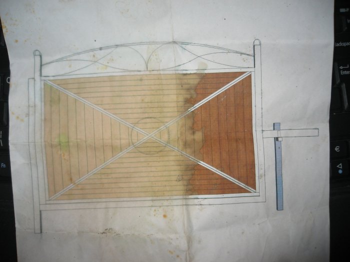

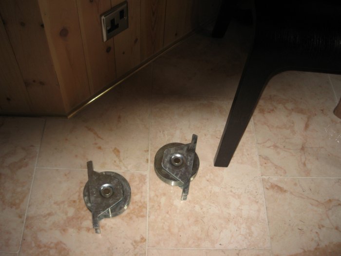

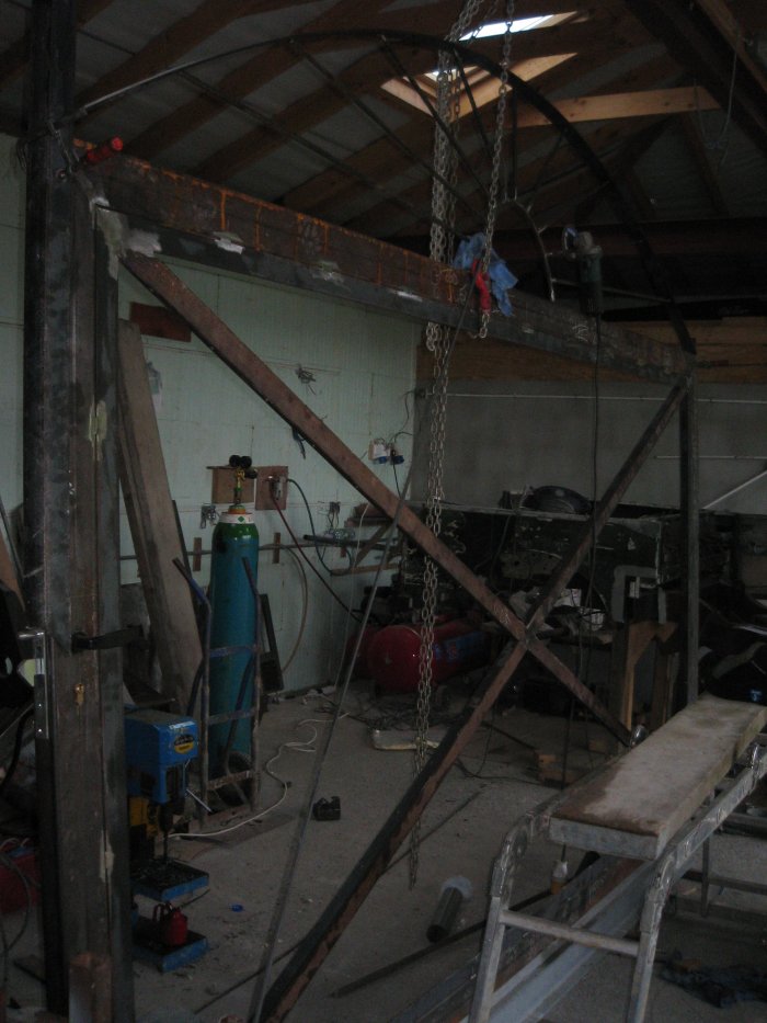

Got to make up a sliding gate for my house. Ive got the rollers and track ( v track ) . Steel framed with timber clamped in the T section by small angle. Ill put some decorative panel in the middle and some sort of nice design up top too. I was thinking about 100x50 for the frame and 50 mm angle around the edge, the diagonals 50mm T and 25 mm angle bolted to the the diagonal T to hold the timber. A bit of flat around the back that run through guide rollers.I looking into what locks are suitable, any ideas??. What way do i fasten the rollers and lock as i want it galvanized how much should i oversize holes.
