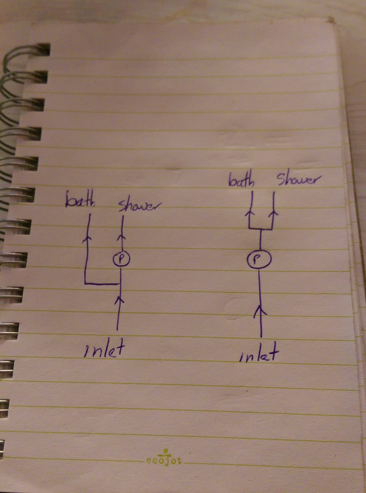

Help and advice needed again! This time it's on a shower pump.
I'm fitting a 2 bar twin outlet pump to the bathroom so that SWMBO can have a decent shower. It's a temporary setup until the whole room is redone.
I'm going to cut into the pipes and run short flexes to the pump, here's two drawings of what I could do.
I don't necessarily need the bath to be pumped so the drawing on the left would be easier to plumb but if it's done this way would turning on the bath taps set the pump off?
Thanks chaps.
