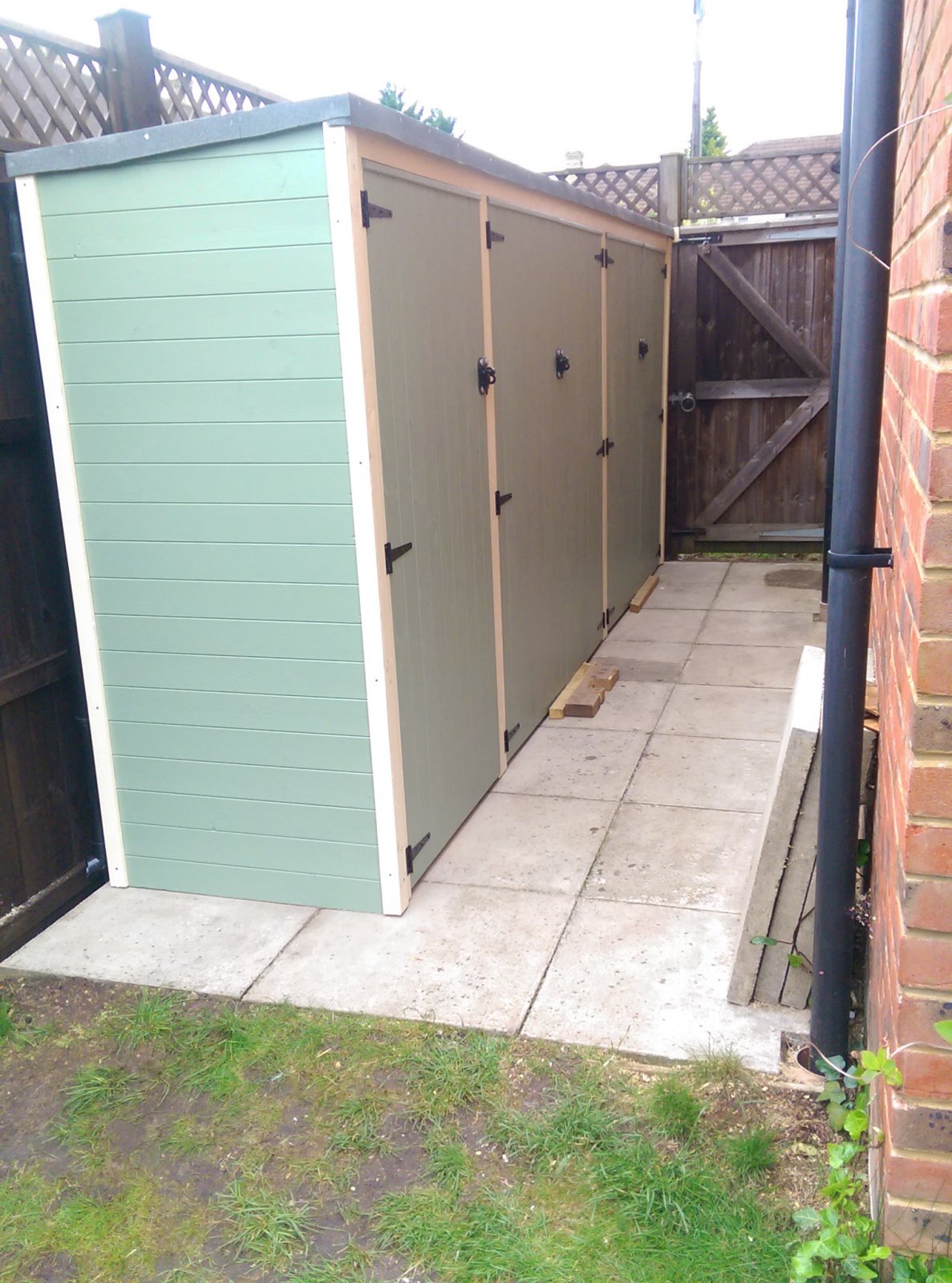

Here's a few pics and a brief description of what I've made.
I needed some more storage space as the old shed was rotten but only had a narrow walkway to build it in.

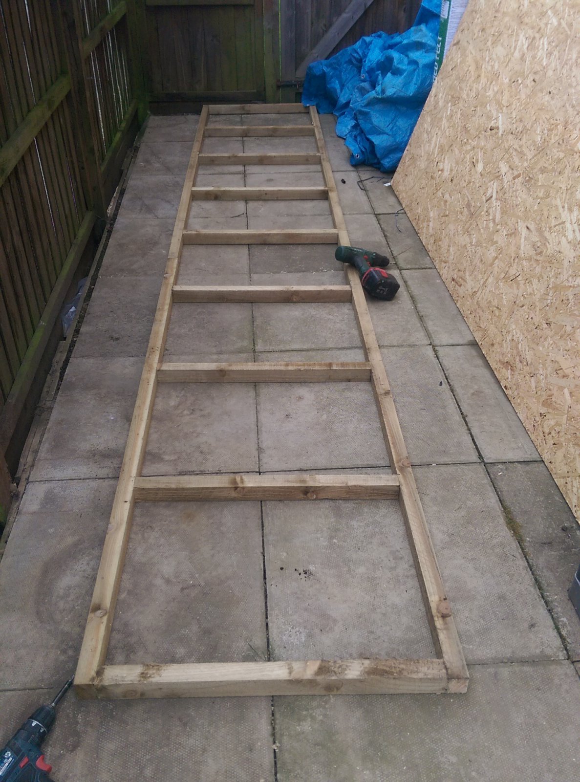

So I knocked up a base.

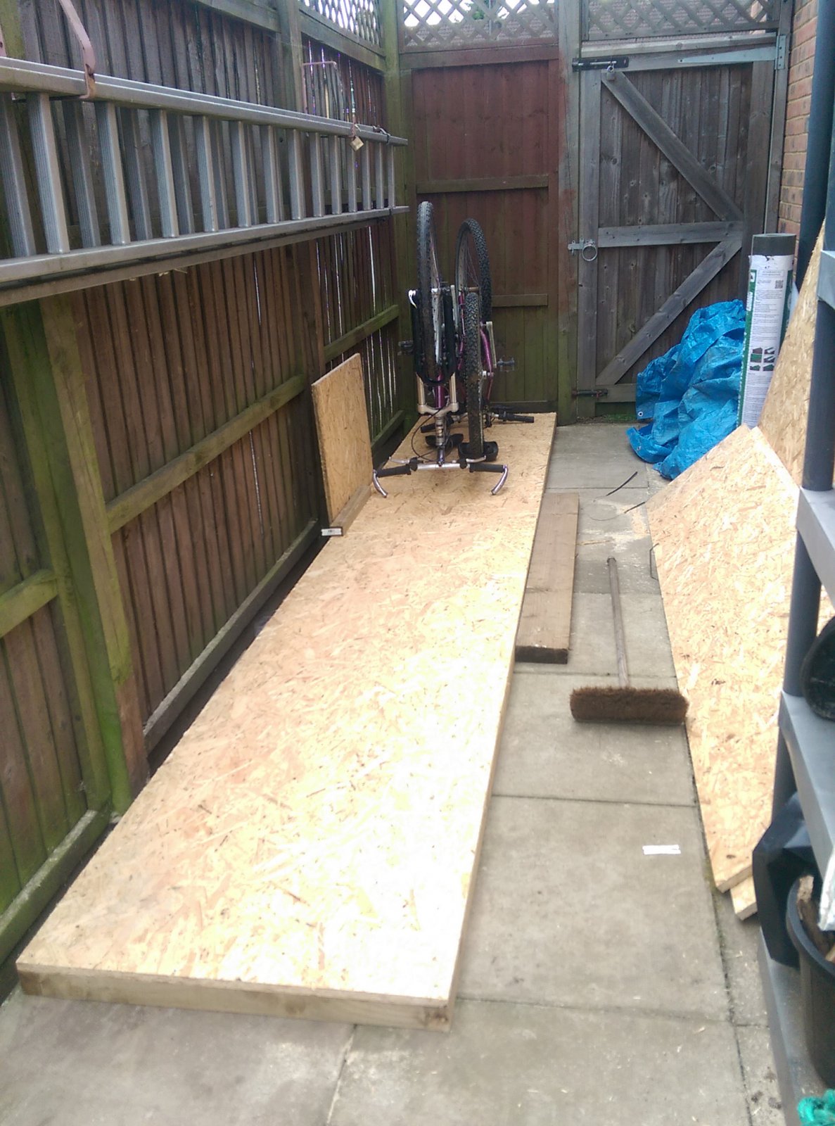

Then laid a floor on it using 18mm osb 3 sheet.

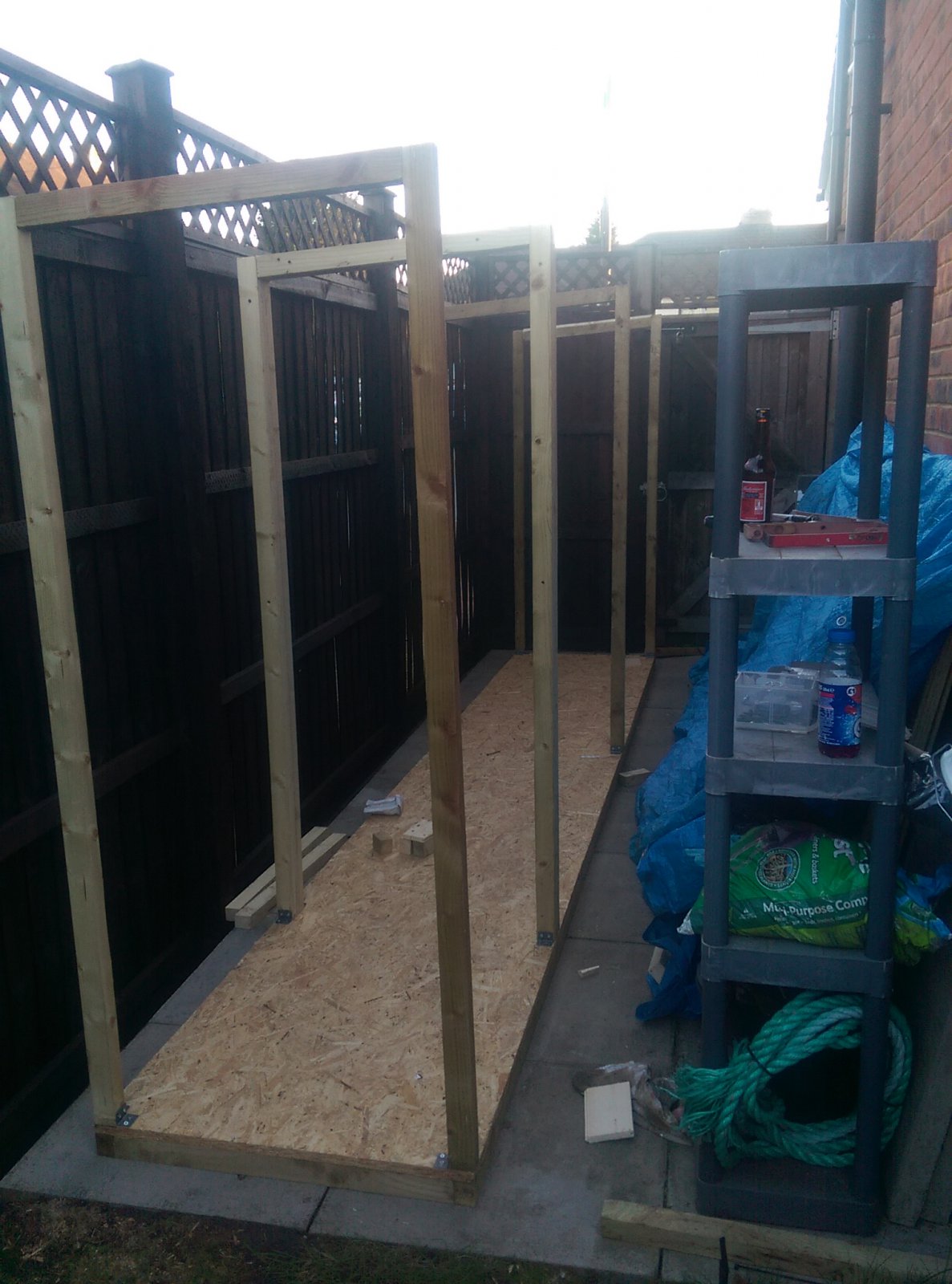

Then built a frame out of 37mm X 47mm pressure treated battern.

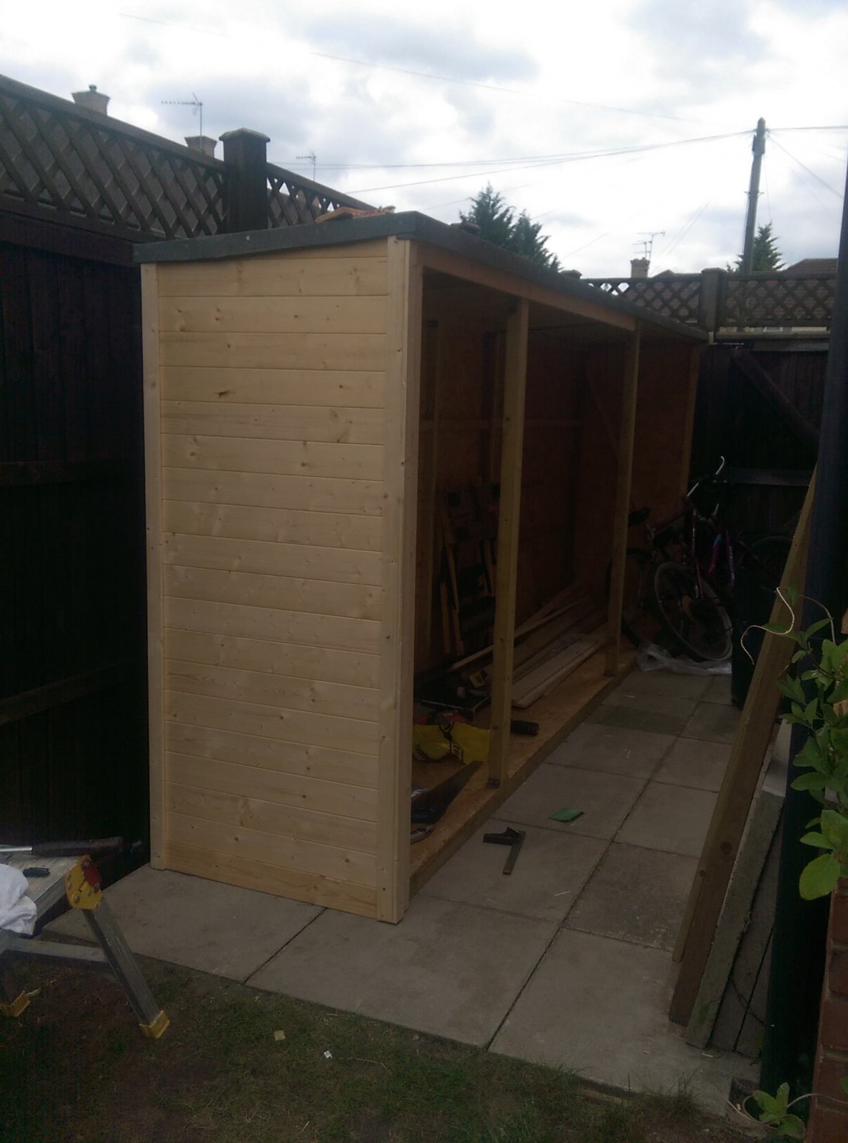

Then clad it with some of Wickes finest pine timber...... quite a bit went back as it is poor quality stuff.
Felt for the roof.

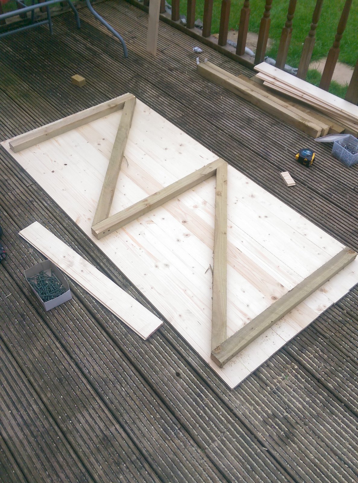

Next the doors.
These were a bit of a pain in the **** as I've never made doors before!
Eventually 5 were made.
Then start bolting it together, bit of paint and door furniture.
Job done!
