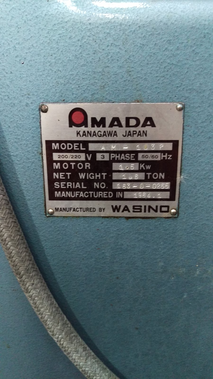

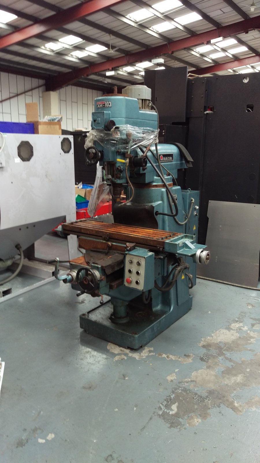

u need a 240v 3 phase converter to run it. a bit unusual having it in a factory that probably has 415 volt 3 phase
rite that answers that oneNot really, seen a few bits of kit (Japanese & American) needing 220V 3Ph supply, normally fit a 415/220V step down transformer to run them.

Just run it with a single phase to 3 phase inverter; 1.5 kW won't break the bank.
