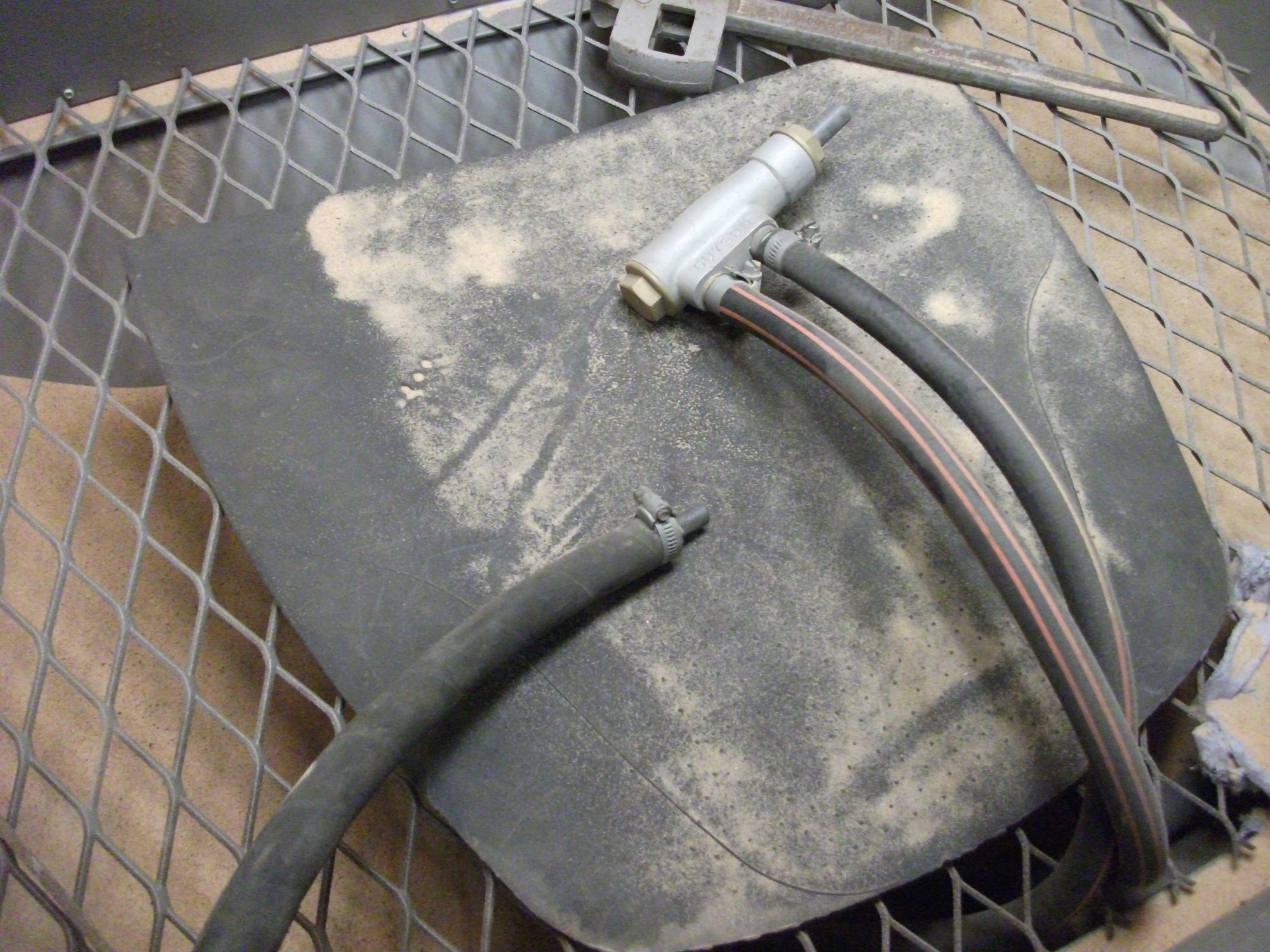

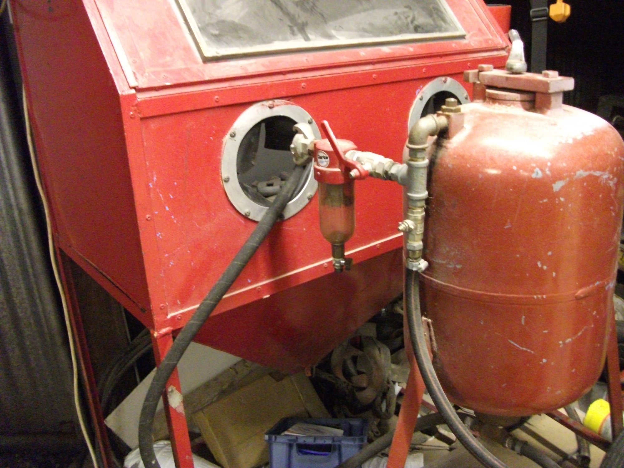

its only the blast hose that needs to be decent quality. 8 foot is about rite. its preferable to run 10mm bore pipe to feed the pot . any smaller and u loose cfm and pressureBit bloody tech this sandblasting lark init.
Bit off topic if you dont mind be butting in please
I am looking at the blast pots and they come with 8 foot on rubber line. Does it need to be that long ?
If the line is longer will it affect the performance?
Is it special hose then also ?
Just tempted to buy one of the cheap new blast pots of ebay.
