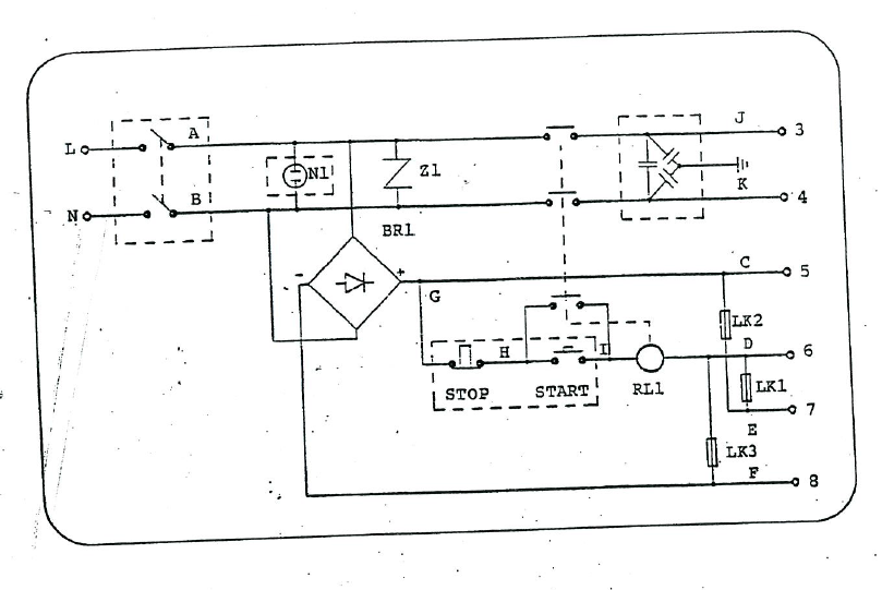

Have done loads over the years some of the controls boards almost look home made.
But basically they are all the same, some have capacitors after the rectifier as well.
Often the screw terminals slowly loosen then get hot and go high resistance.
I was hoping I'd find loose terminals on the connector blocks, but unfortunately they were all sound

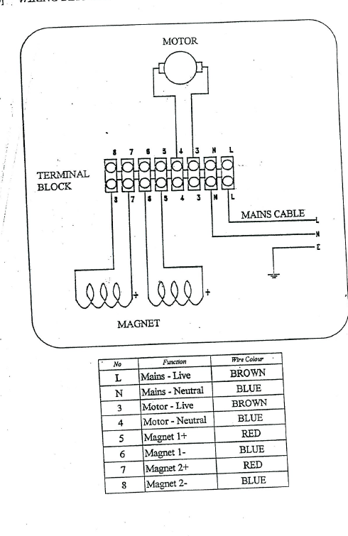

Just surfing for a 100V DC relay now. Need a Triple pole one, as it also forms the NVR system. I guess I could get away with just switching one of the motor supply wires with a DP one, but I'd like to keep it as standard as possible.
