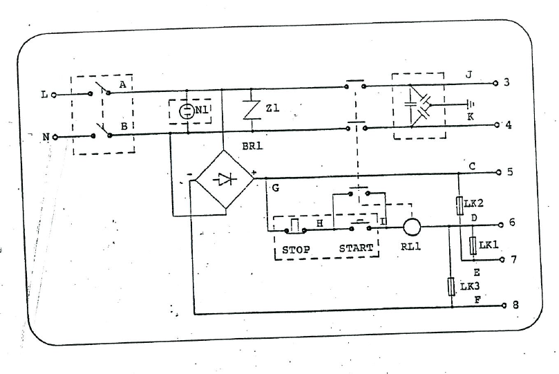

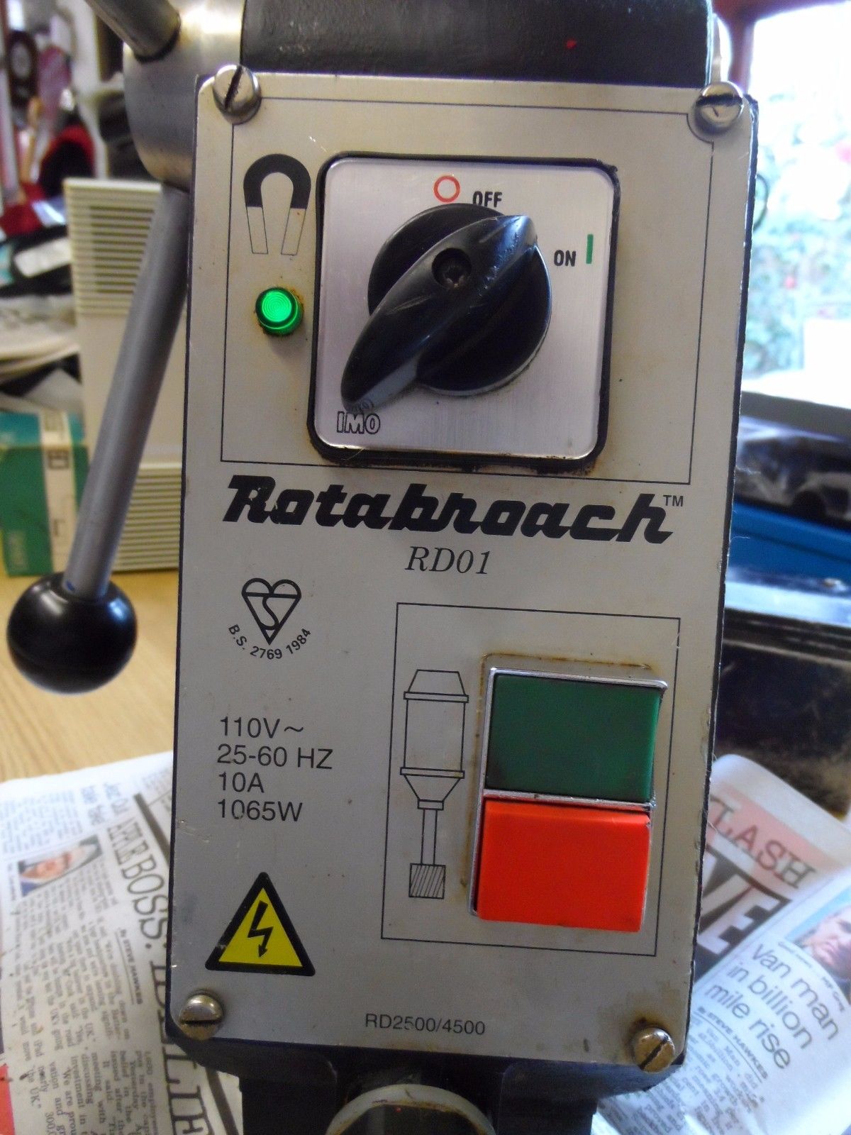

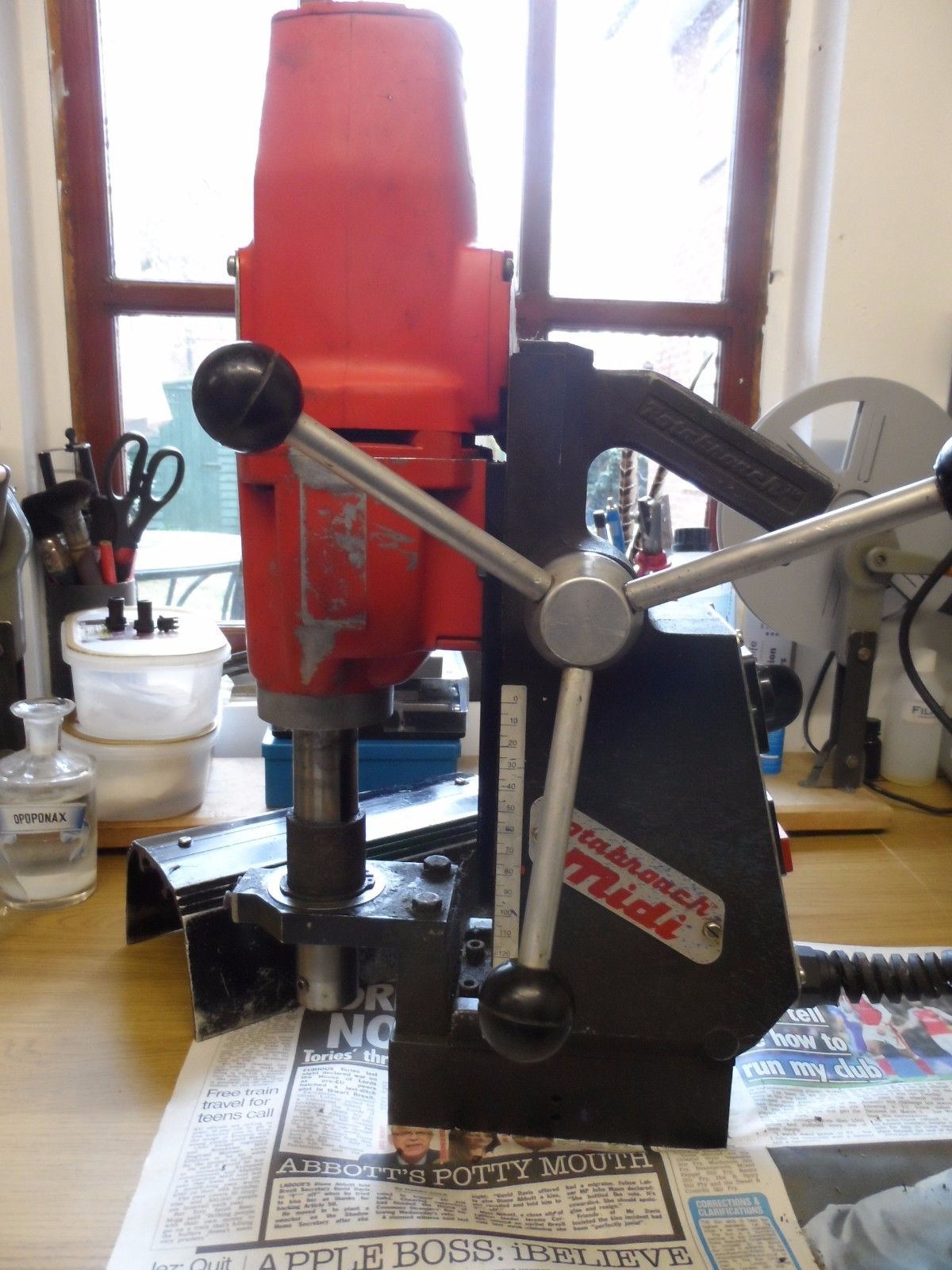

I picked up a non working Rotabroach Midi the other day, model RD01. Fairly old I should think, and well used but in pretty good condition. Accordingly to the data plate, it has a 1020W motor, and a max cutter dia of 52mm, so a reasonably powerful machine.

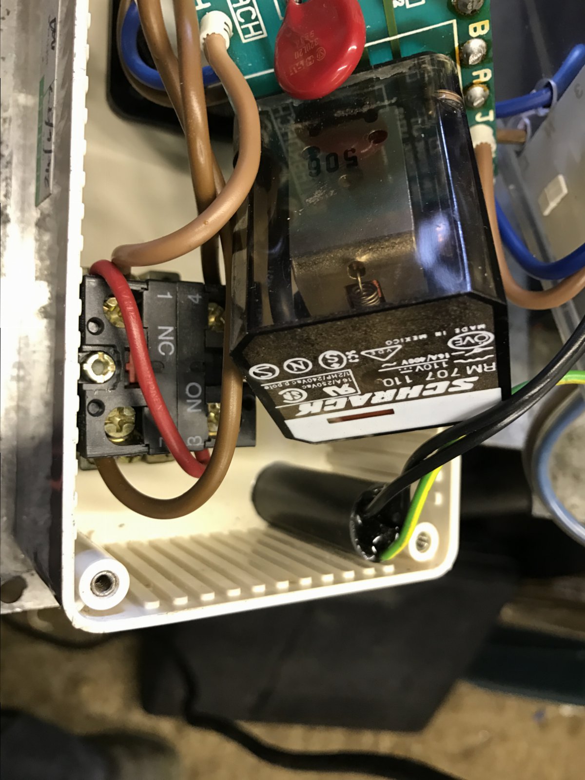

Anyhow the magnet works ok, and that's about it. No other signs of life. Brushes look to be ok, and no loose wires behind the control panel. I've only spent a few minutes looking over it, and I've not traced how far the power is getting - hopefully I'll get some garage time later this evening, so may have some more news later on.

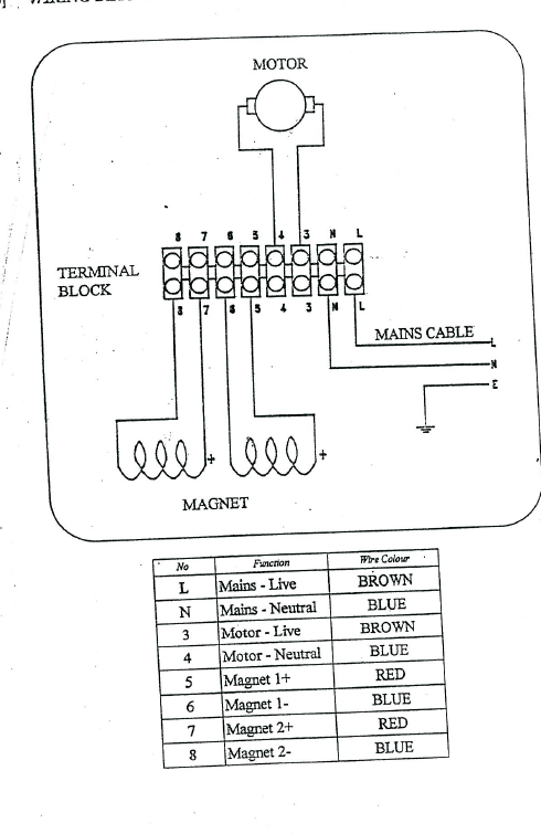

In the meantime, anything specific I should be looking for? Anyone point me in the right direction of a wiring diagram?
