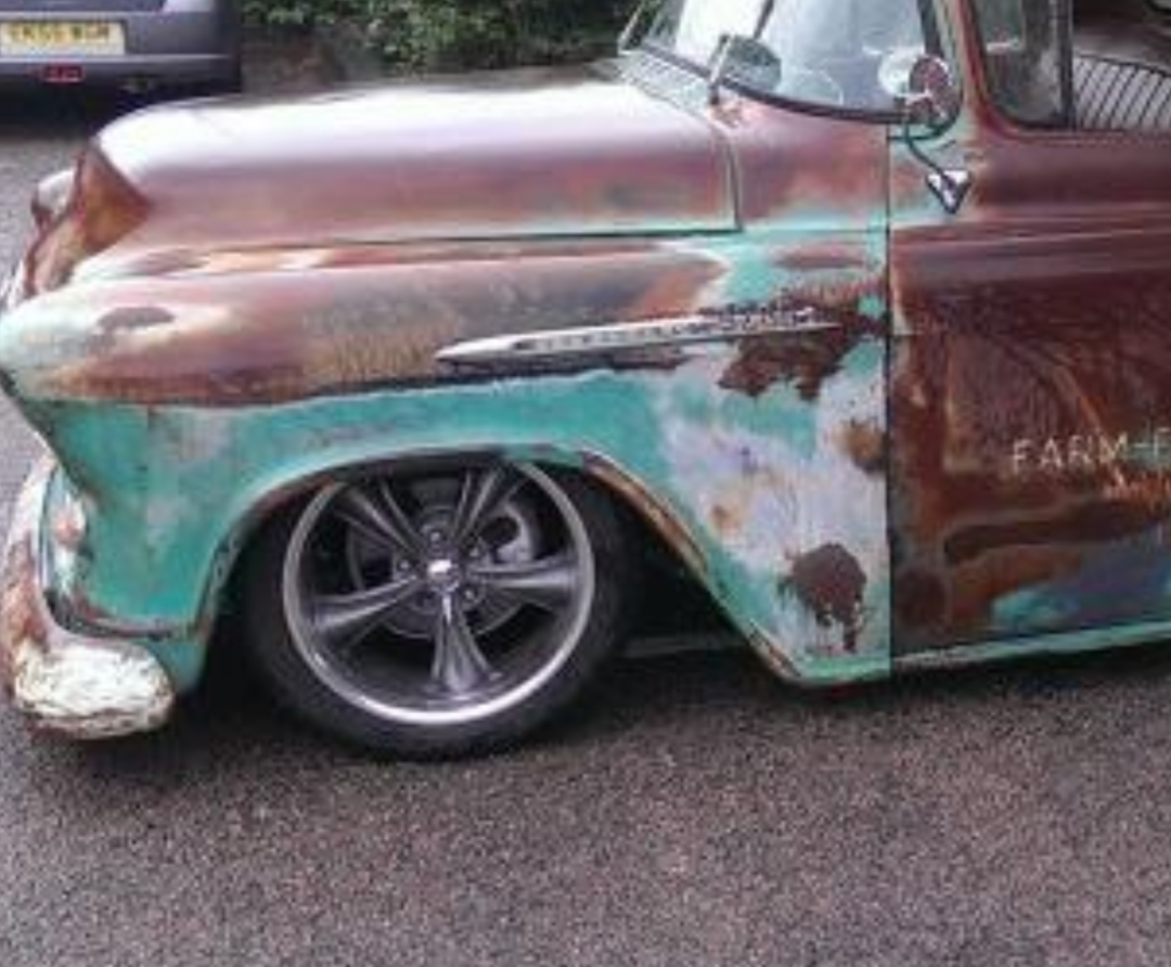

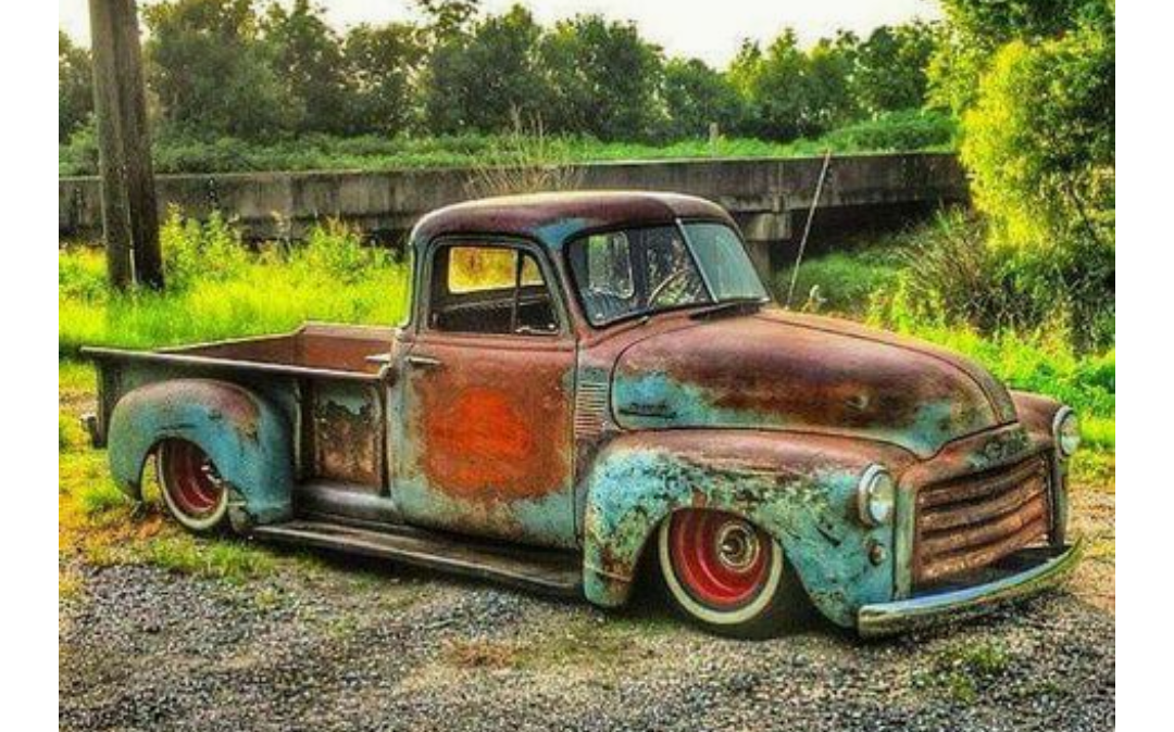

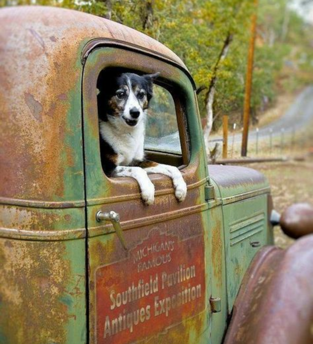

    Screenshot_20180313-223238~2.png Screenshot_20180313-223338~2.png Screenshot_20180313-225707~2.png
    Yep I've read a bit on Montana ,seems good stuff.
    Swinging a couple of ways on what to do with the bus.
    One option was a flat one colour coat , I was thinking two pack is the toughest that's why I was asking about safety here, I've asked on lesser informed groups and been told allsorts, it's too dangerous,it it's impossible too roller ect .
    Another look I fancy is the rust/patina look as seen on the old pickups and rods , the best colour scheme to show that look seems to be a duck egg blue or a verdigris green ,flatted , undercoat showing through and rusty.
    But I don't know if that two tone colour scheme and fake patina would suit a nineties bus.
    Kind of like this
