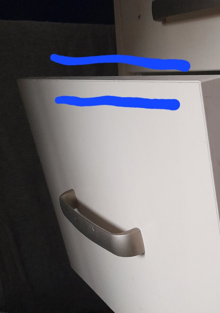

Cheers budGonna have to sand em up well anyway. Might as well fill
I'd have a test before committing.
Thanks pal ye I know what you mean mate cheers for infoIn my experience, those lines will re-appear whatever you do. I’d be tempted to leave them as they are and just spray in whatever way you normally do.
Not related to your question, but a thorough degreasing is really important with refinishing kitchen cabinets - even the cleanest kitchens pick up an amazing collection of cooking oil deposits, but I suspect you’re already aware of that.
