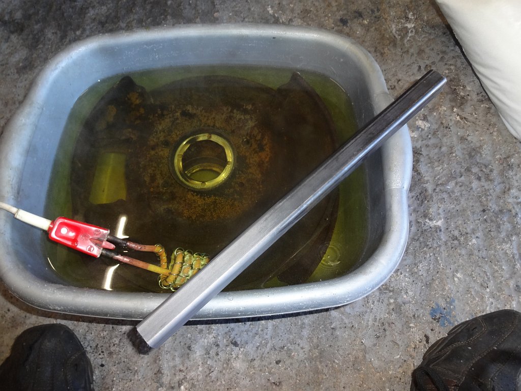

A while back someone suggested removing mill scale with citric acid, it really does work well.
I used this bit of bar as a stirring stick for a few minutes only then wiped it off, the scale came right off.
