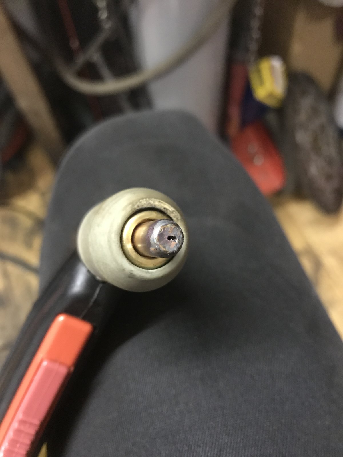

Really? My powermax 30xp worked really well straight out the box. Still on its original tip too!kim try to keep the plasma handle straight a slight lift at back of handle helps whilst cutting as your twisting the handle whilst in use
whats happening is your losing earth connection so tighten your earth lead and sometimes its your nozzles
its trial and error until you get the hang of it i went through 4 nozzles before i got used to using it
