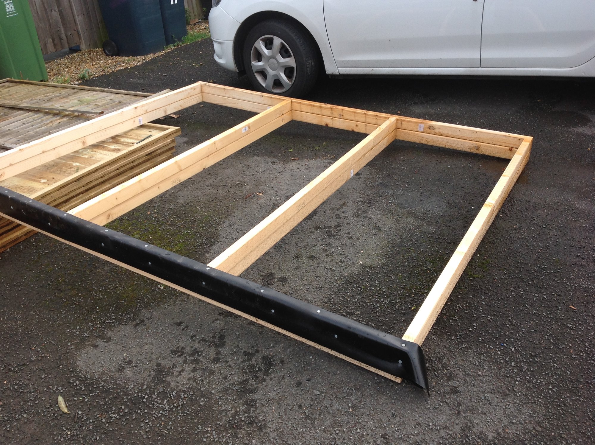

Ok so my present house , has no garage or space to build one unfourtunatly so the next best thing is too build a shed on approx a third of my small garden .
I plan on building it in manageable sections so when I move hopefully in a few years I can dismantle it and it comes with me
It will be sited on top of an existing decking area and approx 14' long by 7' wide .
So the sides will be in one section and the front /back in two sections each .

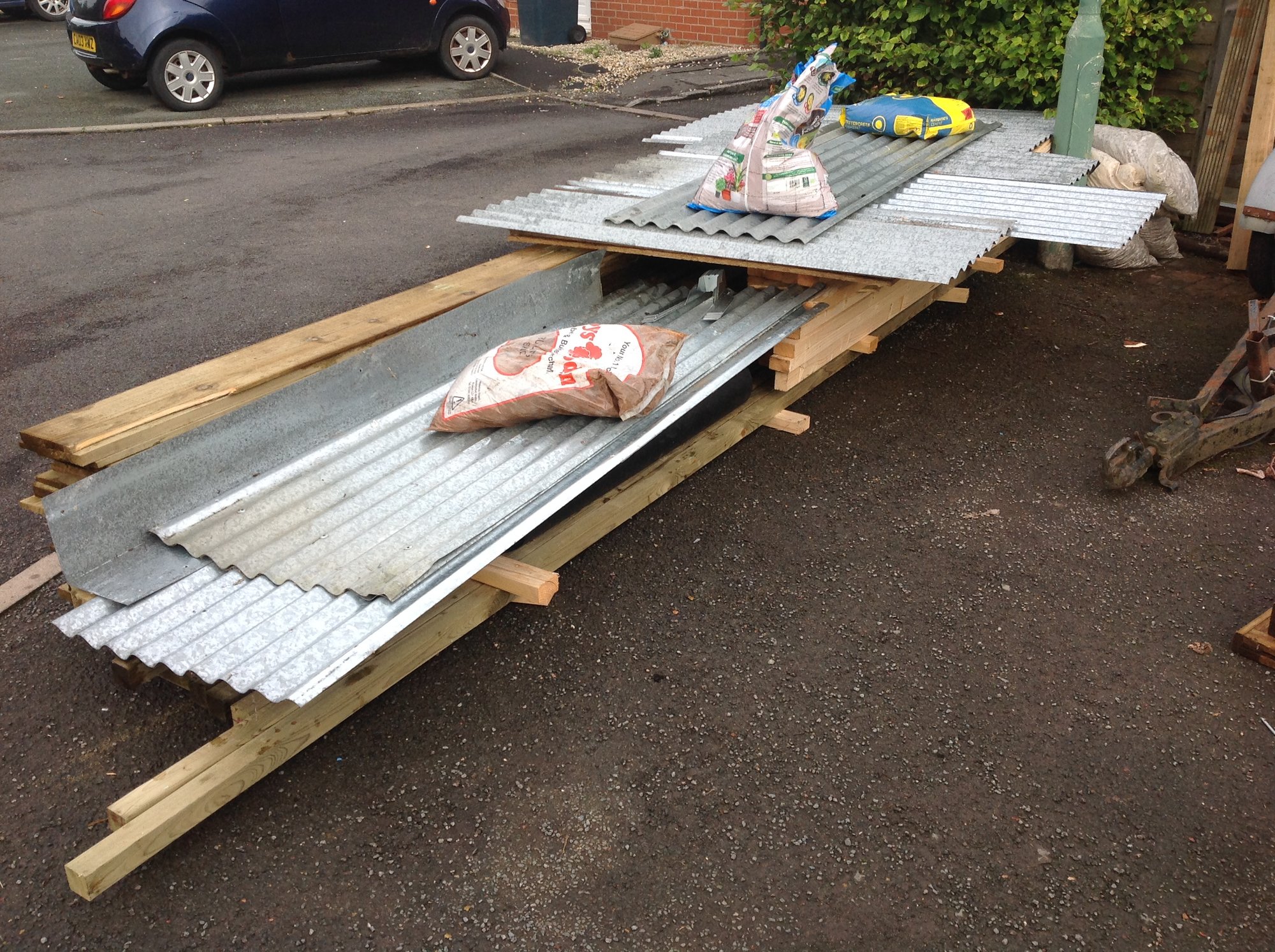

I already have corruged iron to clad the back which is against my hedge so won't be seen .

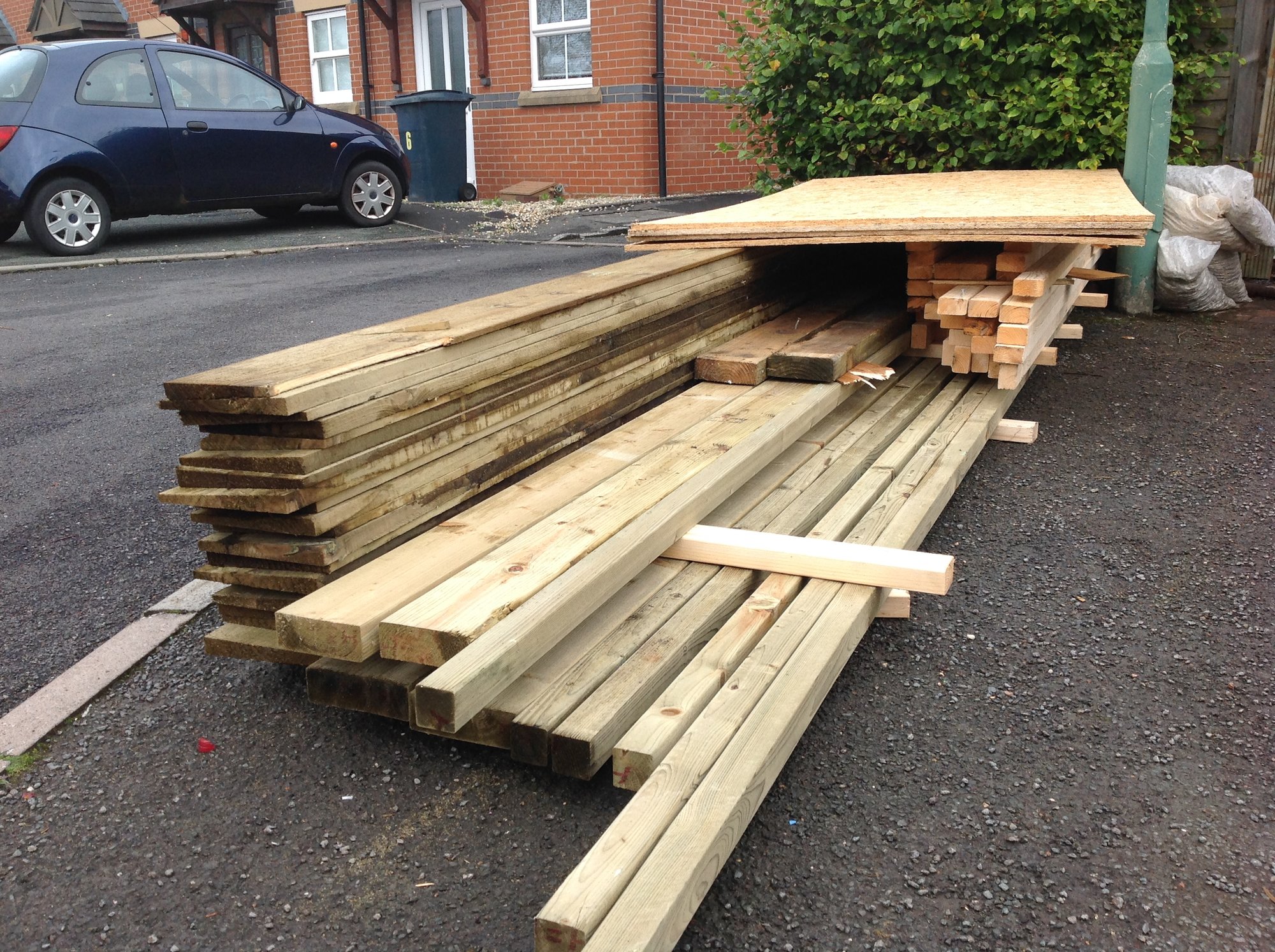

The front and back will be treated feather edge boards and roof box profile
Oh the basic structure is 75 x50 cls timber , which I will insulate after it has the external cladding on
Either rock wool Or polystyrene then 11 mm osb lining .
Anyway any suggestions /tips welcome and I will update as and when I make progress
So far I have a stack of timber and some partly made back walls
