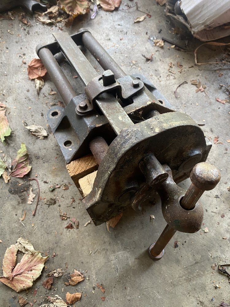

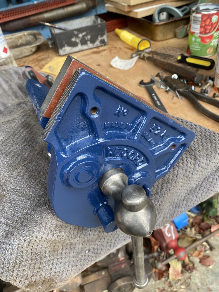

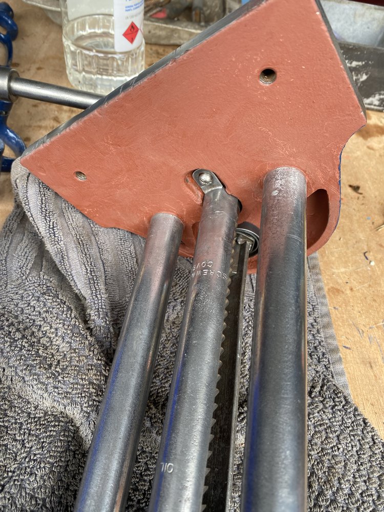

A total 'back from the brink' project this one. I got it for $25 as a garden ornament - it was caked in rust and mud and plasticky grease under that, spider nests and flecks of ancient paint. Still, everything was there although nothing was moving. Worth a punt? I thought so.
It sat on my 'do it later' shelf with the other vices soaking in oil for about three months, perhaps more. I managed to get the screw loose and out, then the quick release all unfastened, and then finally the rear of the slider was unbolted, with a few choice taps of the ratchet screwdriver.
This is it on the shelf - the halfnut next to the Record 52 belongs to the Parkinson as does the buttress thread beneath the monster 53 screw
I don't have many before pictures at all, only work in progress, but I thought it was (just about) thread worthy.

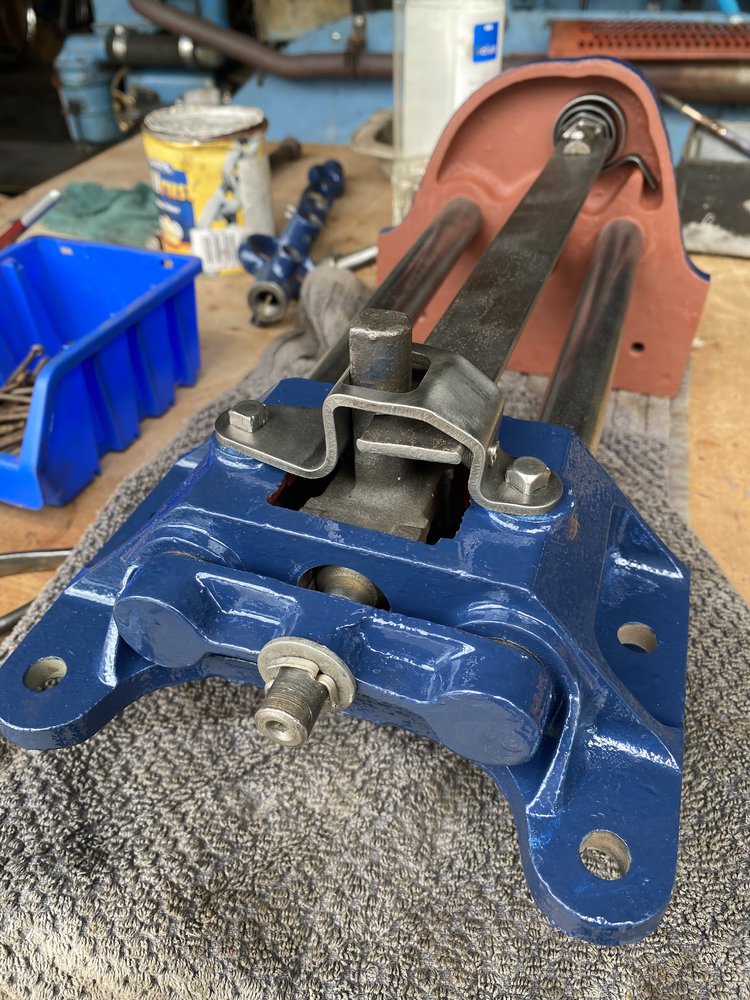

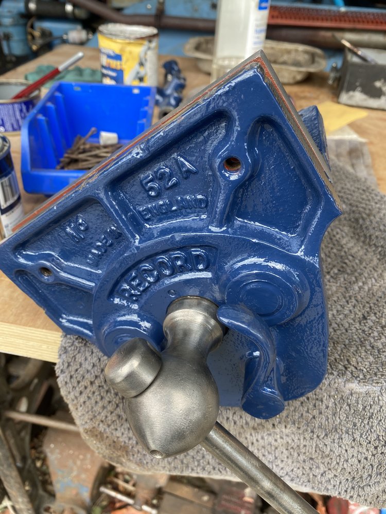

First up, a sandblasting for the rear
A complex piece of cast but the openings made the gun easy to get inside and blast away everything
There is a crack in the back, perhaps someone tried and failed to restore this before relegating it to the garden?
It's not a problem though as the rest of the cast is extremely rigid. When I got home, this was slapped into primer

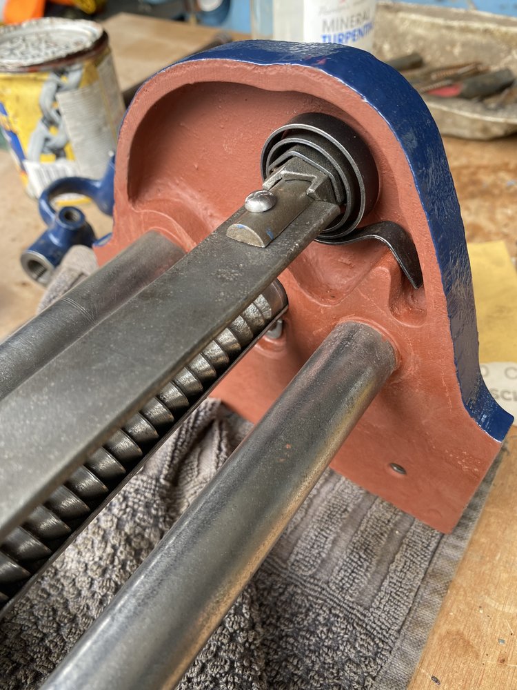

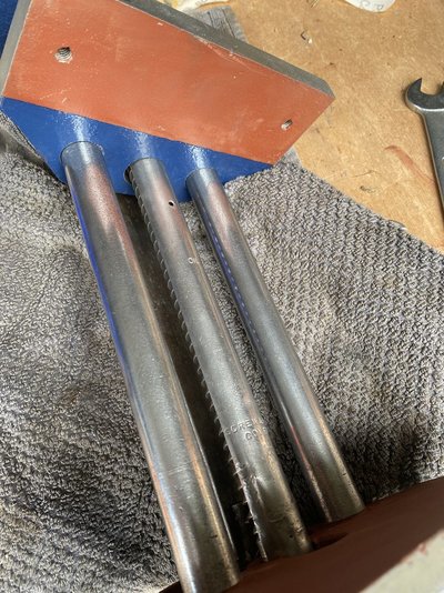

Next up I took the entire qr assembly and screw to uni. This was the second buttress thread I'd done in two days along with the Woden one! The little bits came up good, though that bar needed a go with the flapdisk as it was seriously pitted and made the sliding motion a bit stiff later on
I couldn't believe how well the thread came up though. All the hard plasticky grease that was lurking in there (and was even difficult to shift with a knife) was blasted and then brushed free
The tommy bar was a bit bent, but luckily there are vices aplenty at uni so I used a Record No4 to press it back into shape. I wanted to use their Record No25 but the qr assembly has been put back together wrong and it clicks and flicks the handle on every turn.Perhaps I should volunteer to rebuild it for them?
