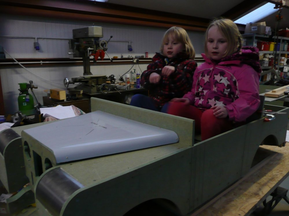

I've just about finished the bodywork on my kids Toylander, its made out of moisture resistant MDF with some bits of pine batten, a little ply and the bonnet front wing top/corners are aluminium. It has to be sealed otherwise it will swell then turn into soggy weetabix. There's a range of systems people use on the Toylander forum, PVA to seal the wood then synthetic or cellulose of 2k etc. Some use brushes, rollers and some pay almost a grand for a body shop job.
However I thought I would illicit the opinions on this forum before buying/doing anything as I have enough unused paint on the shelf!
I will be filling and rubbing down the bodywork with upol filler first. My finishing criteria are :
Alternatively if somebody near West Yorkshire has spraying facilities for 2K I'm all ears, especially if there is some land rover colours knocking about, I may settle on Bronze green if its available.
I'm having difficulty uploading a picture on mobile broadband so it will have to be a photo bucket jobbie. This is from a few weeks ago, its moved on from this quite a bit, I just have to make the rear door and do a trial fit of wind screen and suspension/motors and do a bit of filling so about 2 weeks away from paint day.
Regards
Andy
- Sealing the woodwork is paramount as the kids will leave it out in the rain and we get plenty of it up here
- Finish is secondary as the kids will bash it into stuff, having said that I don't want it to look a dogs dinner.
- If the kids really do a good job of hitting stuff, I want to be able to repair it relatively easily so its water tight again, I don't mind the odd battle scar.
- I have two daughters, they already know not to even think its going to be pink
it will be a classic Land Rover colour, probably the light green with black or silver "chassis"
