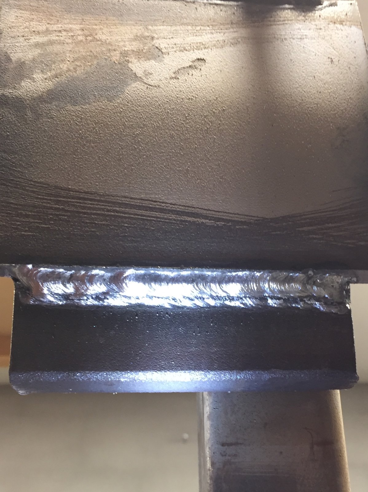

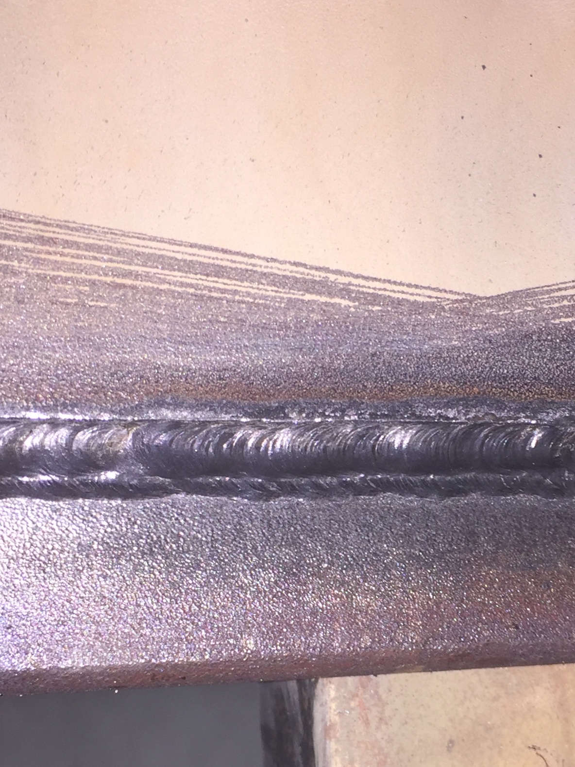

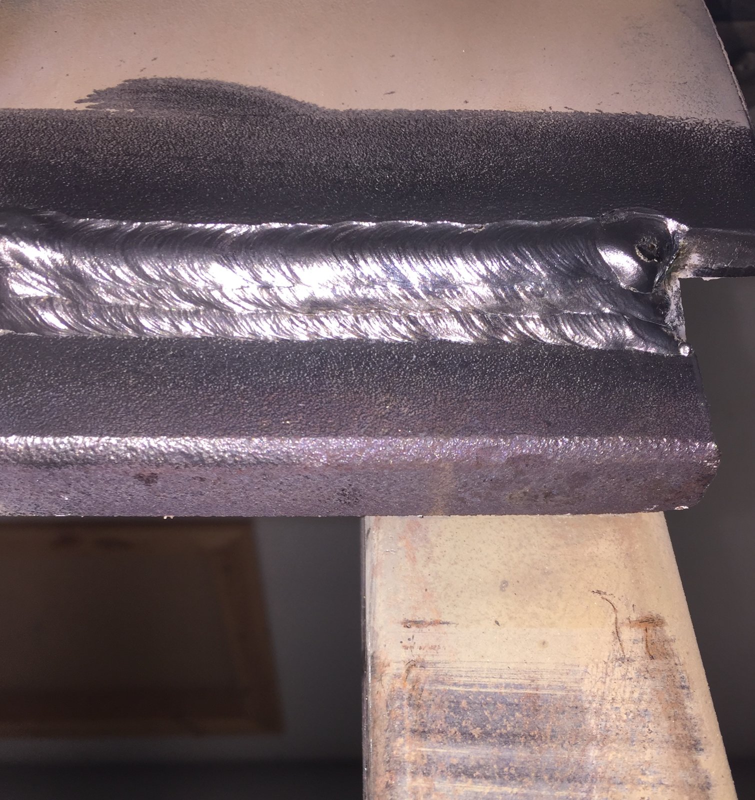

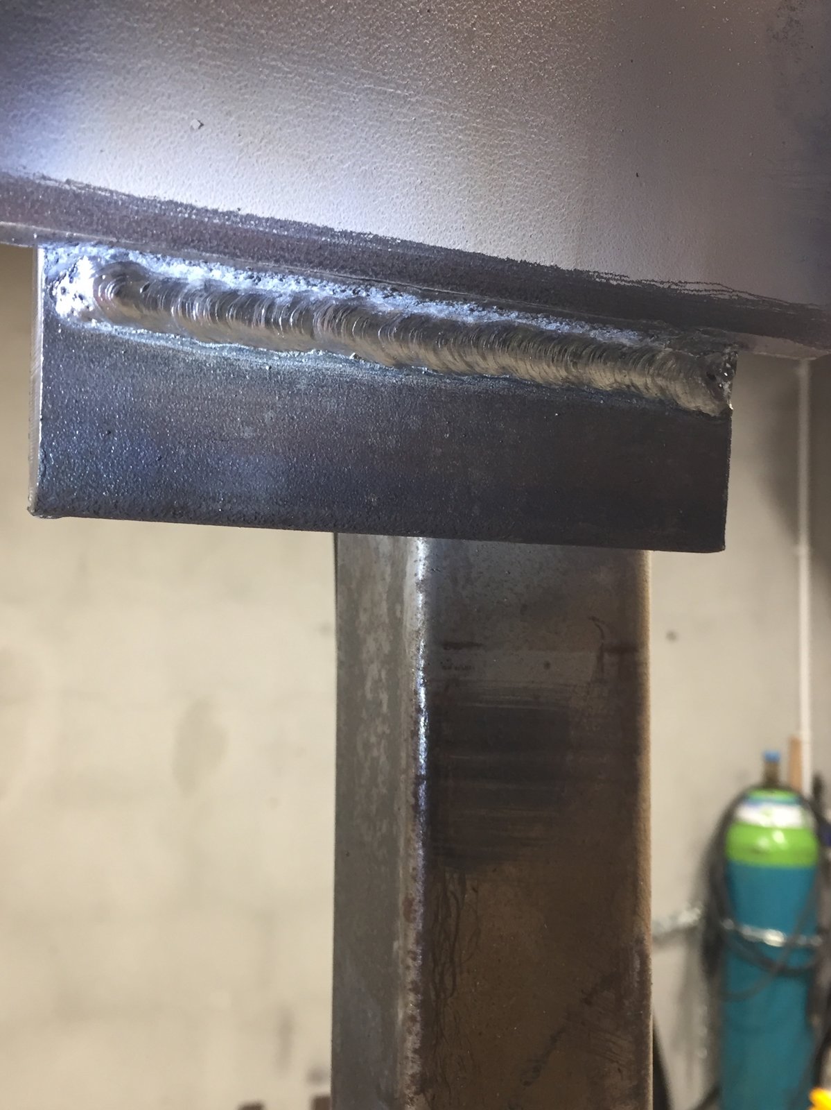

MichaelV Member Messages 242 Location Co. Antrim Feb 10, 2018 #1 Just another wee test. Overhead fillet (12mm + 20mm plates, lap), 3.2 dia Böhler Spezial D 7016, 95A DC+. Not easy at all, and hats off to those who need to do it properly. Very nice running rods, the Spezial D. Michael
slim_boy_fat Forum Supporter Messages 29,501 Location Scottish Highlands Feb 10, 2018 #2 Better than could do........even if I tried.
