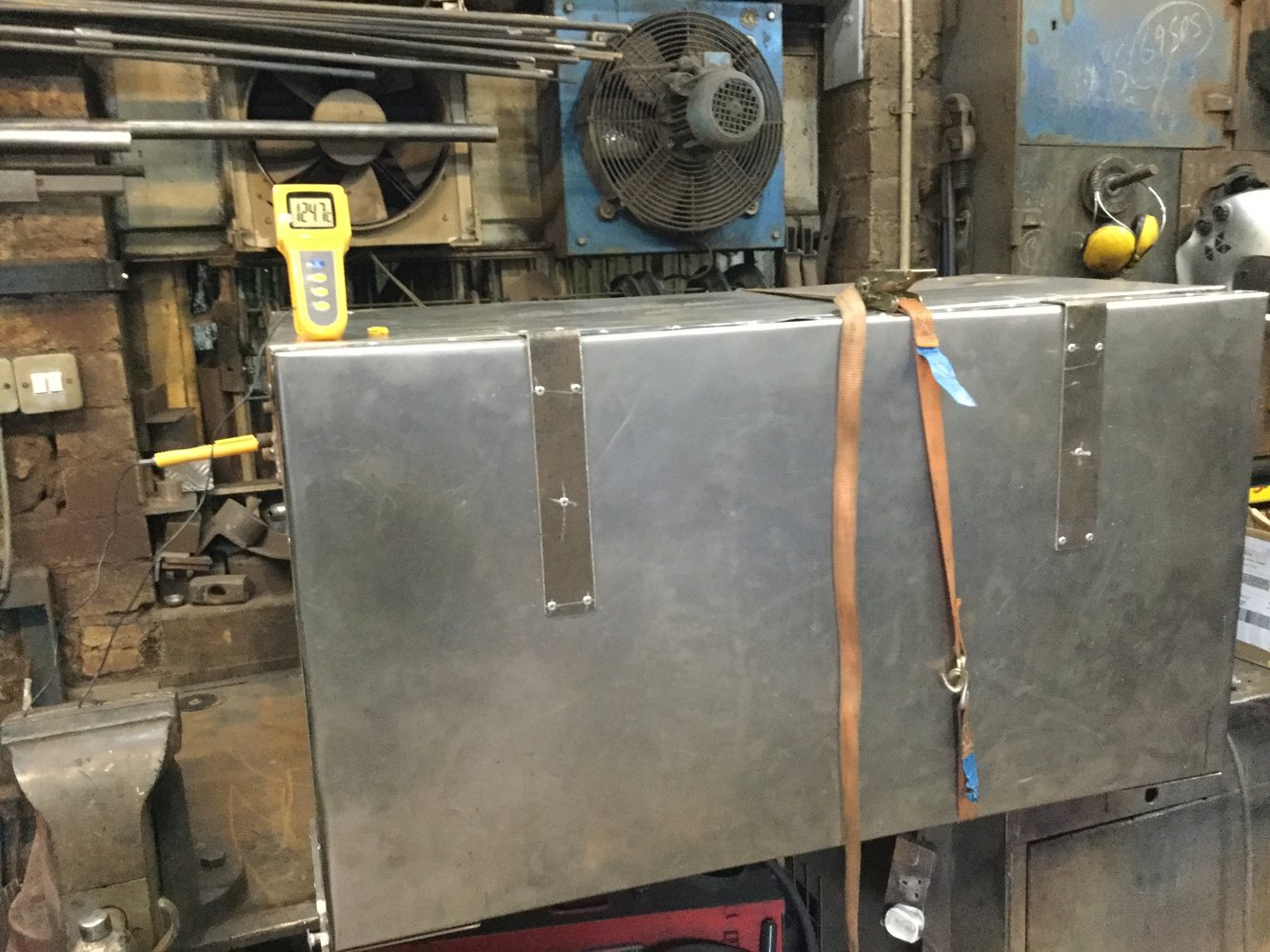

I'm part way through knocking together an oven for curing "out of autoclave" prepreg carbon fibre.
It's all 0.8mm sheet inner and outer with 50mm of ceramic fibre between.
It's 1000x450x500 internal area. I've got a 2.5Kw heating element and fan out of an old cooker.
The folds on the sheets are a bit dodgy as i'm just clamping it on a bit of angle and knocking it around with a hammer.

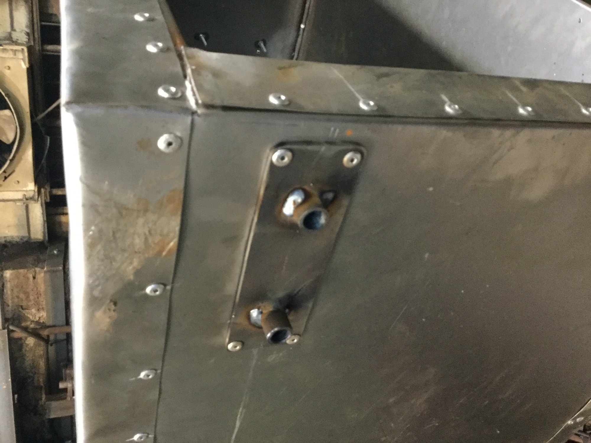

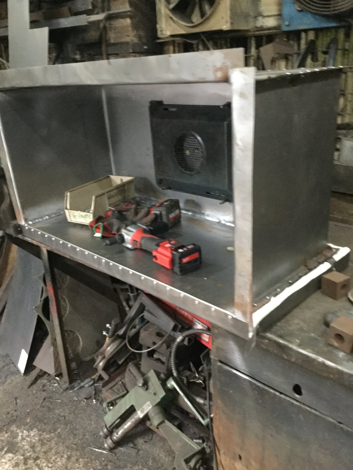

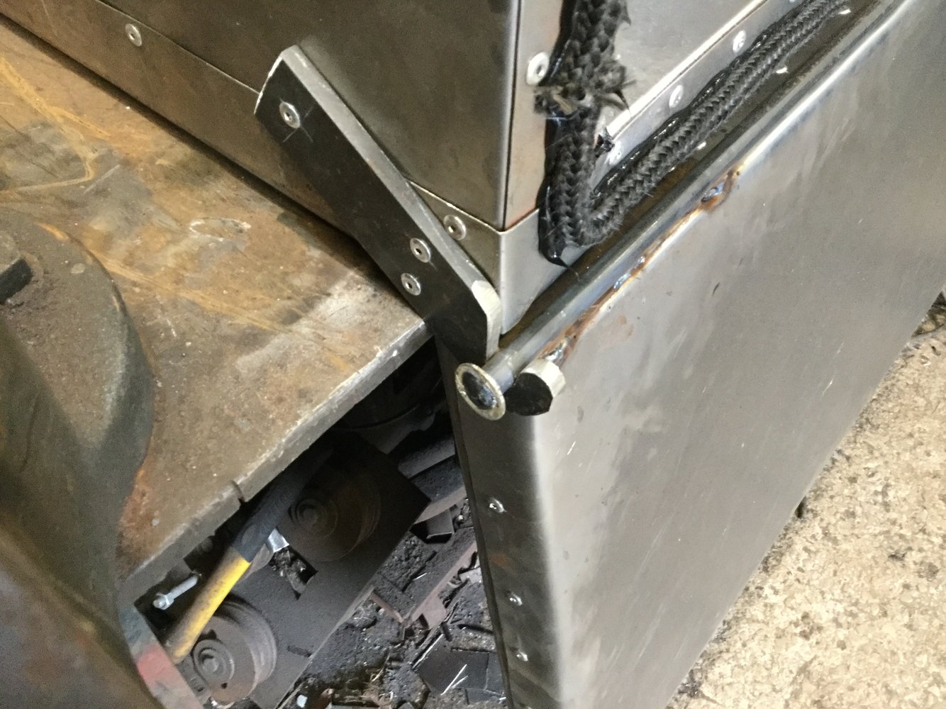

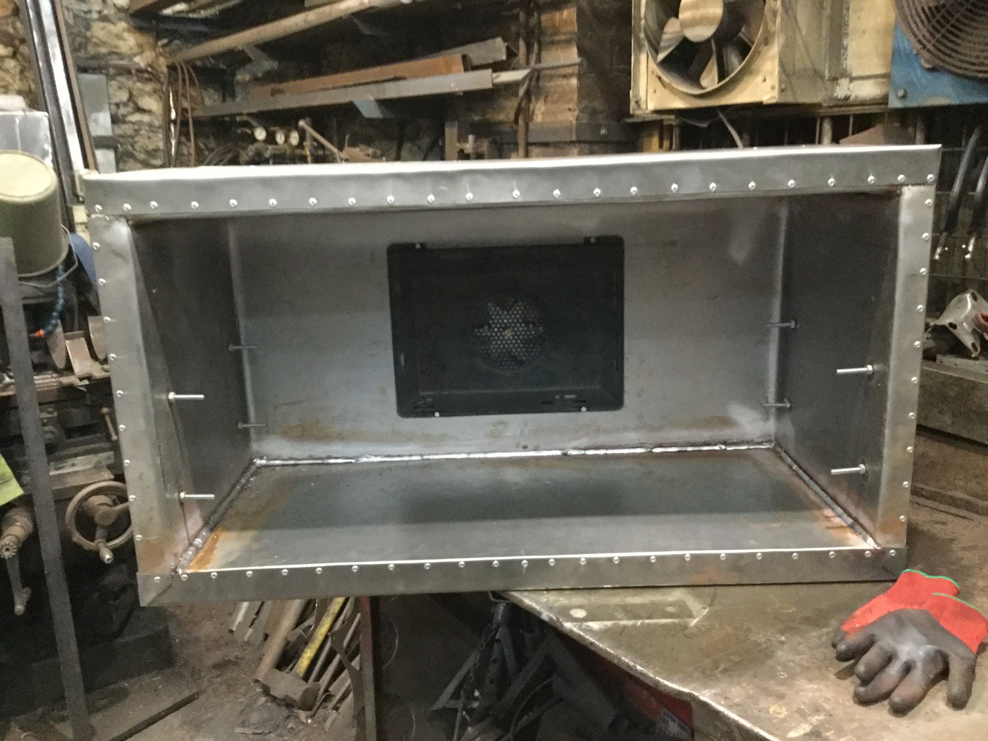

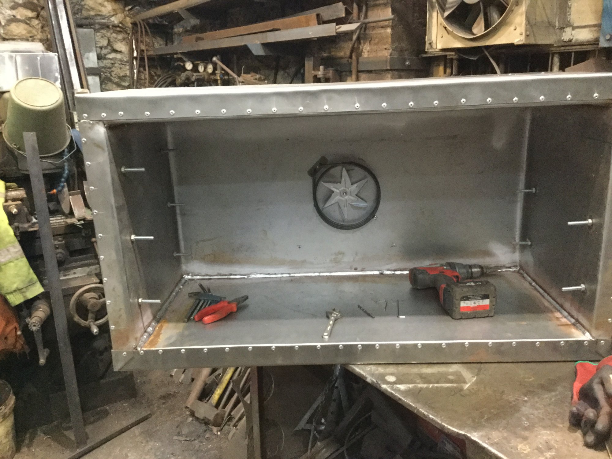

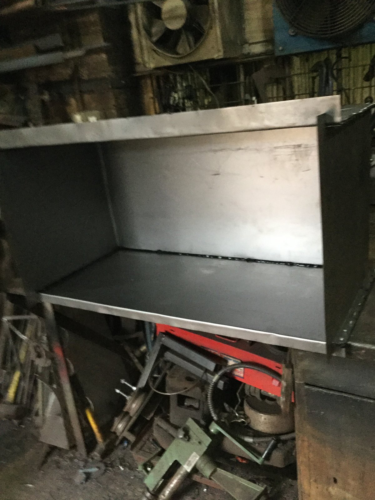

The inner shell riveted to the front and sitting on the outer base.......two brackets at the corners joining inner & outer.

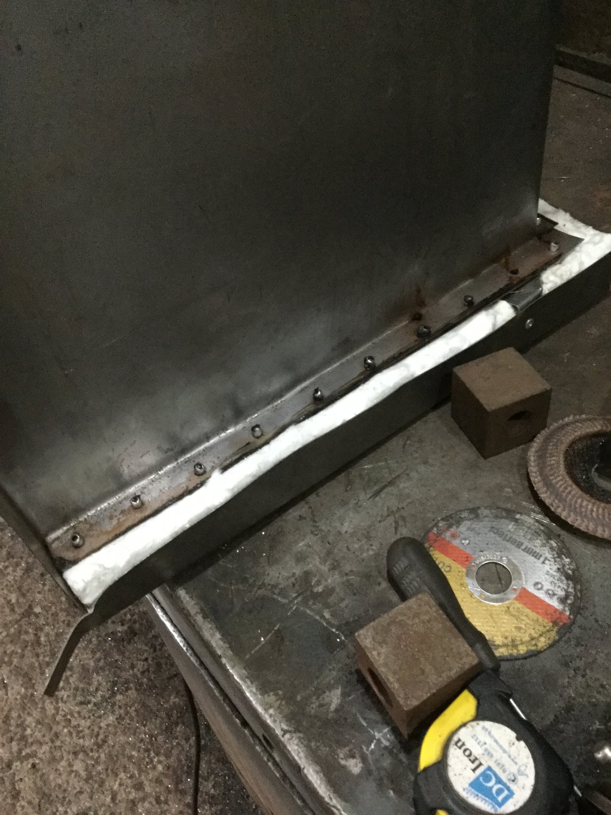

50mm ceramic fibre between.
Bought myself a cordless riveter which works nicely.

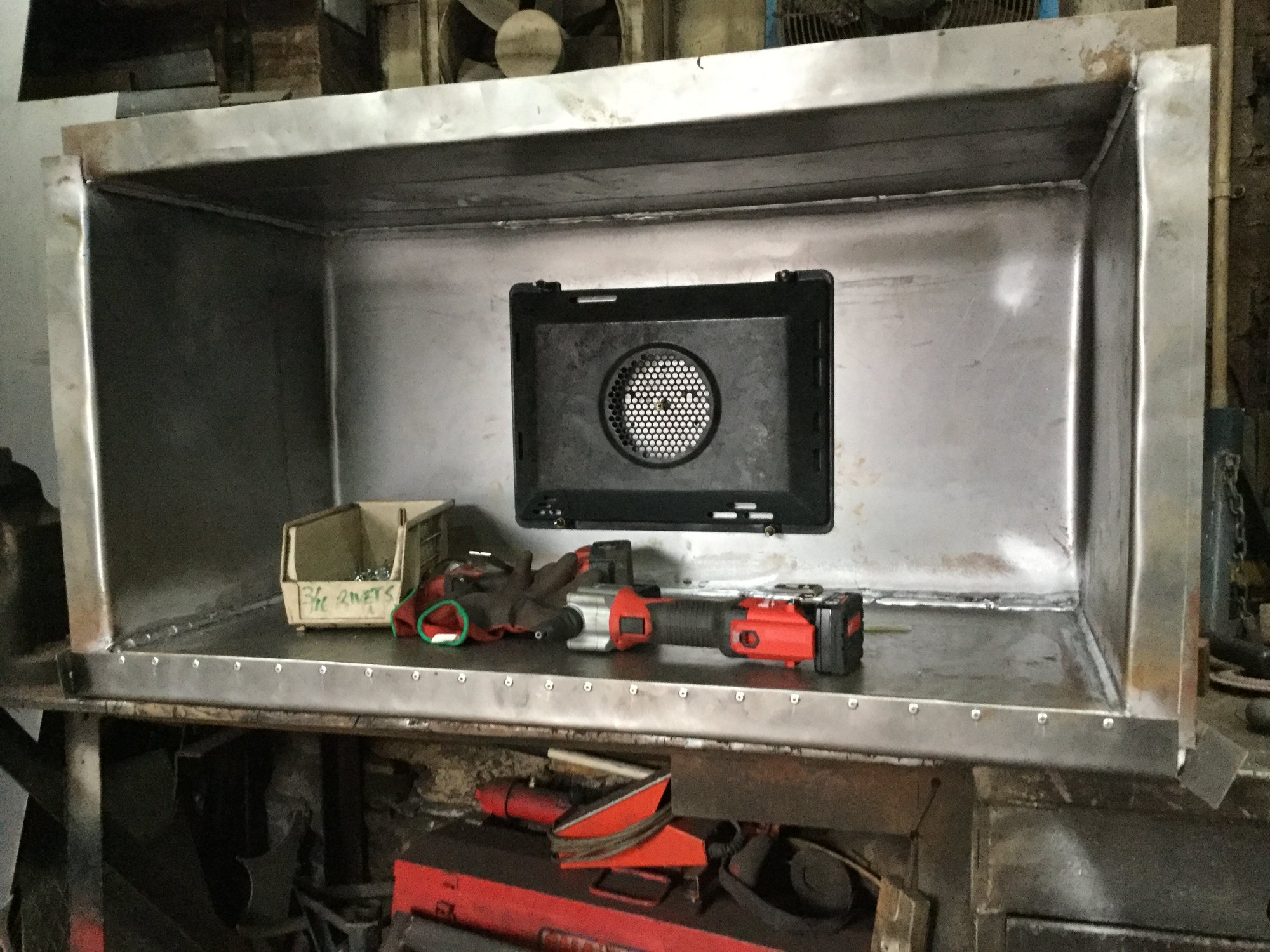

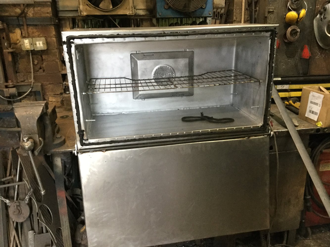

The guard in the back is from the oven i took the heater off......just held by clecos at the mo.
