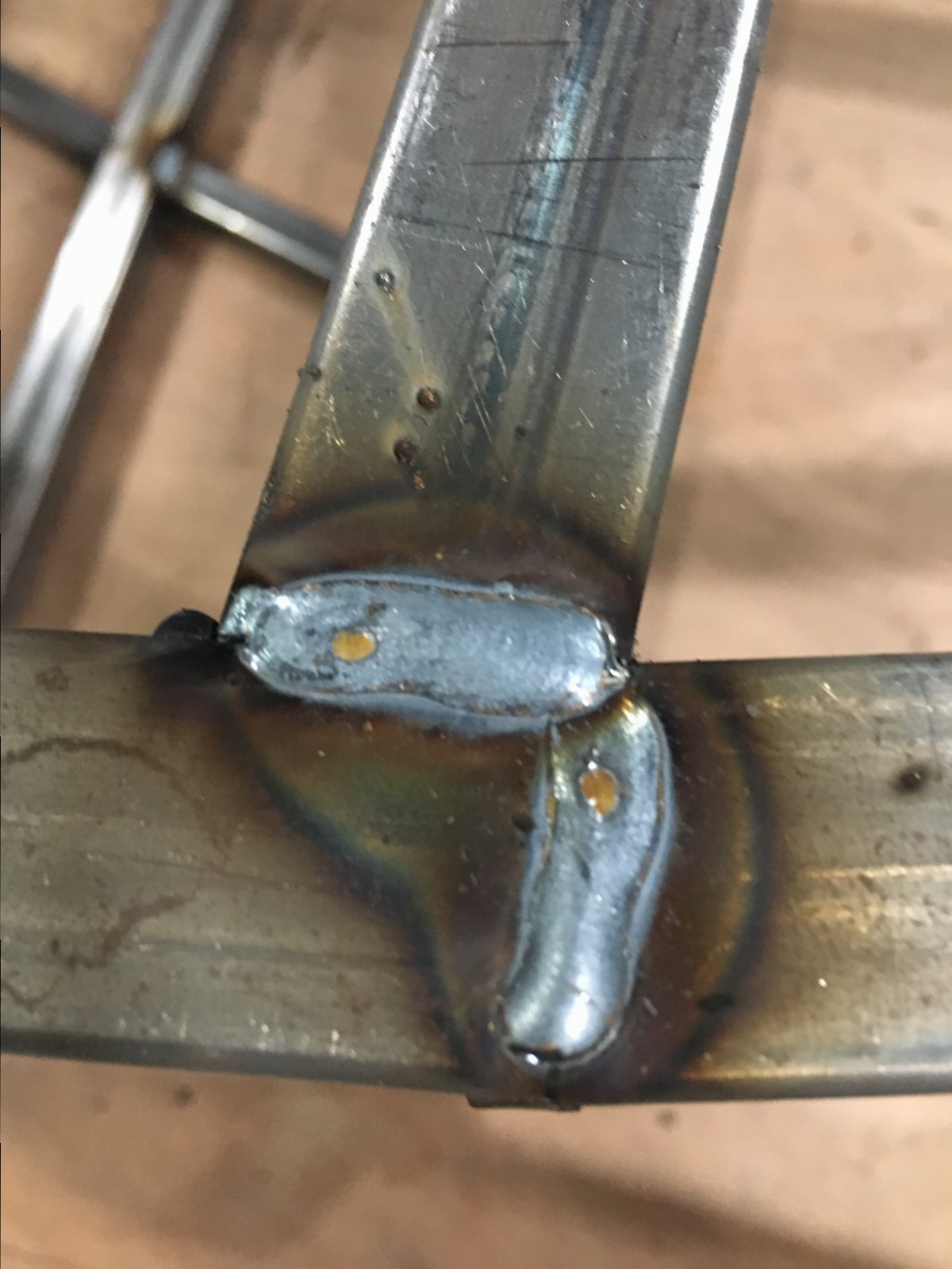

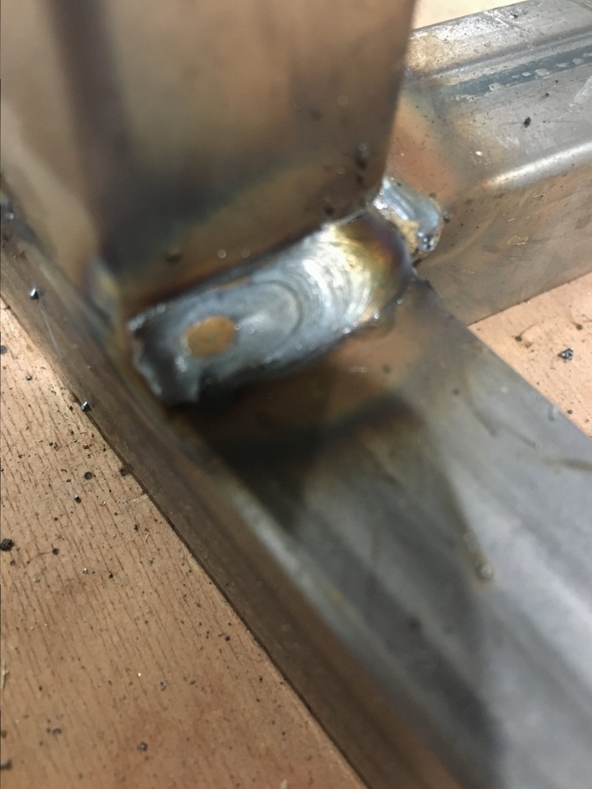

It's not bad but there ain't much to go on. 3x 1 inch stitches ain't a lot to pass real pointers on. They look clean and well fused. Can't add much more really.
Deffo in the right direction, maybe a bit hot. If you can, try some longer welds, increase your travel speed a bit, concentrate on keeping angles, stick out length, travel speed etc consistent
