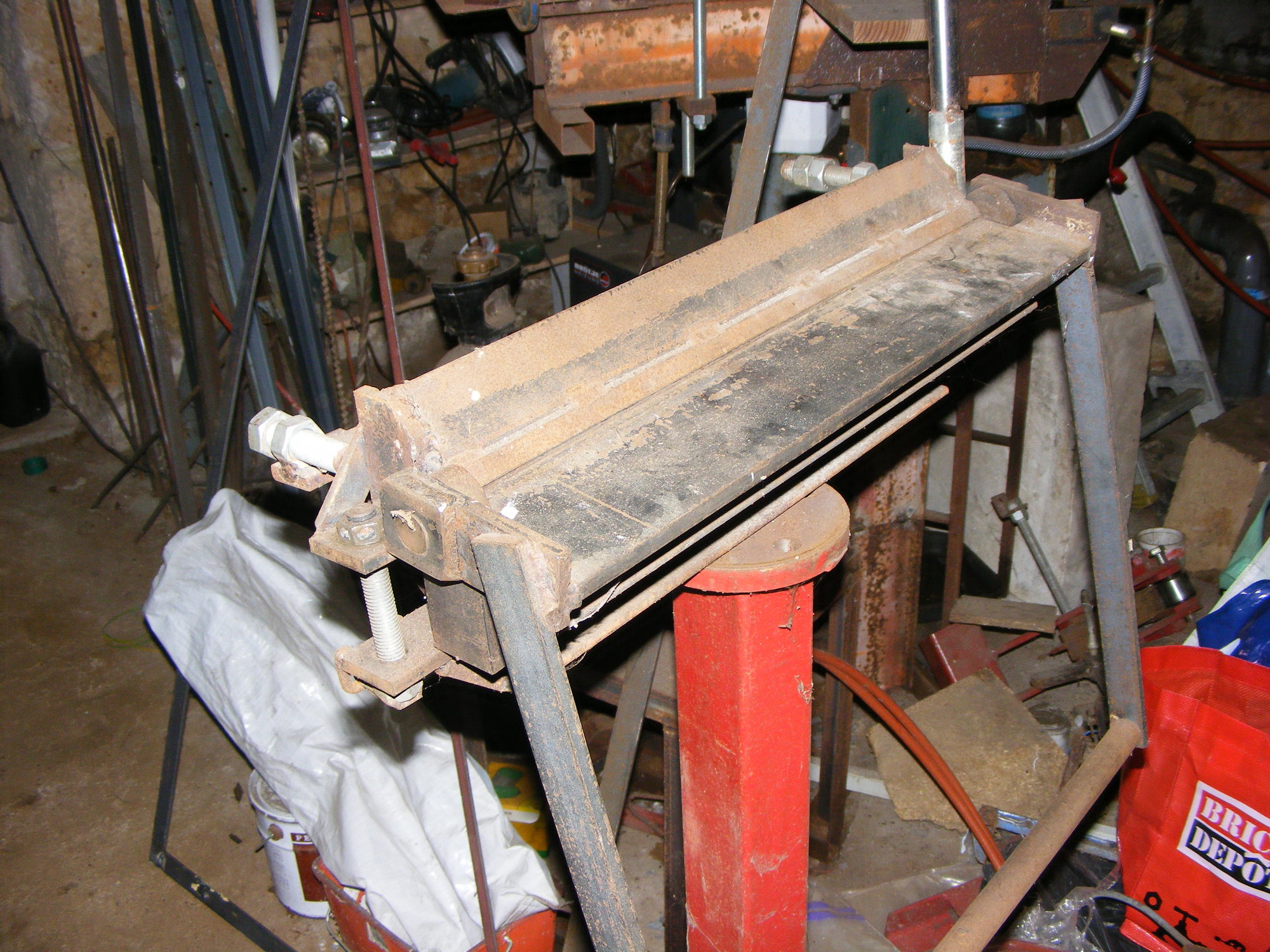

I think we need to just let you get on with it now.
I’m sure you have enough ideas now and you’ll find Challenges with all of them because been completely honest none of them are the right tool for the job. A 600mm set of bench rollers for 1.5mm is neither that expensive or space invading. Certainly less space taken up than what all that under your press is gonna generate once/if you drag it out to knock up your big tool.
I’m 99% sure your tool isn’t going to bend your sheet in the fashion that you want it too. Every time I look at the drawing (it is a nice drawing by the way) I see another reason that would cause it to be a disaster. The biggest issue is transferring the pressure from that tiny central point into equal pressure over 600mm long which is challenging enough on a tool working on the machine bed but to extend that tool what looks to be 800mm to 1mtr down makes that challenge ten times more difficult. It won’t work unless that pressure applied is equal right across. Even 1mm which is way easier to bend I think you’ll struggle with that idea.
Hopefully you’ll try it and let us know eh.
