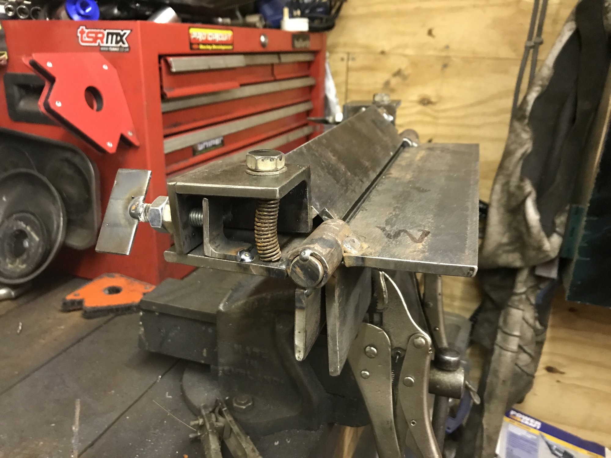

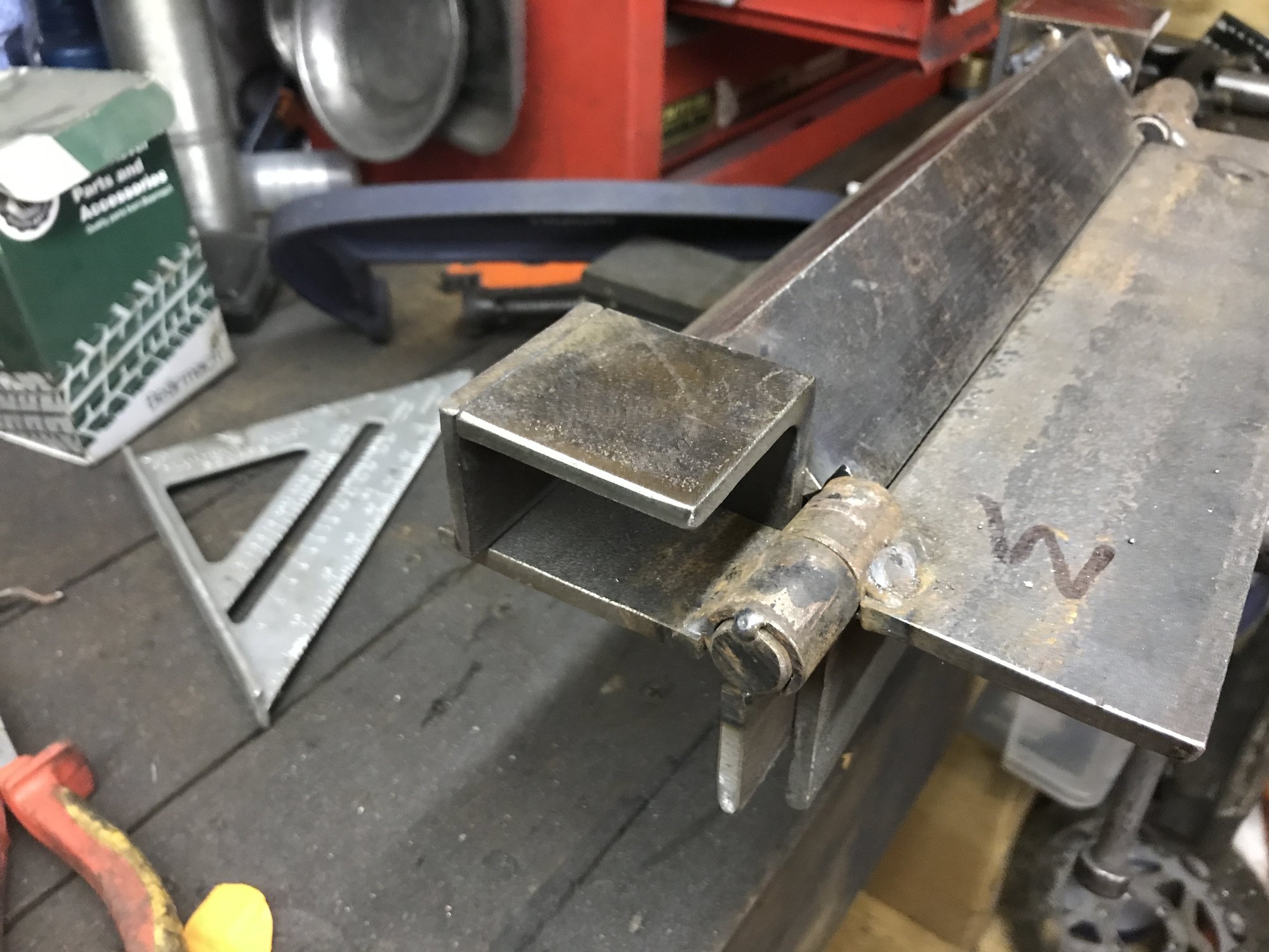

So, for those that have followed my Landy rebuild, you'd have seen the metal brake I was using to Fix the bulkhead.
I decided to finish said brake after work today

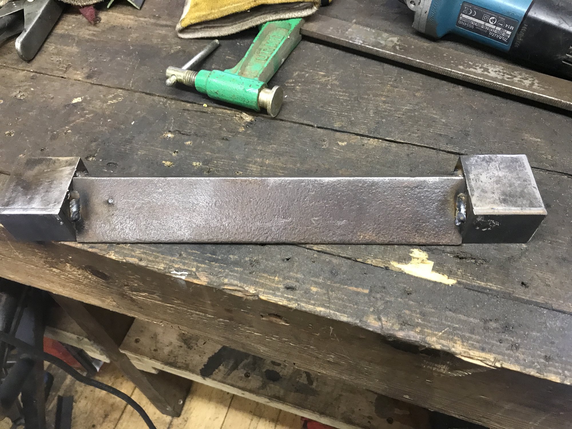

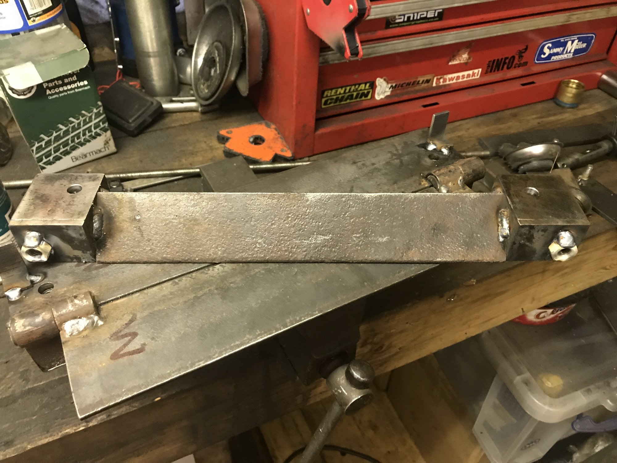

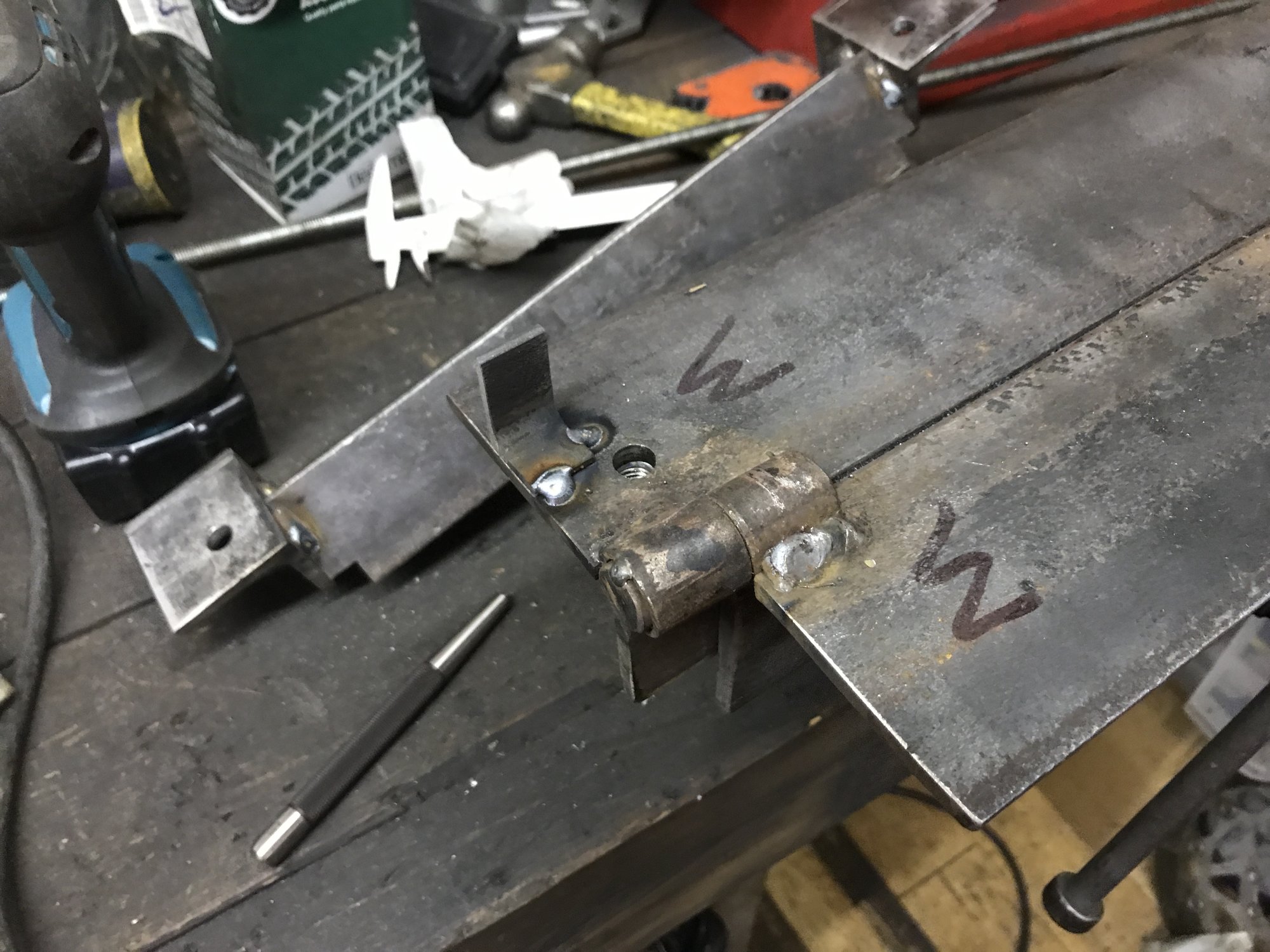

I had a look at some ideas today. I was basically making the clamp and adjuter today.

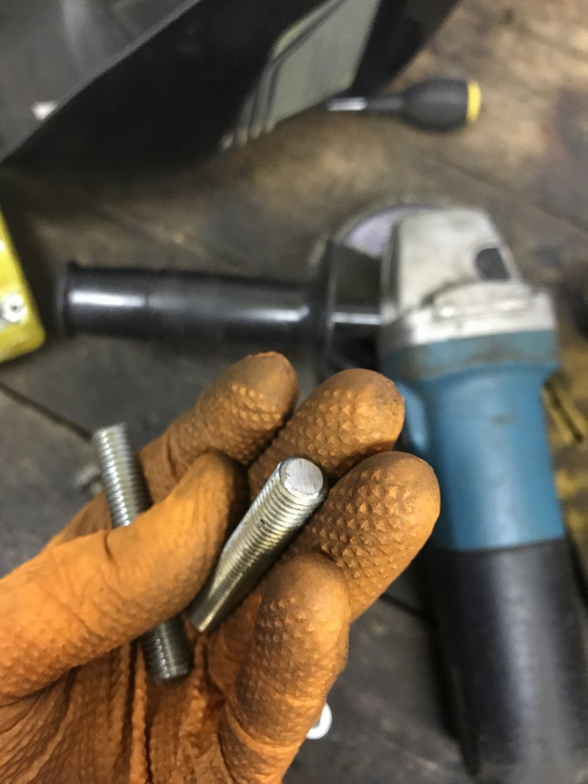

This pic was to show the Femi saw I reviewed, it cut these off so neat then I literally did one swirl with a flap disk and they err perfect!
Springs are just for effect right now, I need to order some springs that'll fit over the bolts. Also The mole grips were before I found some steel for handles.

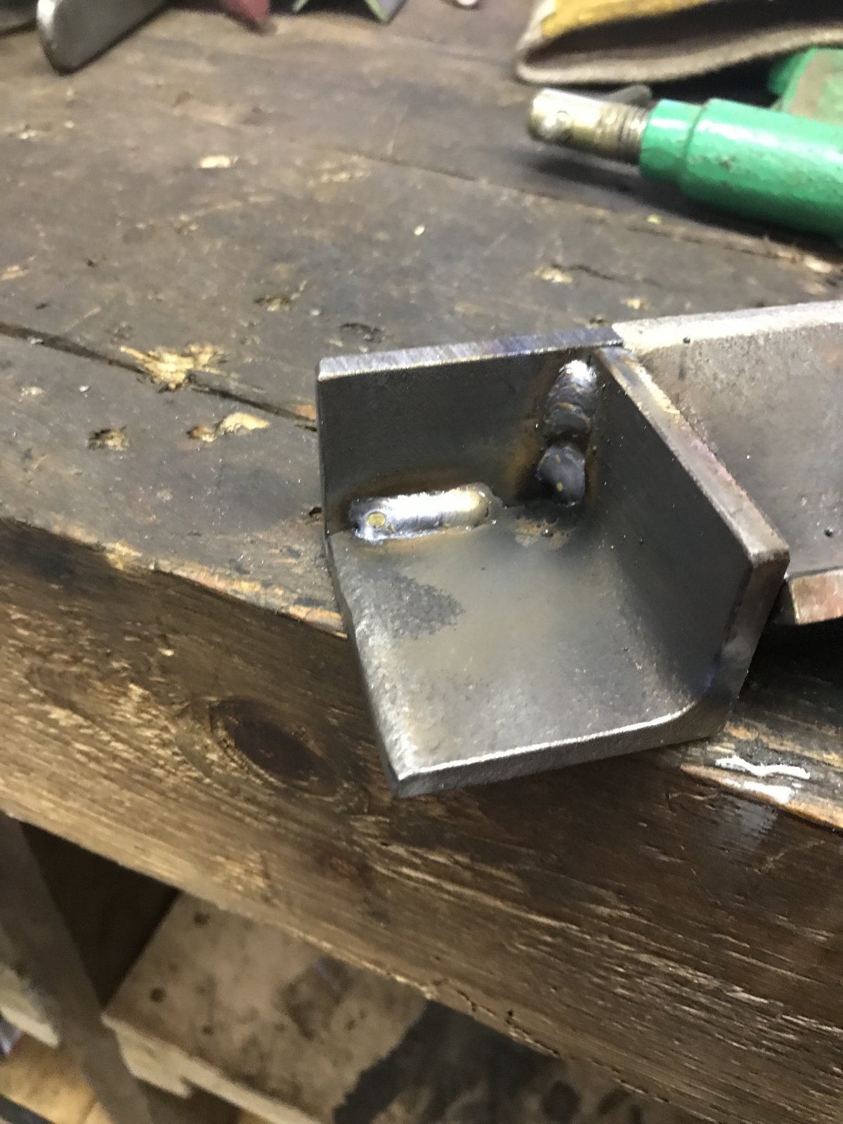

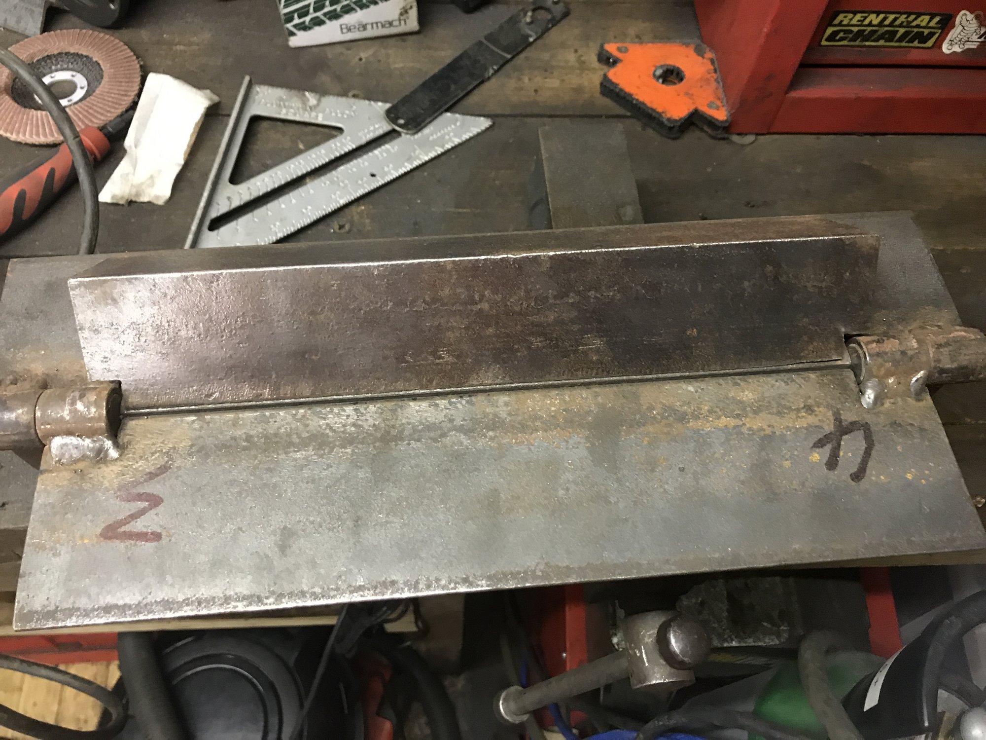

I'm quite pleased the bends are quite tight which is good. Not bad for a load of scrap! I did incur more injuries though haha. Grabbing a fresh weld after doing it wasn't he wisest, also don't try to fold a peice of welding wire in your hand, I learnt the hard way, went all the way through the skin in my palm haha.
