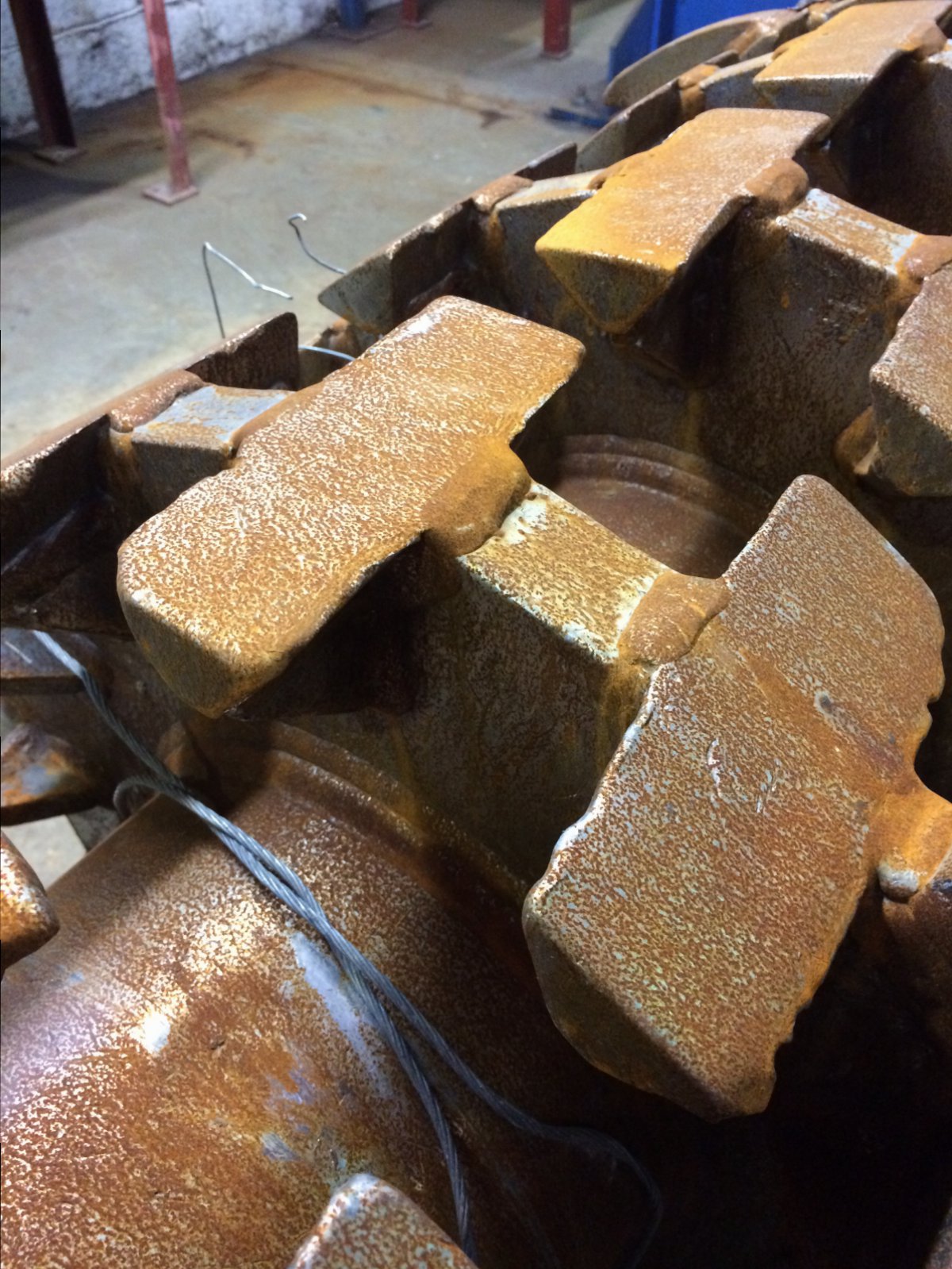

Whats the Compressed Air line for?
Its Arc Air gouging. So the Carbon Electrode creates the Arc and ensuing molten pool and the Stream of compressed air blows the molten metal away.
Very noisy
I still set the alarms off at airport security every time so I'd assume not lol.Have you picked all the bits of now cold molten metal out of your body yet before your scars start to rust.
Done loads of it.
600 amps is child's play.
Get a Miller dimension 1250 with some 13 mm carbons on the go and count the scars afterwards.

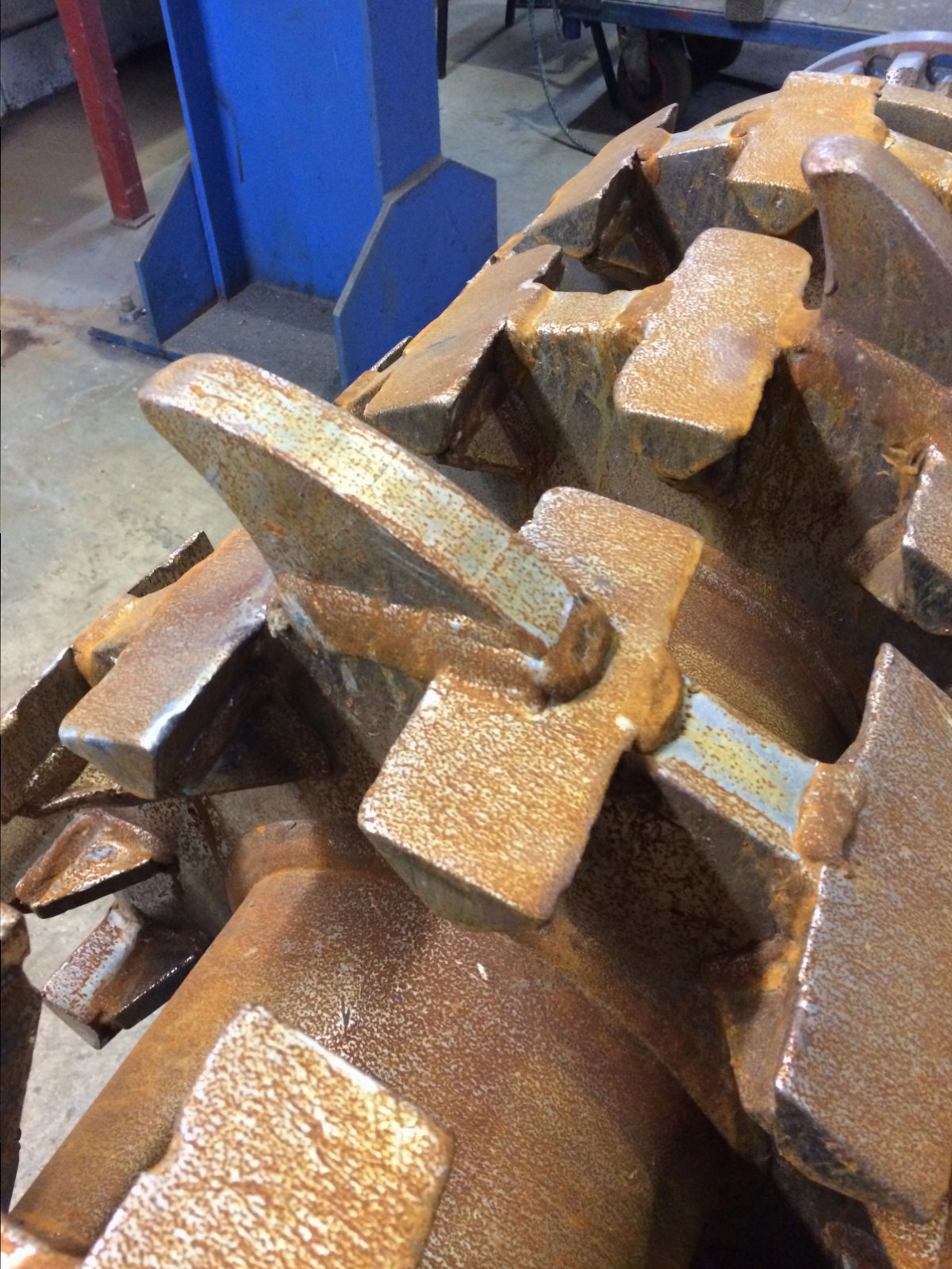

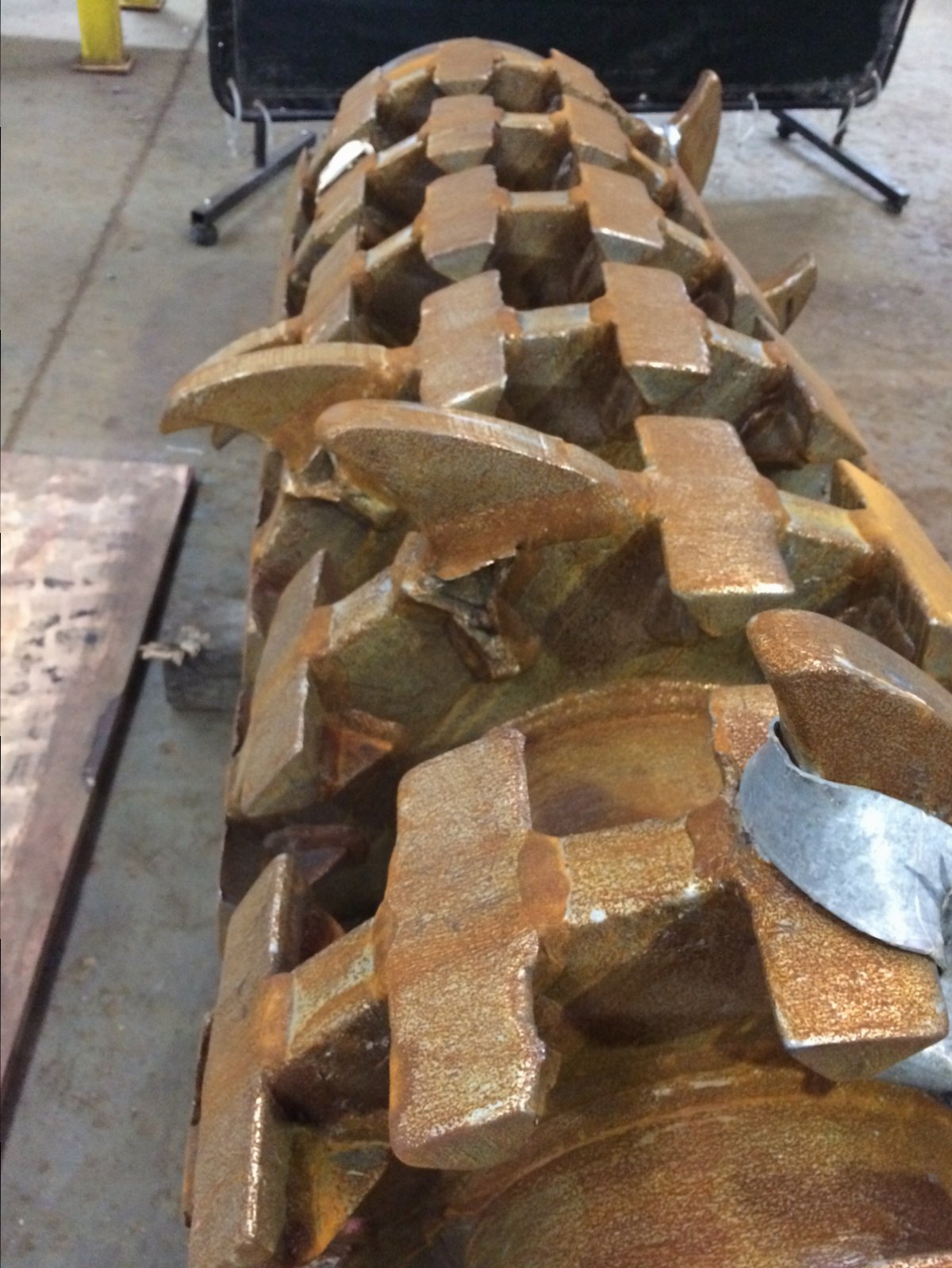

That looks like some sort of stone crusher. Are the teeth been cladded after the gouging.
As Al said the material is gonna be full of alsorts been a hard metal. Don't know how much gouging you've done Jim but ear defenders, good extraction, adflo kit and leather jacket are essential

The power source in fairness is irrelevant. If it spits out enough current to comfortably carve off the metal all is good.How much?! I'd sooner get the 1000 amp EWM or a DC1000 Lincoln, less spendy for me as I have agencies for both. Miller no, I have to buy them used if at all.
