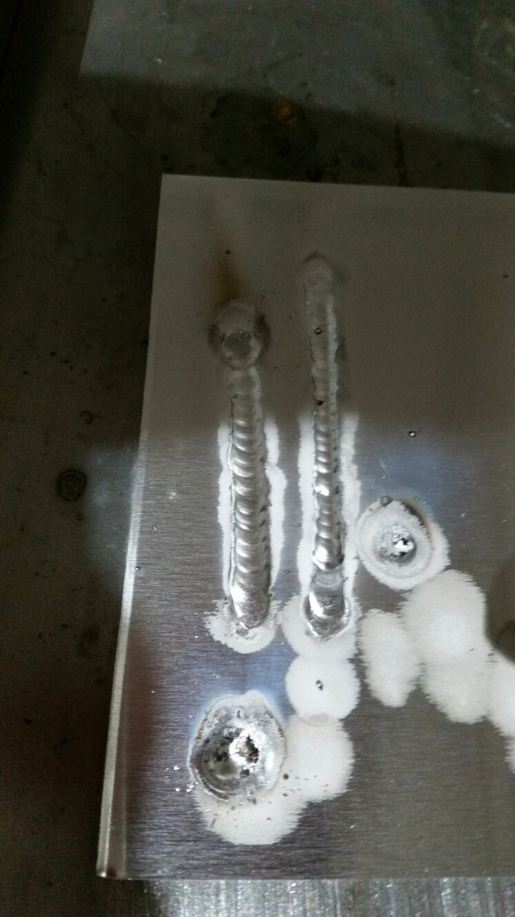

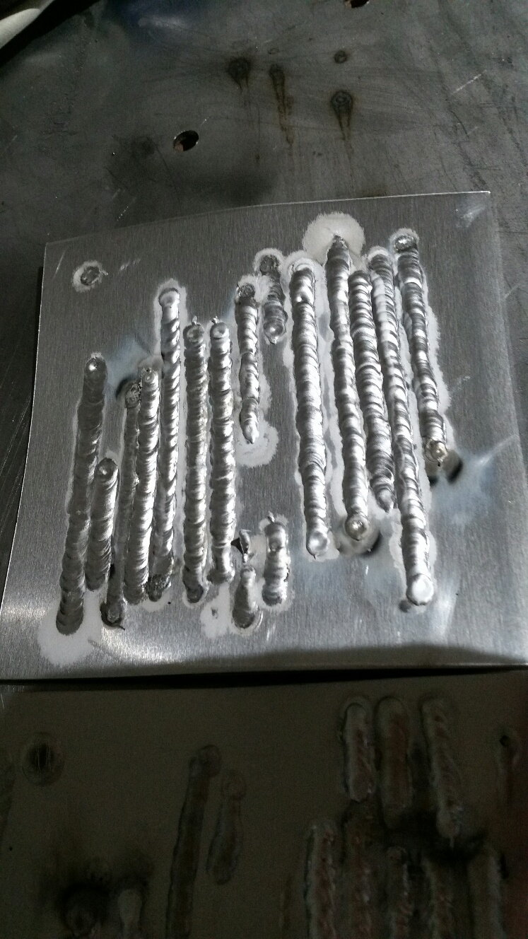

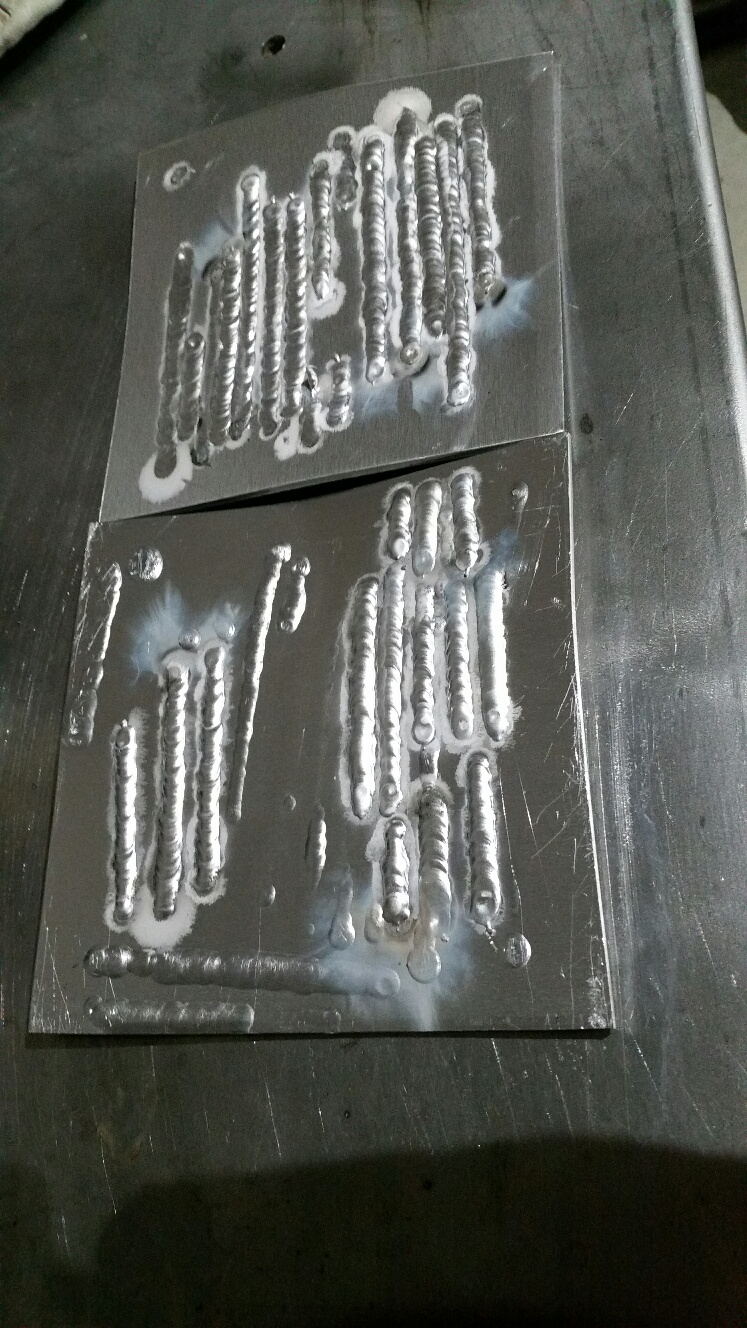

Yes max to the dial setting. At first i tried to have a higher max setting (than with the switch) then drop down but its awkward as my bench is so high my foot is not comfortable on the pedal.Well done so the pedal works then. Dose it max out on the current you set on the dial.
You don't want any more current on the pedal than you set on the machine. That gets confusing. You can use your pedal just like a switch and set your current to your metal,thickness, joint and max it out.Yes max to the dial setting. At first i tried to have a higher max setting (than with the switch) then drop down but its awkward as my bench is so high my foot is not comfortable on the pedal.
