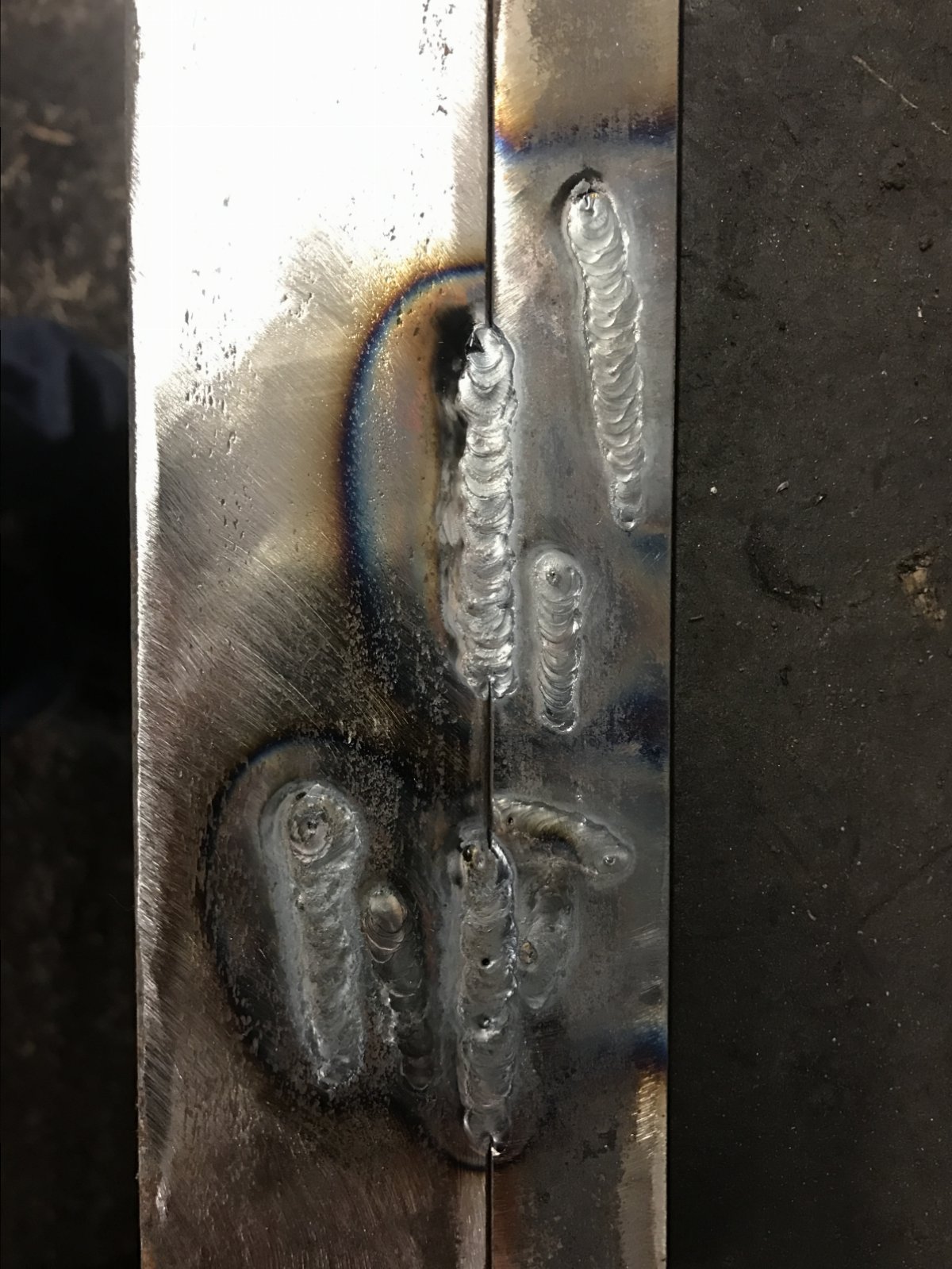

Deano half the reason that's not so visually appealing is simply down to the fact you didn't use filler.
On mild steel it doesn't work. You need filler to deoxidise the pool. Without it your gonna get porosity like what you show in the pic.
Use filler rod and things will improve.
