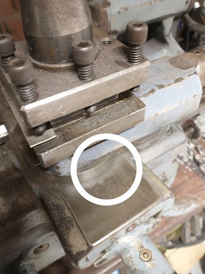

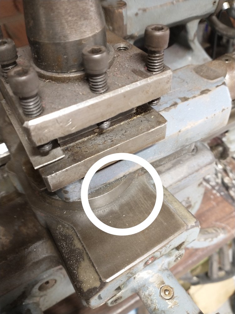

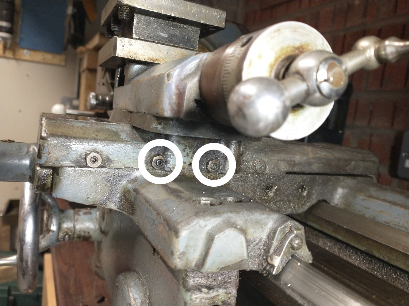

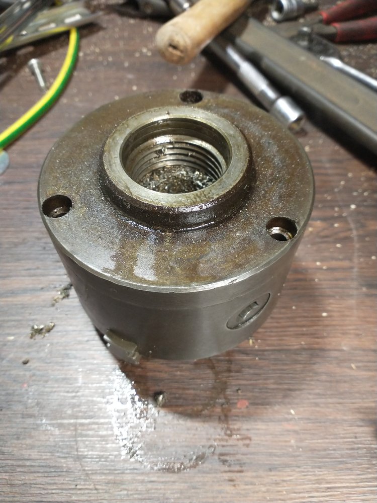

Those are the things I mean.Just loosen the screws a few turns to release the tapered plugs which bear against the conical spigot on the bottom of the compound.
