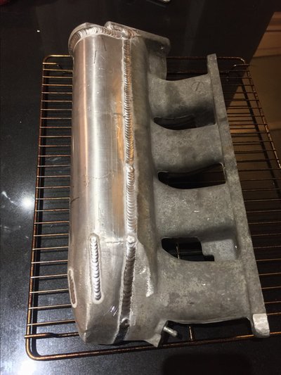

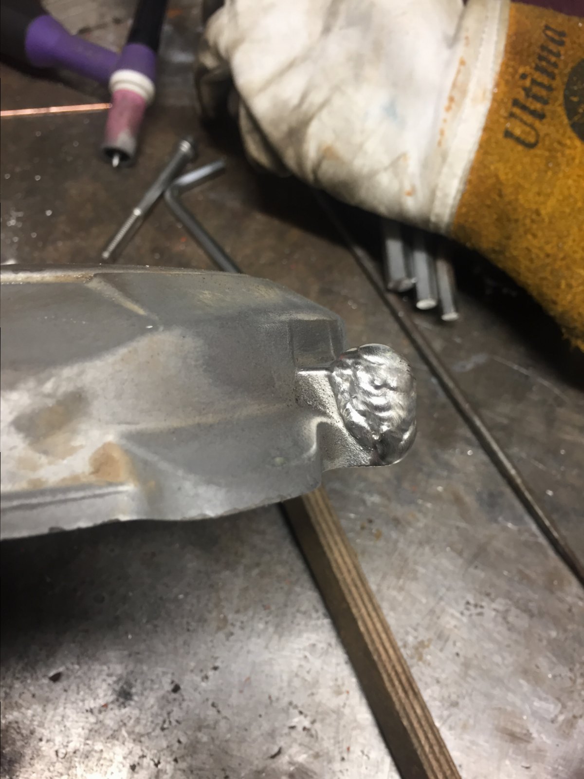

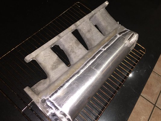

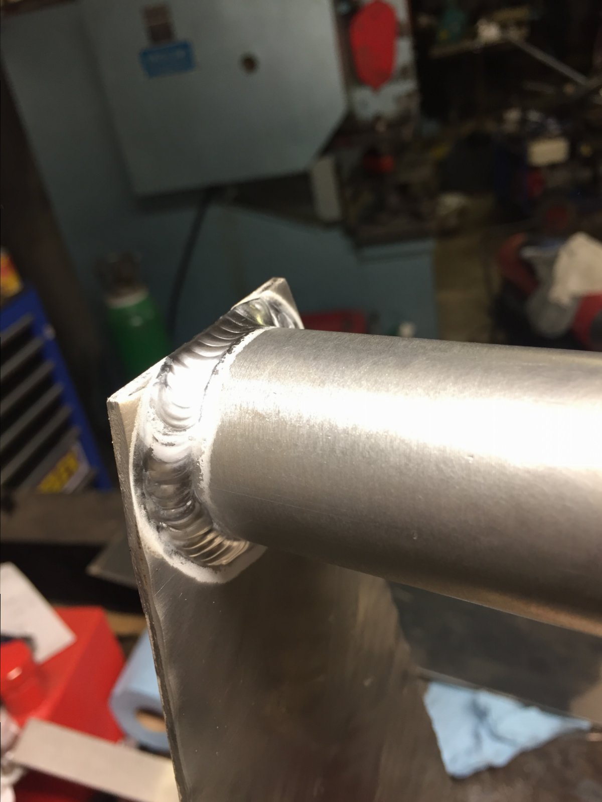

Could of done with some 1/8th tungsten and a lot more pre-welding cleaning in hindsight, but this is just a first trial.

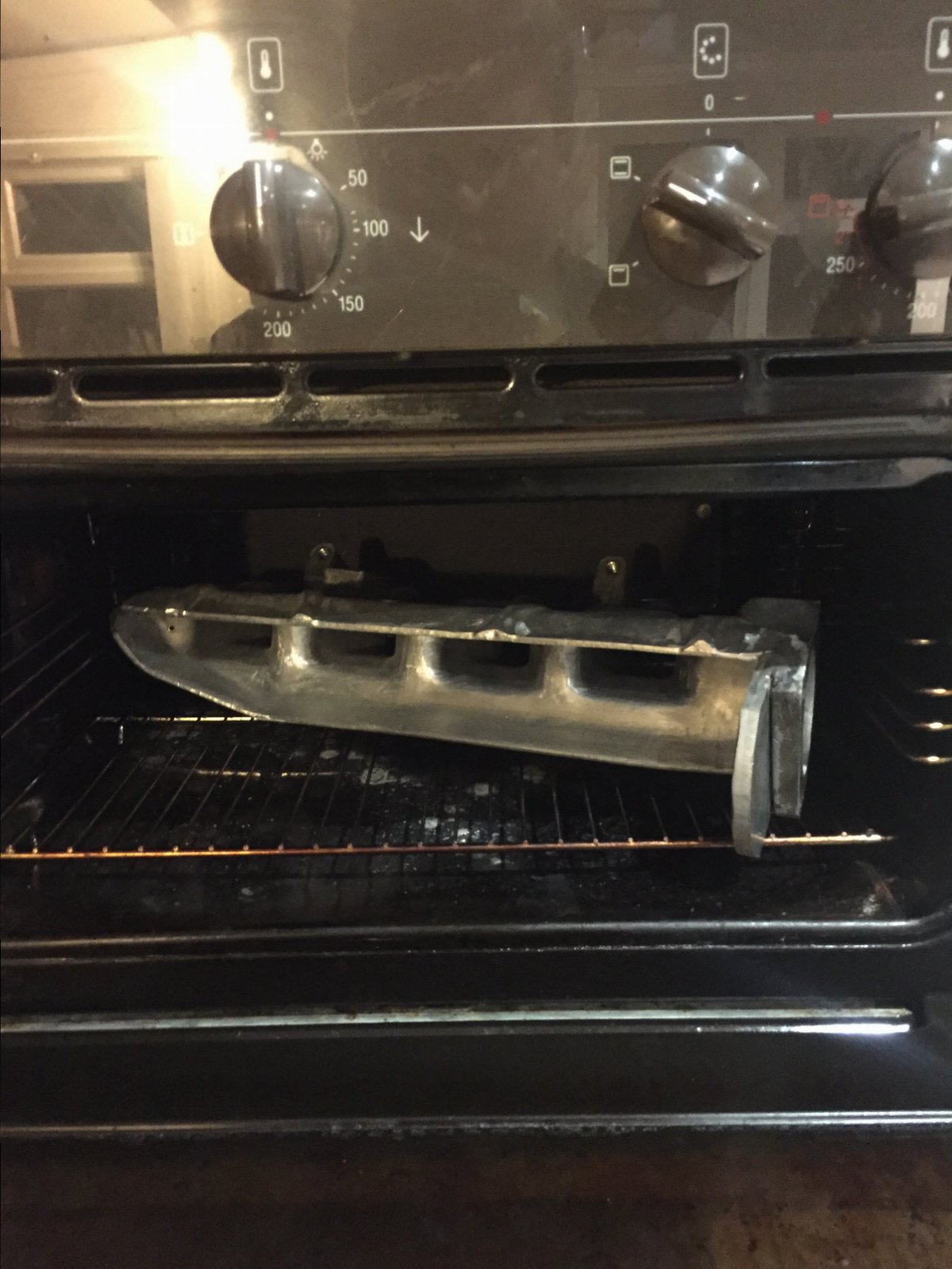

Fabrication not done by me, I just got the part to weld the already shaped and welded plenum onto the cast manifold. Fitup wasn't perfect so I couldn't put too much prep in. Would have preferred more penetration but I maxed the little handytig out with 120 degrees of preheat out of the oven.
It's for a Mini Cooper s
