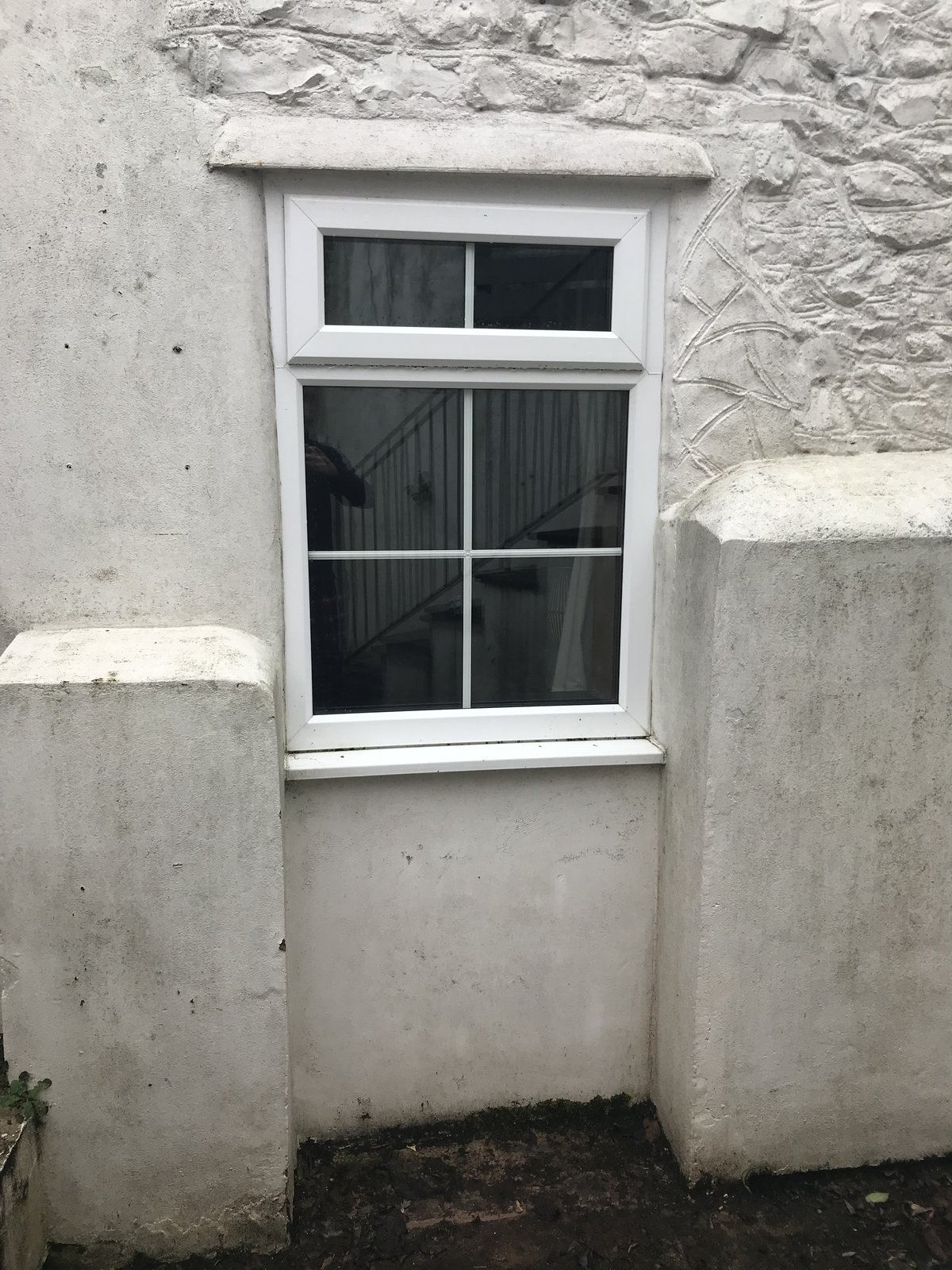

    I plan on re instating an exterior door where there used to be one many years ago (before I lived here).
    That rooms going to be the new kitchen and the other half would like a stable door of some description in there. The issue is the current window width is 800mm and the supporting buttresses you can see either side will prevent the doorway being widened any more without substantial further work.
    I looked into a UPVC option and with a door frame thickness of 70mm either side I’ll only end up with a 660mm width door - which is very narrow. I gather a standard timber frame size would be 50mm so if I went for a wooden door I’d get a teeny bit more width in. Is there anything else you guys can think of? Obviously this door will be internal opening, can wood door frames be shaved down further? Could I have the frame recessed into surrounding wall at all?

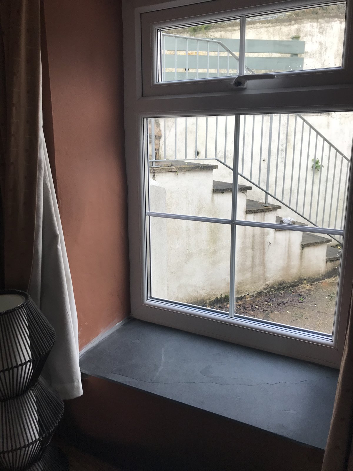

    This is the inside
    Relatively thick wall.

    still saw cut the buttress back till you can fit a standard door otherwise all you will be doing is bashing yourselves on the tiny door spilling hot things etc

    Can you work out how wide the lintel is ? ....That determine how wide you can make the opening ...

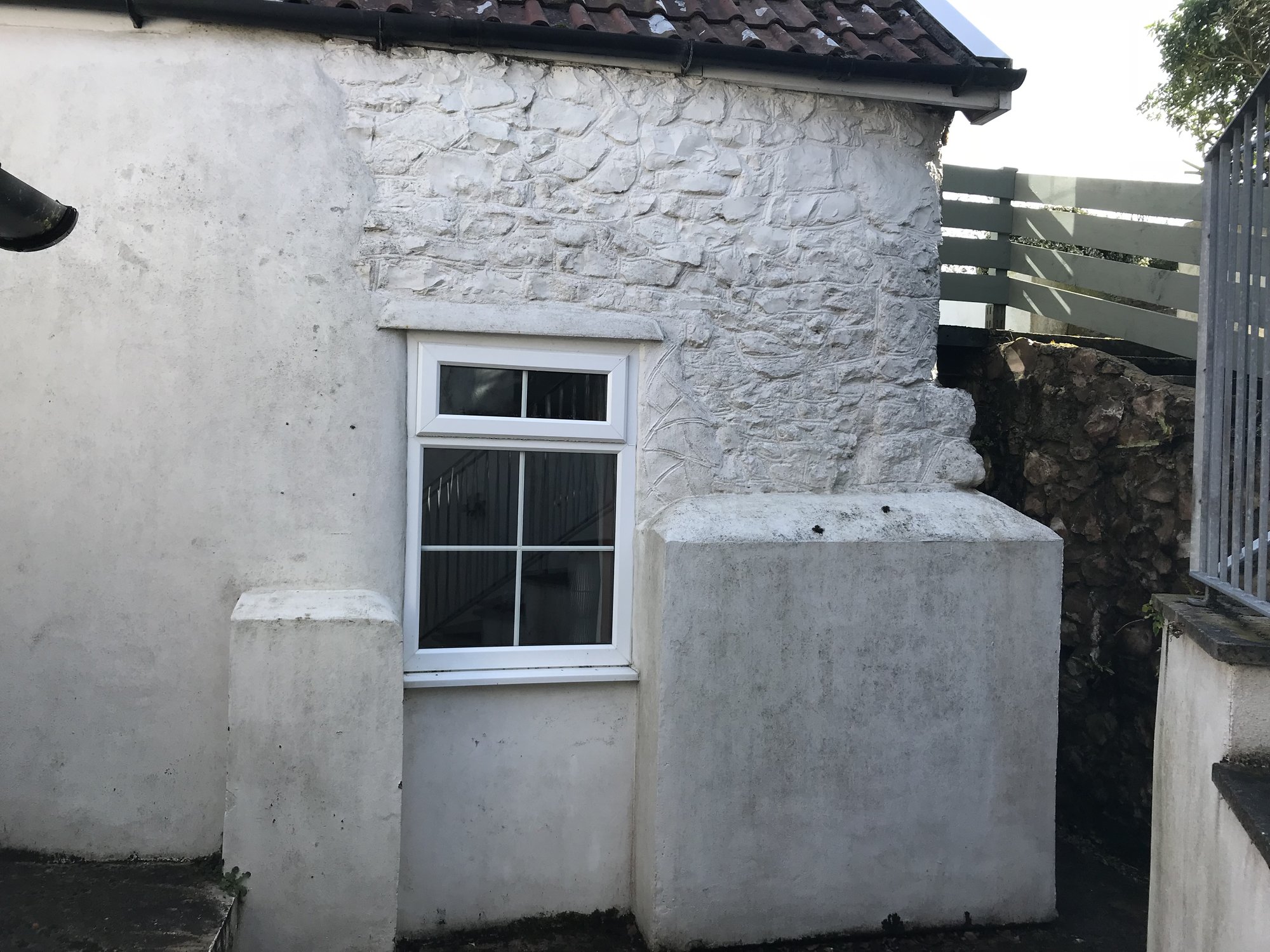

    could you put some wider pics up as not showing some more detail to point you in the right direction
    if your going to do a door make it to the proper size no point doing half the job
    smallest door you can buy is 27" and 24" after that there made up

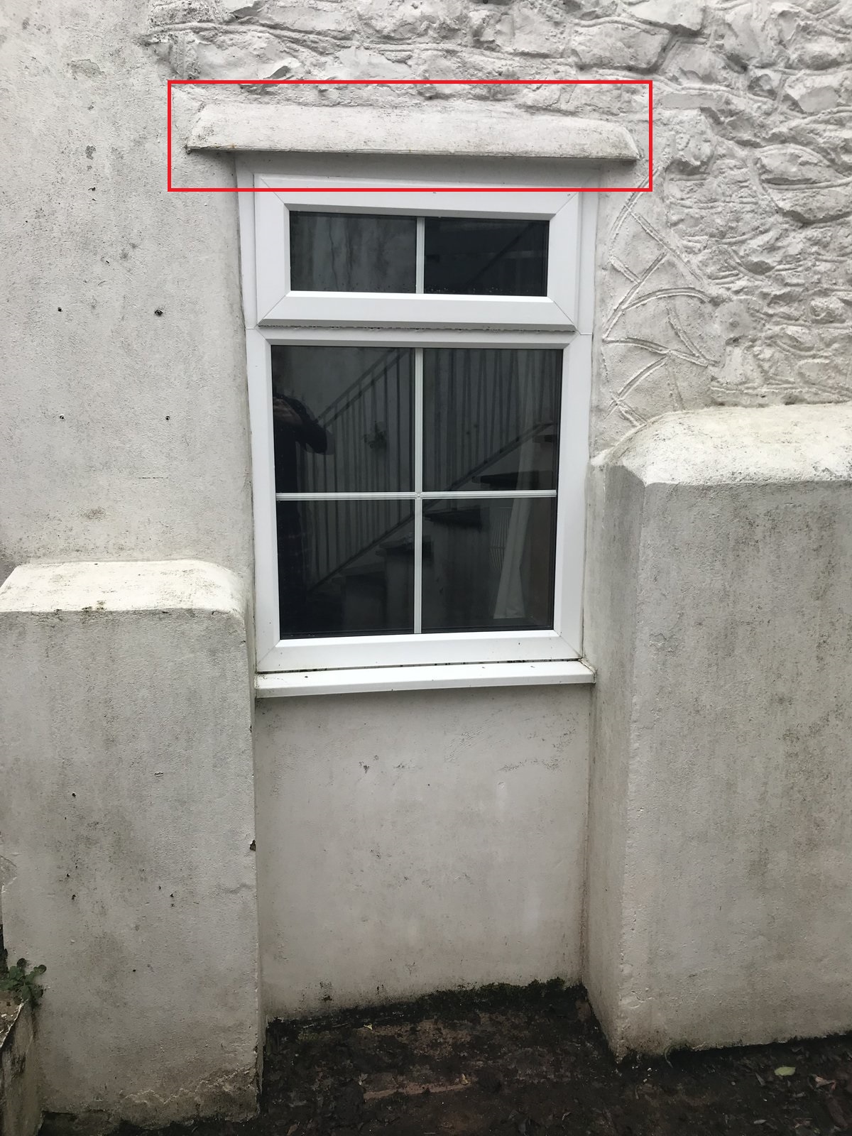

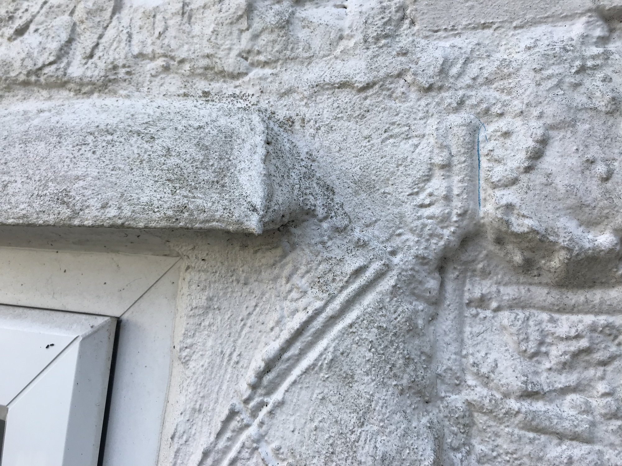

    So I can make out one side of the lintel (i think) - see pen mark
    Can make out the other sode as it’s under render but the measurement from the left edge of the window to the right edge of the lintel is 1000mm. I’d guess there’s another 50-100mm on the left under the render. How much does a lintel need to be lapped into the wall by?
    And here’s a wider shot as requested

    The recommended overhang each end is 6" (150mm).

    its not carrying much weight on top id open it up and make a proper door of it
    old too new didnt exist in them days wood lintels was used many times over
    take note what you see maybe all the lintel is

    Hi, On the right hand side of the window, where the criss cross finger marks are, looks like infill to close the gap for a smaller window. So can you attack the external infill and rendering the other side to find out what is the original wall and what's infill? If that part of the building was originally an outhouse or coal cellar then it may not have been a very wide door to start with.
    Colin

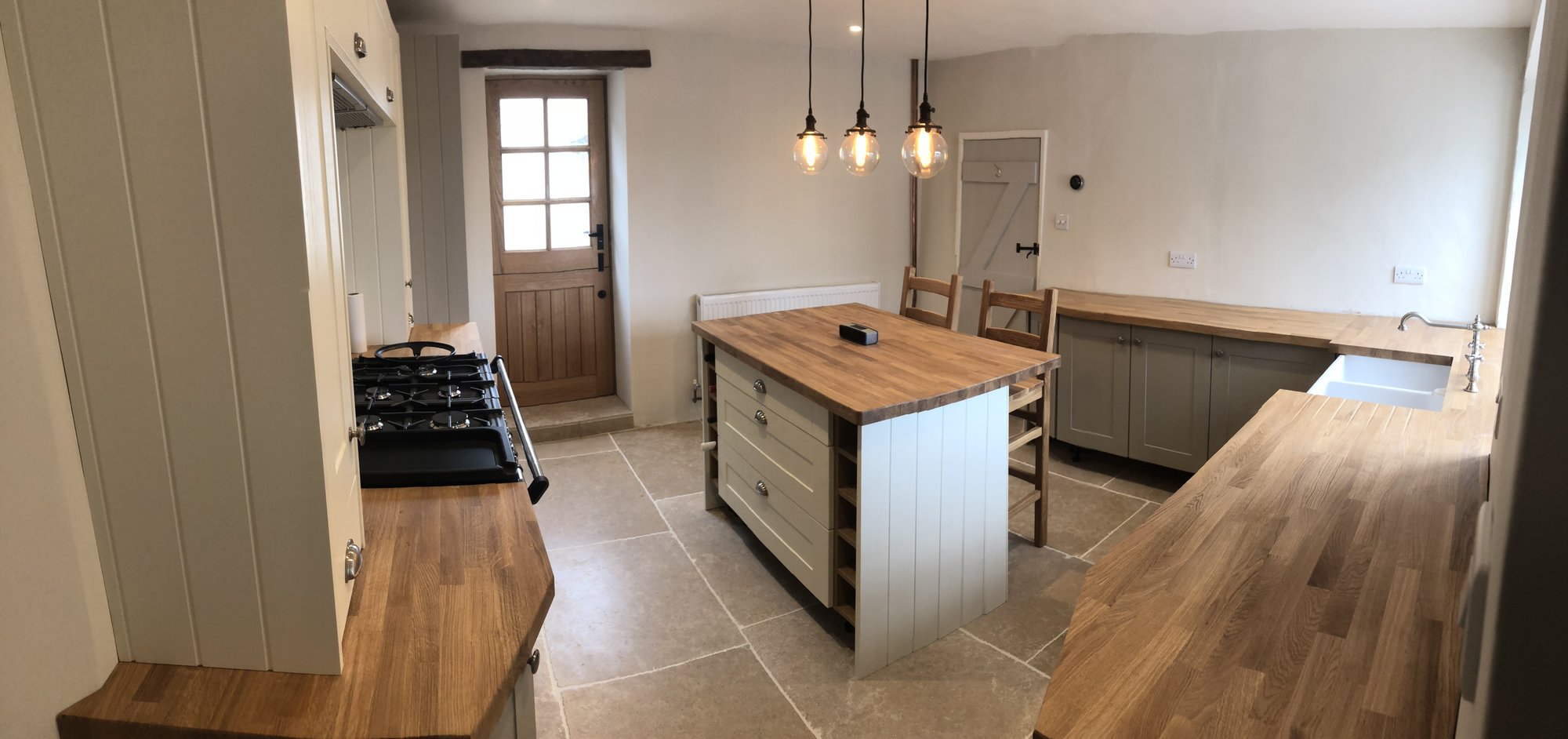

    Update.
    Got the bloody stable door in eventually, when widening the doorway the old flint was coming away in chunks so had to get a bricky in to sort it out. Ended up costing more to fit it but the door was substantially cheaper than the UPVC one we almost went for.
    Managed to recycle a 300 year old piece of oak as a pretend lintel too!

    Nice, my wife would very much approve of your styling.
  19. slim_boy_fat
    slim_boy_fat Forum Supporter
    And it looks SO much better than UPVC too!! :thumbup: My observation on UPVC is that the surrounds always look 'chunky' and steal a good bit of the opening, presumably because of the locking mechanisms etc.
    Nice touch on the 'lintel', btw! :p
