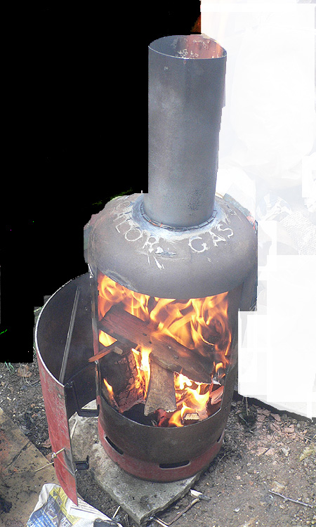

My latest thinking on a cost-effective flue is to try flexible aluminium ducting. These stoves may get hot but I doubt if they get hot enough to melt aluminium, even if the ducting is designed only for cooker hoods and tumble dryers.
Pound to a penny it melts try throwing a coke can into the fire and see what happens the alu flex is not very thick if you are going to use flexy make sure it is stainless and keep it well away from any combustable material. p.s. if you are burning wood you will never be away from that stove.
