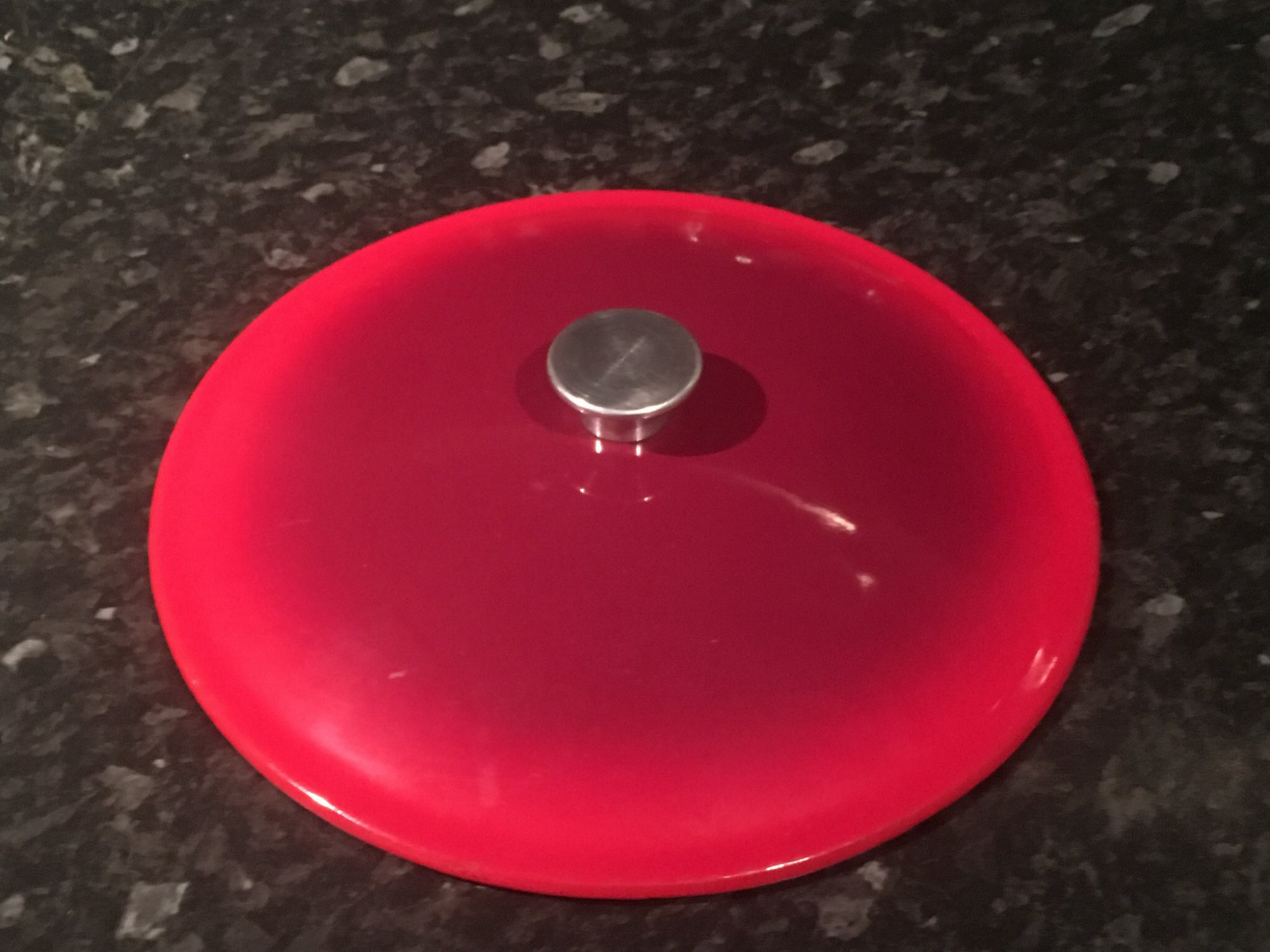

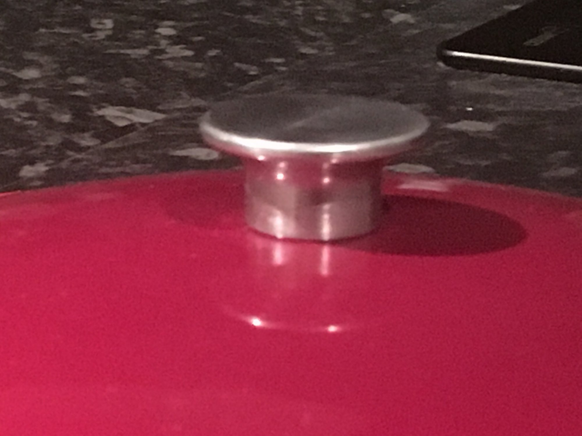

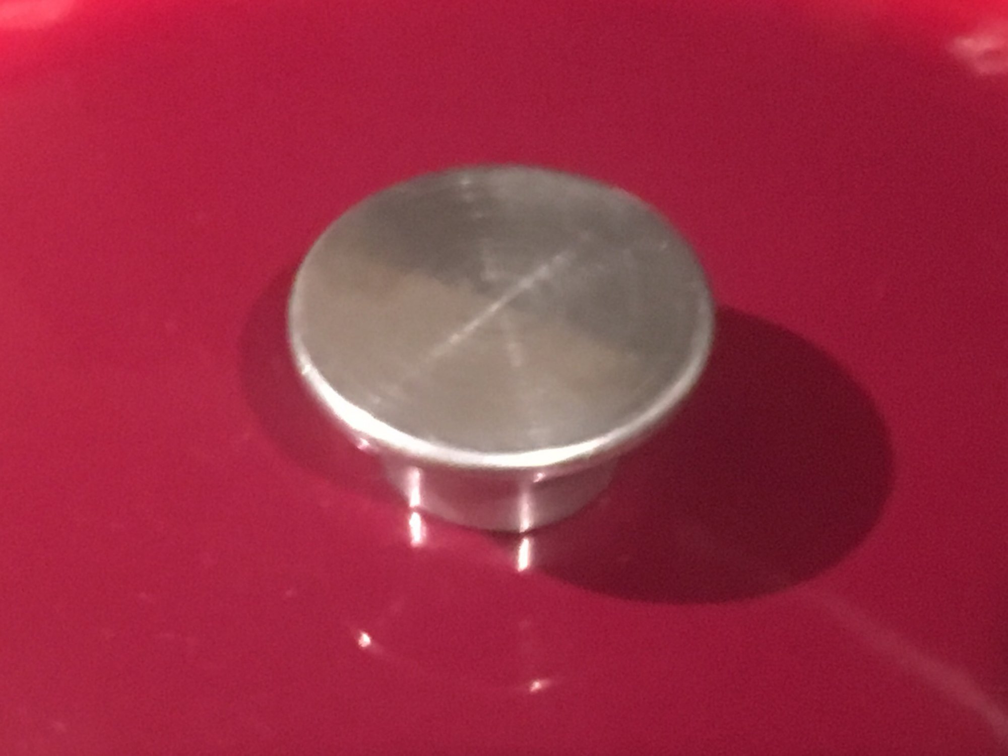

I love to fix things. Every time you use that lid you will look at that and think I did that. Well done.ive put it in this section as my kitchen is also a Worksop that creates ........... Edible things
My Favorite cast iron pan has suffered with broken handles, no matter what you buy they don't ladt long. A while back I saw a set of similar pans with aluminium handles, so I had a go my self.
It was my first solo lathe project, after a bit of phone consultancy with dad I ground some HSS with a bullnose front. To complement the only other cutter I have.
I turned down the shank with the bull nose then adjusted the to slide at an angle to give me the chamfer I wanted. This wasn't to a dawing, just what looked right by eye.
I then centre drilled, drilled and tapped M6 for a SS pan head bolt.
Faced it off the made a little dished recess to accommodate the curve of the lid
Didn't have a parting off tool, so I cut (with hack saw) the half formed section from the bar so I could hold it the other way round.
Used some very thin copper sheet wrapped round the mandrel section of the handle to hold in the chuck
Faced off, rounded edges with a file and made a slight dish in the visible part of the handle.
Cleaned off with some wet n dry then quick rub with a garryson block followed by a quick buff with a cloth mop mounted in my wood lathe
Not a complicated project by some of the work ive seen in here, but complicated enough for me as a starter
Here is the result
View attachment 102856 View attachment 102857 View attachment 102858
And yes, before you all say, yes it's going to get hot, but so did the crappy plastic ones, so I'm in the habit of always using some hot pads
