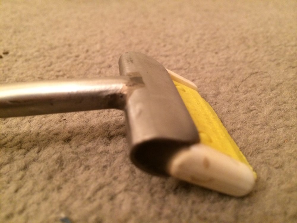

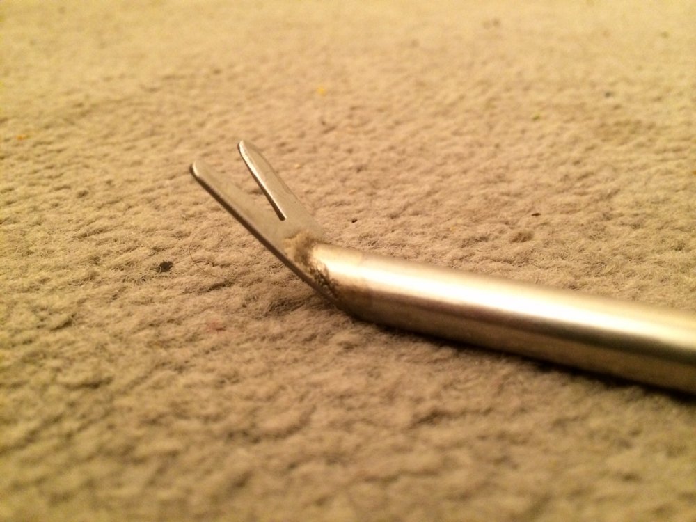

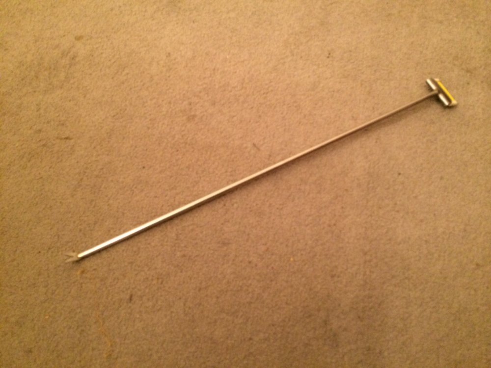

Used the shop bought rubbish as a template to give me all the angles I needed then cut out stainless tubing, fork and blade holder. I had no way of holding the razor blade so used the original plastic housing in a stainless carrier and copius amounts of resin based adhesive. All joined together with silver solder as I don't have TIG. polished everything up and it looks and works a treat. Added bonus is that I've been able to keep the length of the tube to suit the depth of my tank
