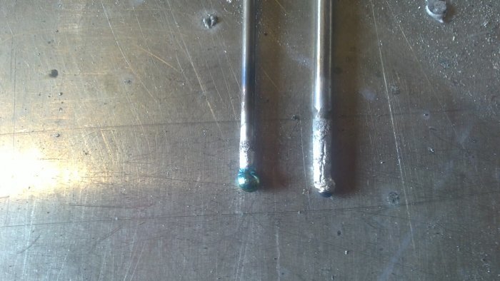

My experience with aluminium welding is limited, therefore the need to weld up my ali frame bench at home has been good for the chance to experiment.
I have used my AC tig at work on ali with some ok results. Unfortunately at home i currently only own a dc tig inverter (Clarke Tig150). The manual for my inverter gives the impression that it has the ability to weld ali when it states "Welds all metals. (Except aluminium - Tig130) I have a Tig150 so naturally you would think...... Unfortunately my machine has no AC option and the manual has no more information regarding welding ali, so I have never bothered to try welding ali with it (Maybe I should email Clarke)
Anyway, as some may know, I have played around with Mig welding ali, (http://www.mig-welding.co.uk/forum/showthread.php?t=32416) with some success on the first day, but still unhappy with my overall setup. I tried again yesterday, but got frustrated with the birdnesting leaving me now to consider a spool gun.
OK, rolling back to my point.....I brought some ali tig rods from work (sifalumin 15). Checking the specs online: http://www.weldability-sif.com/pages/view_product.asp?product_string=RO155025 in the PDF document it states Current: DC =+
I thought DC =+ means electrode positive
please correct me if Im wrong

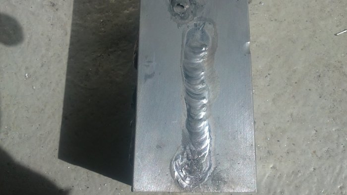

So... experimenting with this Ali malarky, I pulled my tig out for a play. First tried with DC electrode negative and got exactly what I expected black/grey porous snot. Then swapped leads around, torch positive (according to the welding rod specs). I halved the amps to what I would be using for AC and surprisingly I got some pretty clean welds. Only issue was the tungsten melting away, which I was expecting to happen, but it lasted long enough to allow me to run a bead which looked as clean as an AC weld.
Amps : 45
Tungsten: 2.4 white tip - 0.8% zirconiated
Filler: 1.6 Sifalumin No15
Is there a more ideal tungsten that will last longer with this kind of setup?
