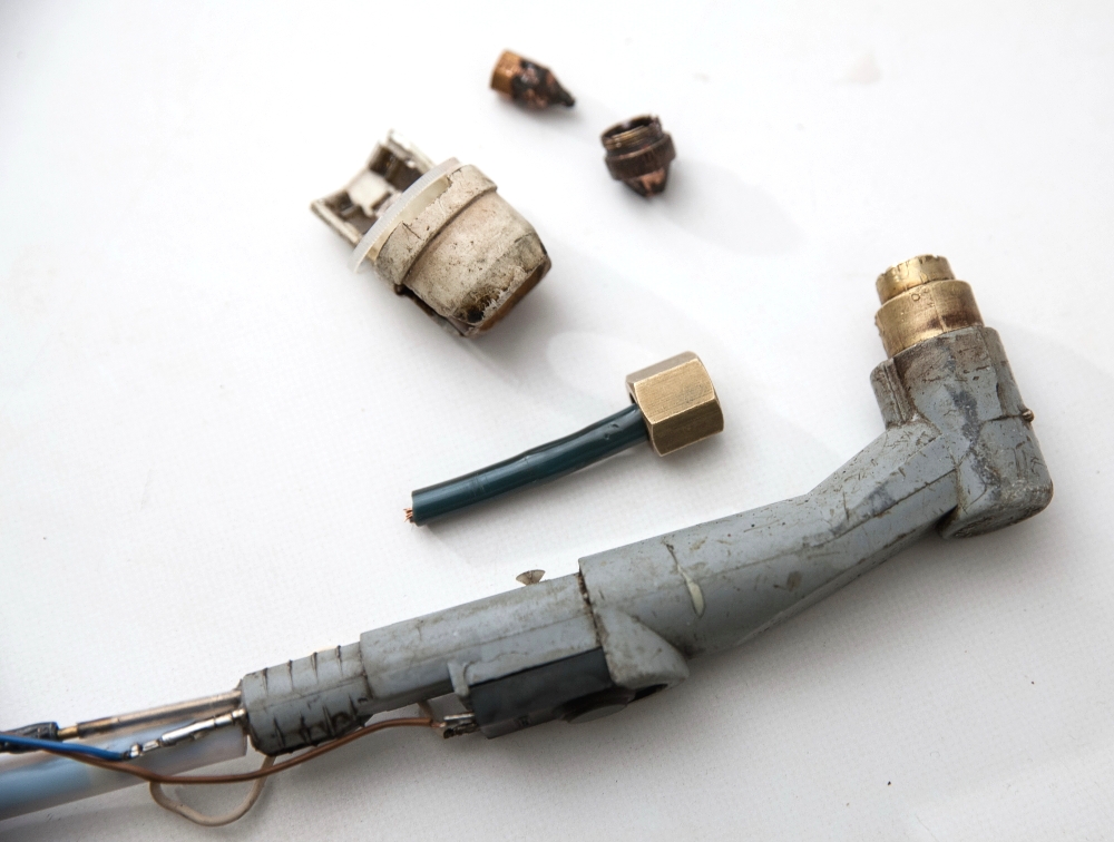

Hi.What's wrong with it?

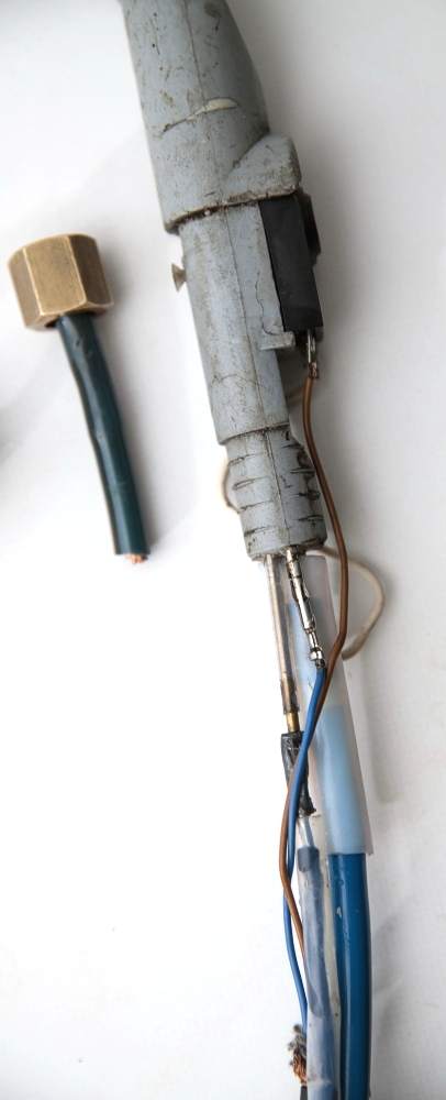

THis photo shows the switch on the old torch.

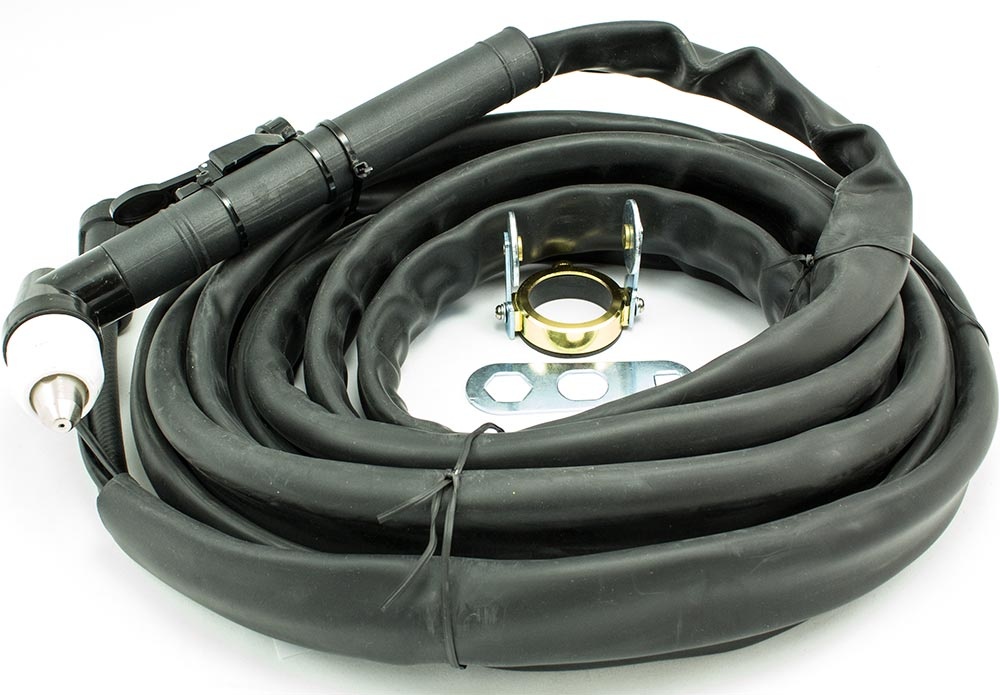

The new torch is
Complete 6M Hand Torch - Plasma Cutter 60-100HF
SKU: P60100-6MHHT
from. r-tech welding. Better picture on their website.
Ta
Worked, just about, with original torch but was too bad to continue and there are no replacements parts.
Can't really help with your new torch.
As for your old torch, the heat shield shroud looks like the one's available at
http://www.weldmet.co.uk/shop/productinfo/7502

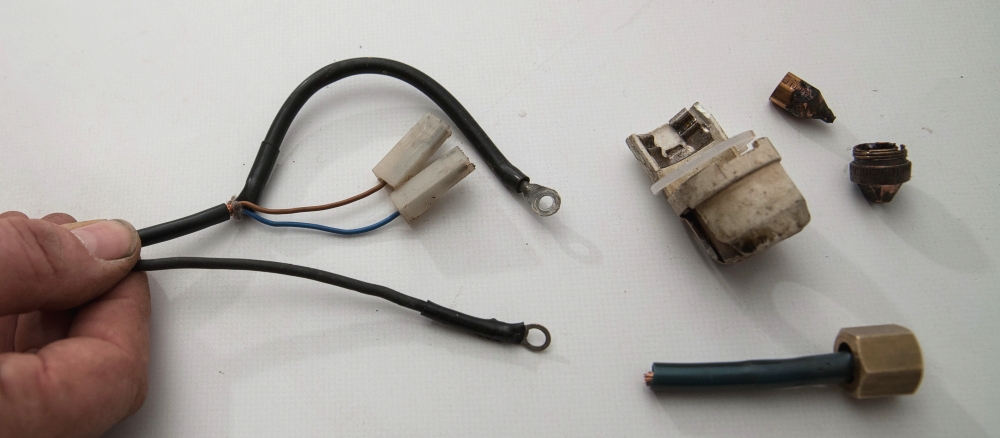

triple/quadruple check the continuity of the two shroud to torch contacts and through the torch body itself. An intermittent fault/break/high resistance, say, due to loose shroud, will kill the arc.
Good luck
Hi. Thanks for coming to my aid.
The only reason for getting this torch was that it was the only one with similar looking connections to the unit.
Two for the switch , one air and feed, and an earth return for what I think is HF pilot arc.

As you can see from the picture, all I had to go on was the three tubes you can just make out on the left of the picture emerging from the covering.
The only problem that I had with the old cutter was the state of the tip and elctrode, and not being able to replace.
Your link looks like they might have them, certainly the shroud is right and the electrodes look right, but with no picture of the tip, I will call and get some and hope.
Took me awhile to figure out the two pins on the torch were important!.
