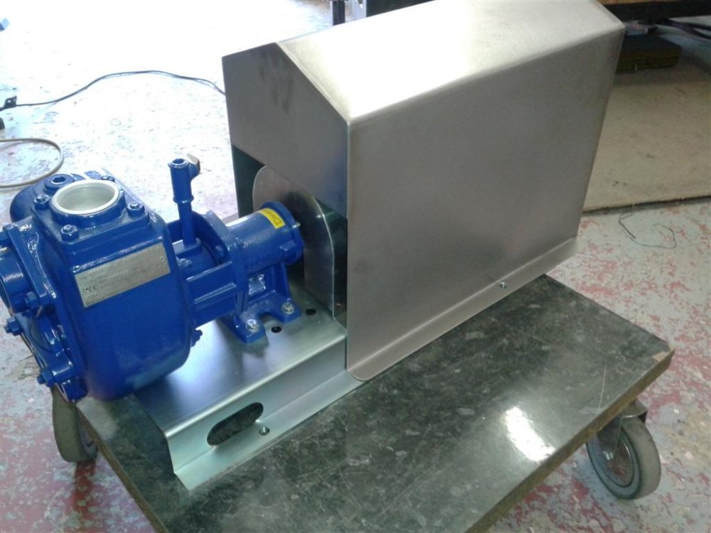

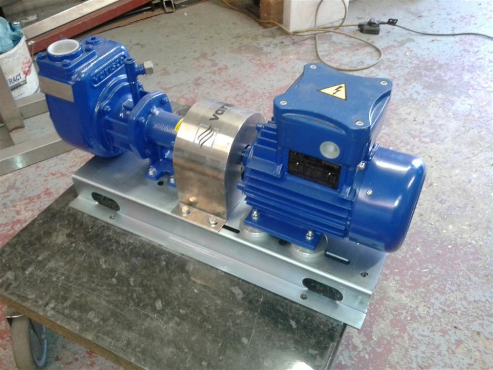

A little sheet metal job, this pump is going to live outside inside a bund so the customer wants to protect the motor from the weather, so a stainless cover is required,

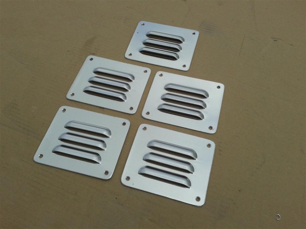

It will need to breath so made some pressed louvre vents on the flypress, these are 2mm aluminium

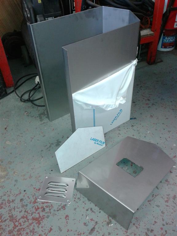

The component parts, bent up ready for welding

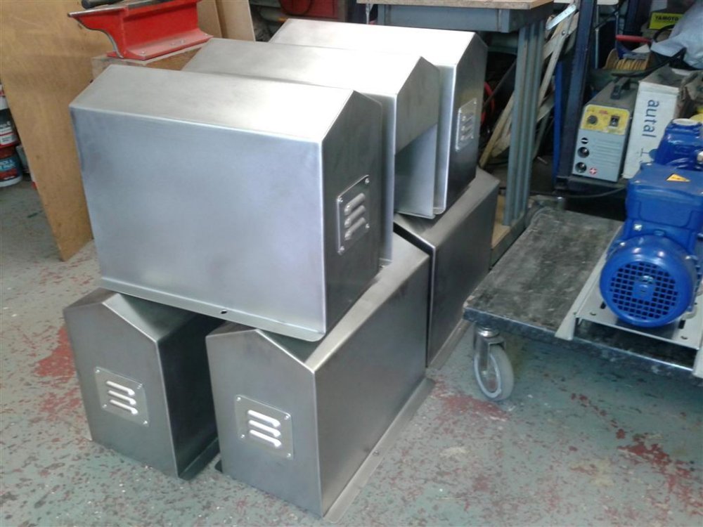

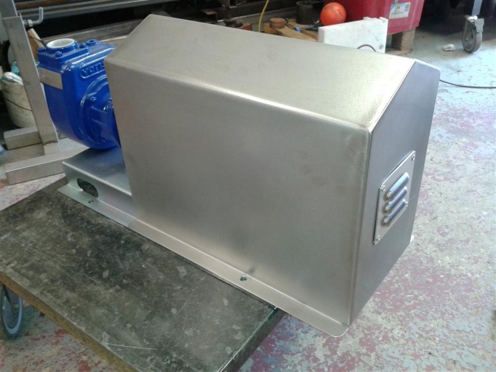

And the finished item, welds cleaned off and just run the DA with scotchbrite over the outside to clean them up.
What was extra nice is that there is seven of them,
