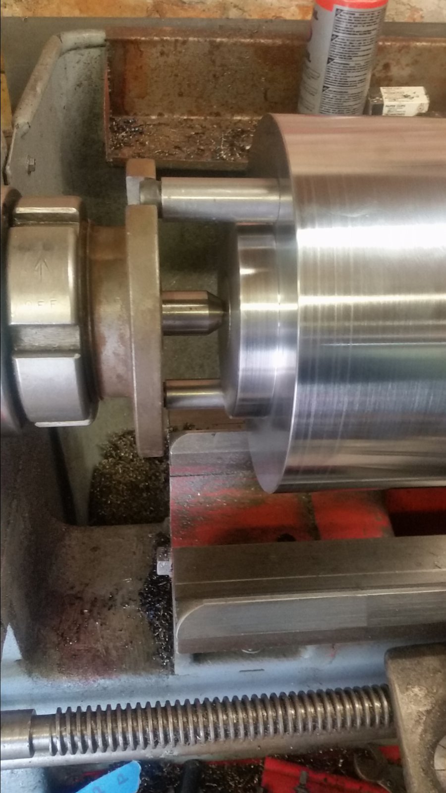

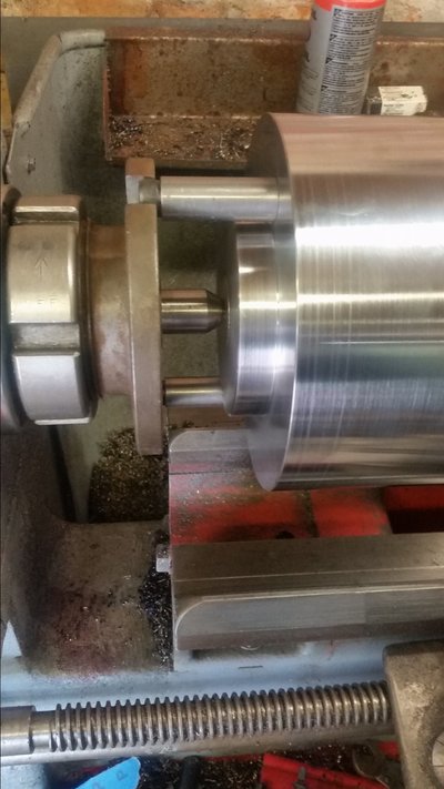

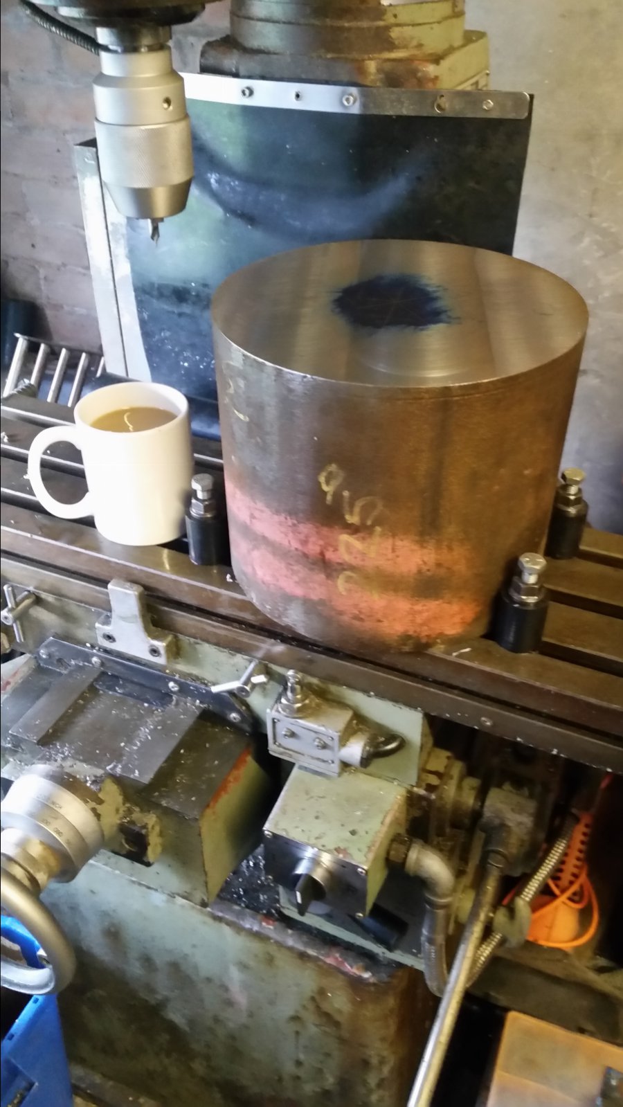

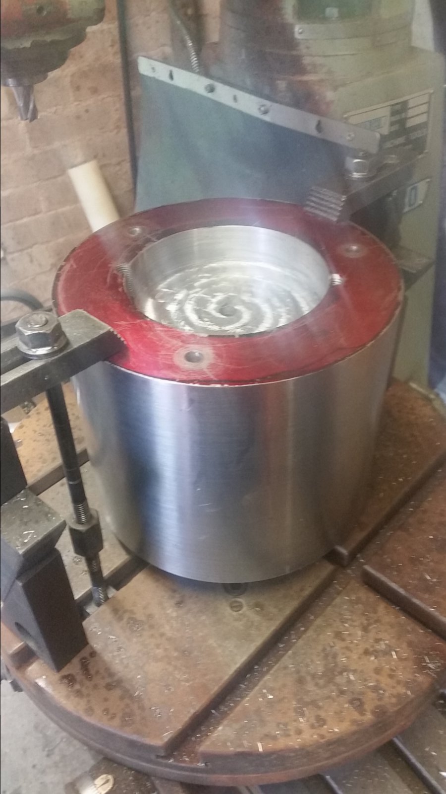

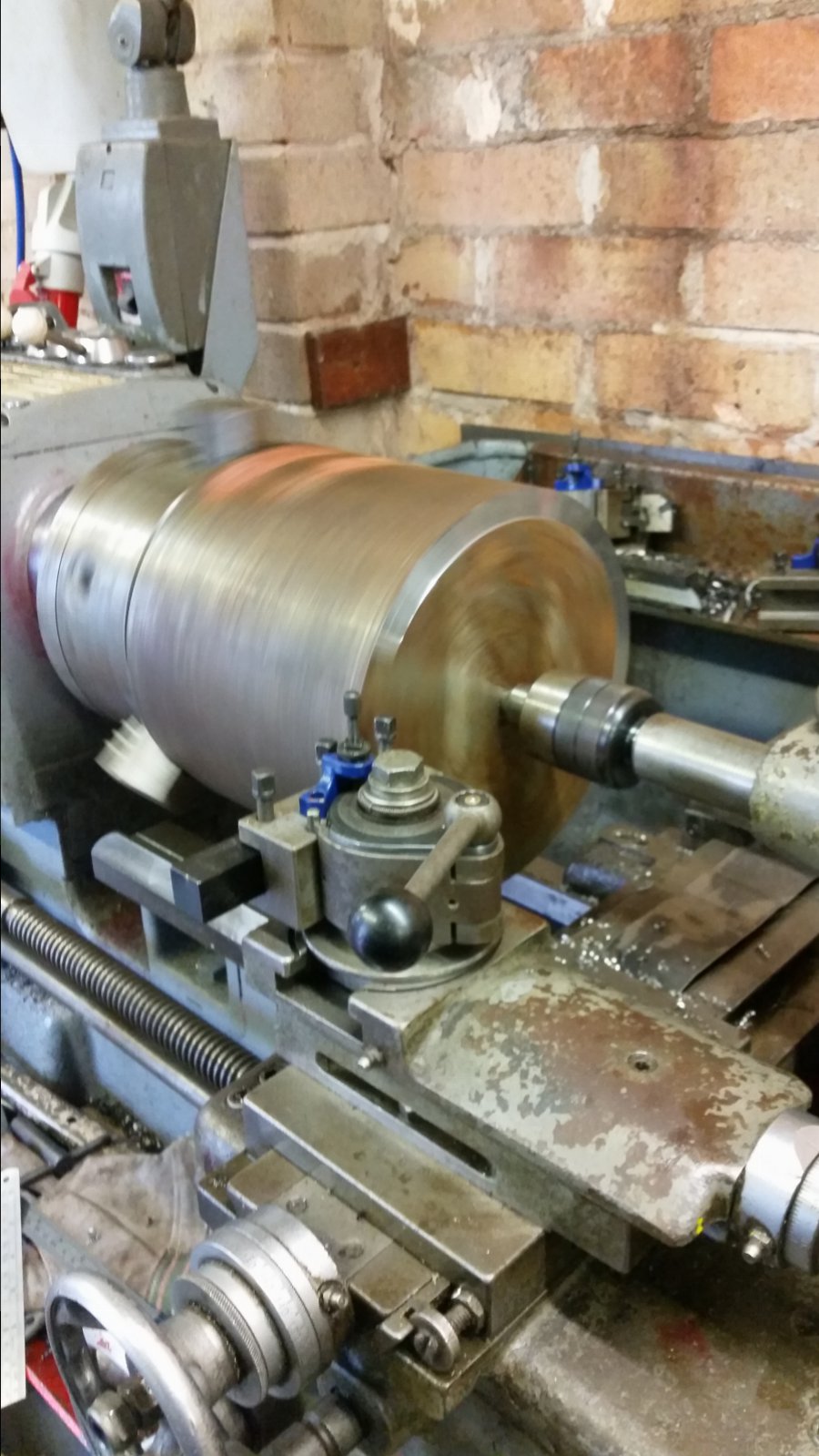

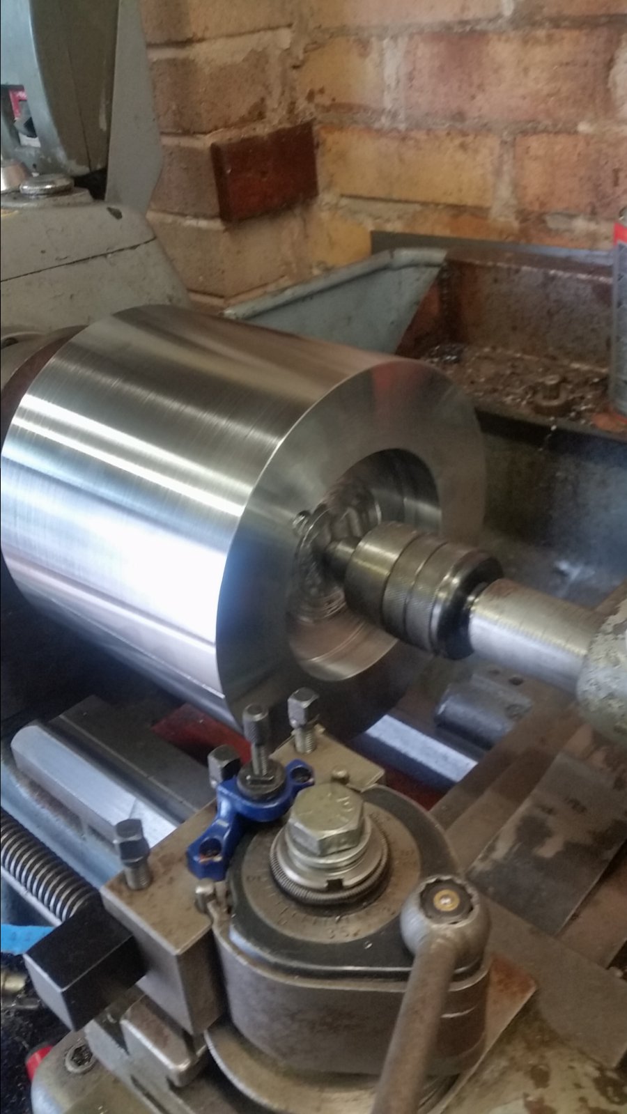

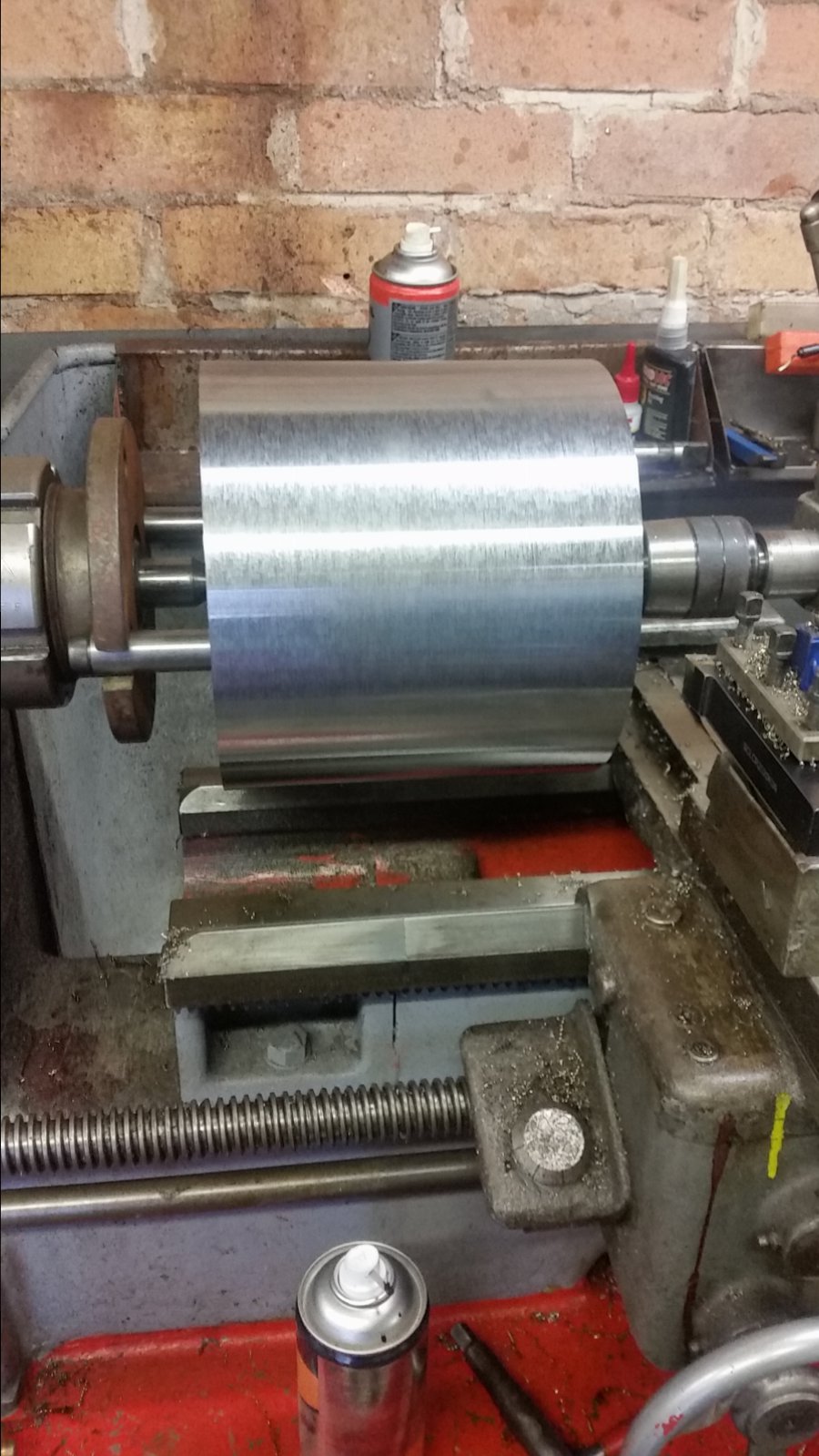

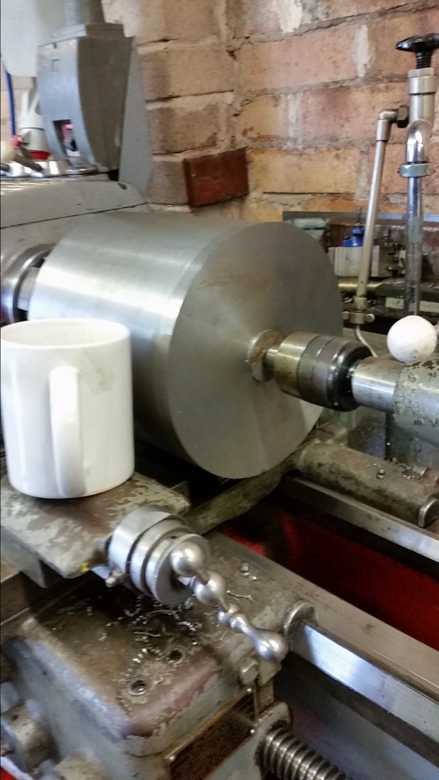

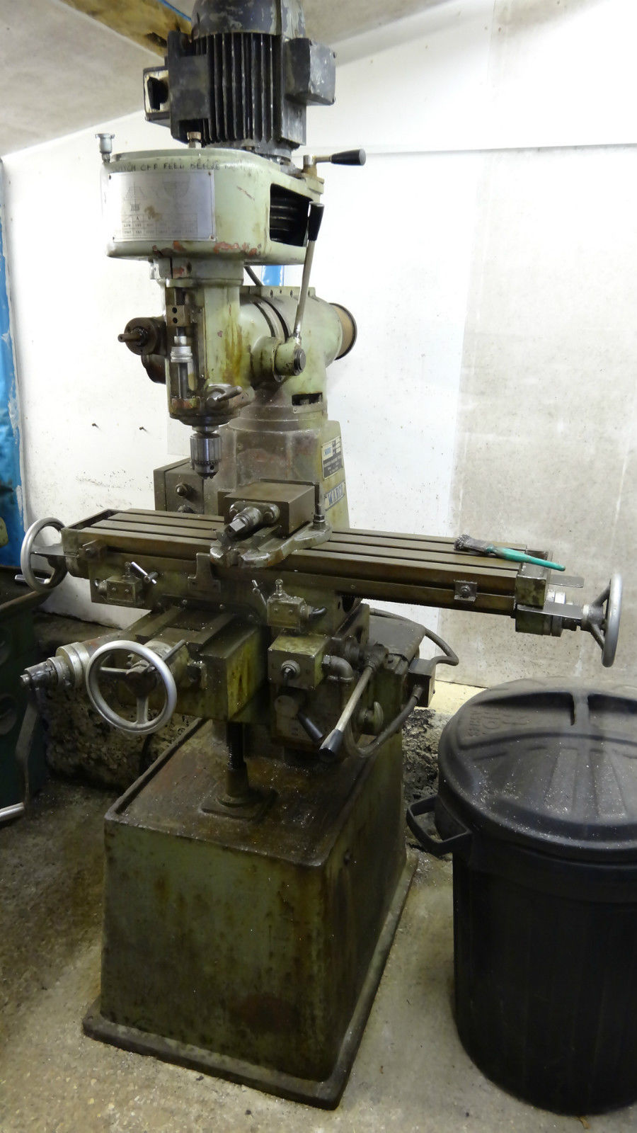

It's about time l started this project the material has been sitting by my mill for nearly a year, now.
The finished extension spacer will be 7 3/4 " diameter by 8+" high approx.
This maybe a fairly long project due to available time on my part anyway here gos, the first stage was to reduce the initial bar stock diameter from 9 inches to 8 1/2 inches so it would fit over my lathes carriage.
