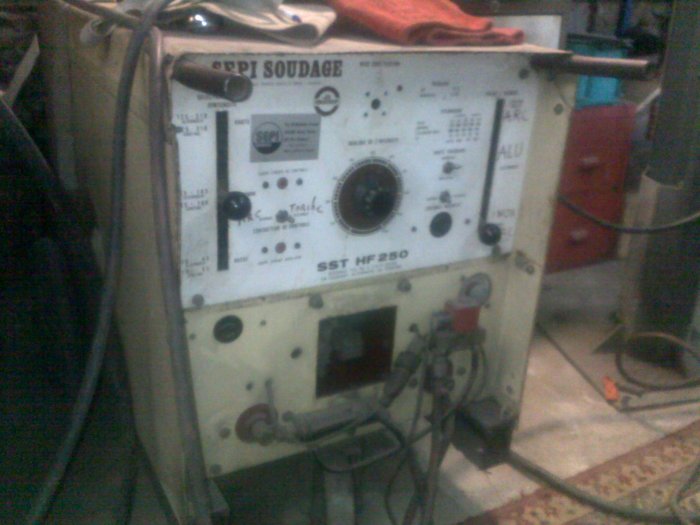

Evening all, I bought last week a Miller SST HF250 which I assume stands for 'solid state tig high frequency 250 jobee' when I went to buy it, it worked but kept on tripping out the chaps three phase, seeing as it worked from time to time I bought it, since this I have played with it, and to cut a long story short, it turns out it works fine sometimes, and sometimes it just trips out everything, this is due to the main Power switch having one grilled contact on the two phases which supply the transformers etc.
So my question is where can I buy a replacement 63 amp 500 volt two phase on off switch. Thanks in advance. And then when I have a bottle of pure argon I will depress you with my learning. Once again thanks in advance. Mat
Photos to follow, probably tommorow.
