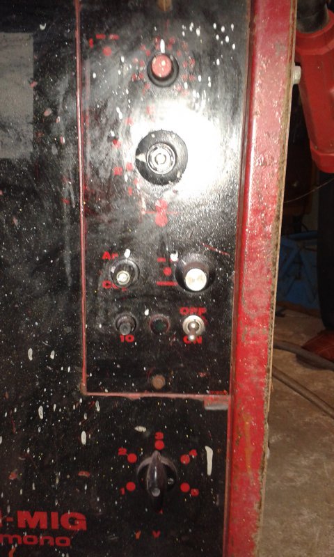

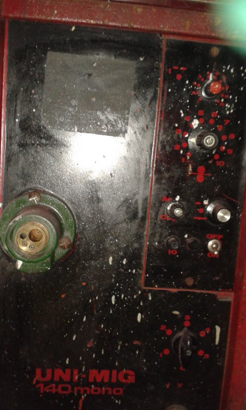

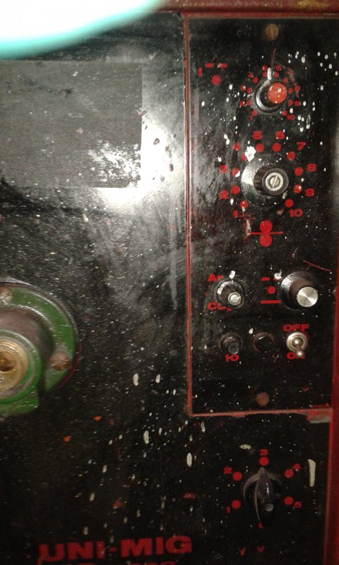

hello guys after being told last night this is a migatronic 140 mono me after more help and advice so wondered what all you guys can offer in advice as looking to restore it to be used
thanks andy
You don't need to weld to test the stitch. Just set it up to the settings you want and press your trigger, if the wire feed stops and starts periodically then you know it's working.
Yea, it should pulse on/off. When you're testing it, turn the stitch knob near to minimum just in case it's set to Max and you're not giving it time to cut out.
I haven't found a need for the stitch function and if that's all that's wrong with it, I wouldn't be too concerned

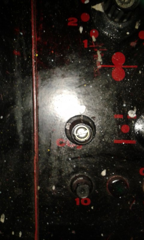

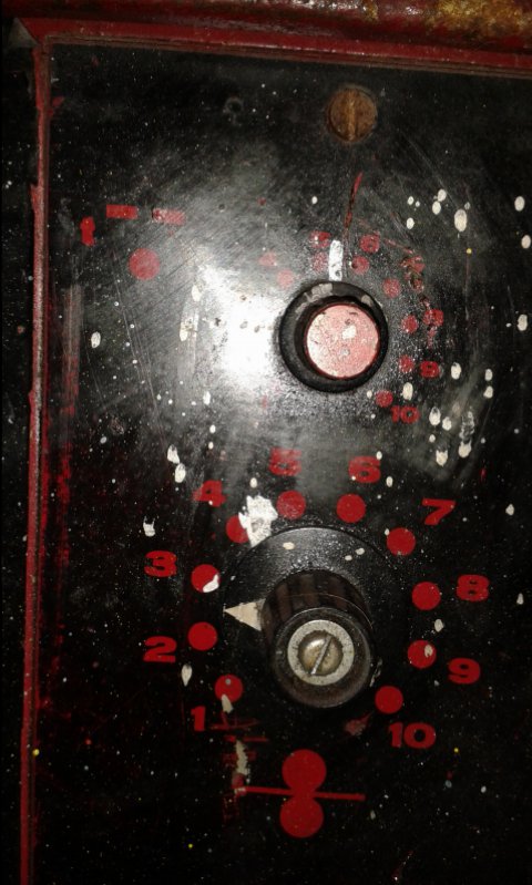

hi guys mode switch fixed but think timer switch not working if I order new switch dose the ohms matter or just make sure if timer switch is liner switch get another liner switch thanks
andy
It's a POT Andy not a switch!
You are posting in two different threads on the same machine !!!!!
Please stick to one.
Yes the Ohms matter it's ONLY a POT It's better if you can match the type LIN or LOG assuming it say which it is on the back.
Something like these http://www.maplin.co.uk/c/component...otentiometers&sort=&page=1&productsPerPage=12
