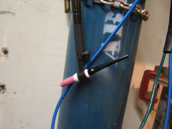

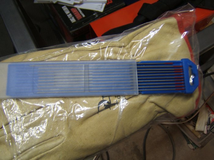

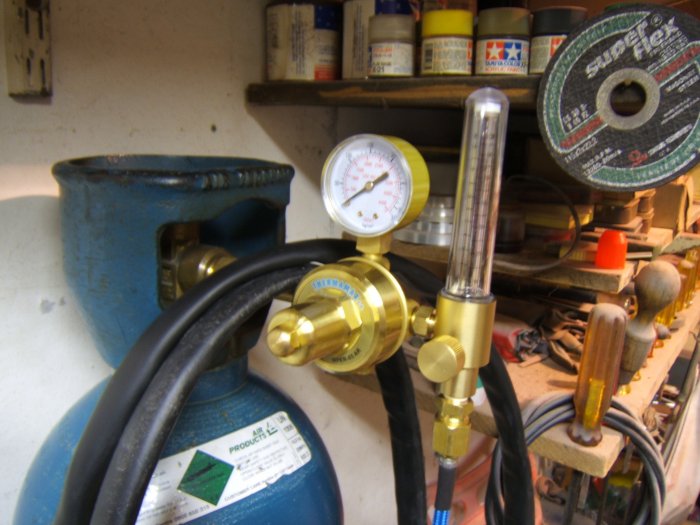

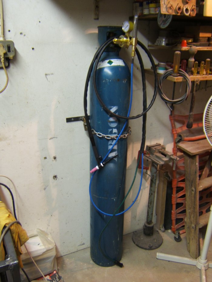

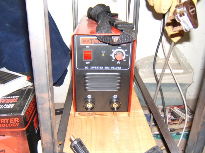

    Hi Guys. I`m new to tig welding and have just bought a Matweld 160 DC inverter welder. It works very well as a "stick" welder and now I would like to try TIG welding. I have got a tig torch,1/16" tungsten electrodes,THERMAMAX Flow Meter and a large pure argon bottle. I managed to source 1 KG of Mig wire (1/16" dia.) to try it on 1" Sq. X 1/16" wall thickness square mild steel tubing. My question is - What amperage should I start with and also the flow meter output flow? I`m aware that the TIG torch is connected to the (-) connection and the earth clamp to the (+) connection. I assume that the most difficult part will be to start the arc,as this is not a proper tig welding machine? I`ve read about "scratch starting",to start the arc. Any advice would be very much appreciated.

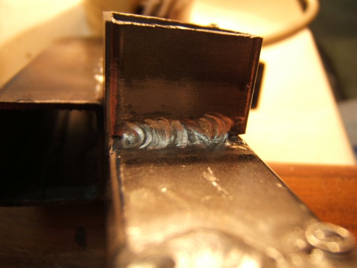

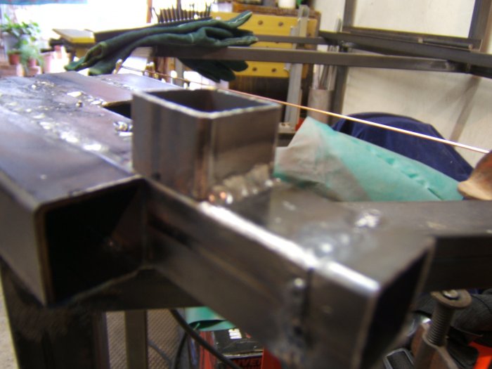

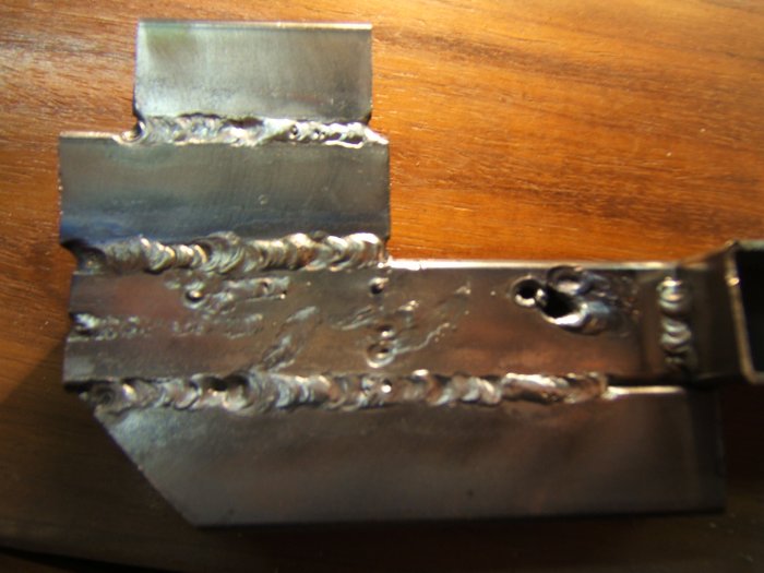

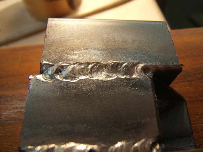

    Today was my first shot at TIG welding and I must admit that I`m impressed with my first attempt. I started off by using 60 Amps and then brought the current down to 40 Amps. The top section of the photo will show the 40 Amp setting. I also tried the angled weld and this was not that easy,because of the electrode cup size. One has to have a steady hand and I`ll get used to that as today was my first attempt. I used a 1,6mm filler rod for mild steel. The material welded on,has a wall thickness of 1,6mm and my first attempt at it,blew a hole in it. One thing which surprised me,was the fact that I didn`t have any problems to start the arc. It started immediately,every time and the machine has not setting for this. I ground the tungsten electrode to a needle sharp profile and even when it was blunt,there was no problem in starting the arc. Argon flow rate - 15 SCFH and inverter amperage - 40 Amps.

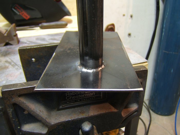

    Hi Guys. I made a holder for my Stainless Steel filler rods. Its a 1" pipe,which was tig welded onto a 1/8" steel plate. This is the first time,that I have welded a tube onto a flat surface. I used a 0,8 mm mild steel filler rod,which was from a 15 Kg mig wire roll. I paid 15 Pounds for the 15 Kg roll of mig wire. It was still sealed in its box.
