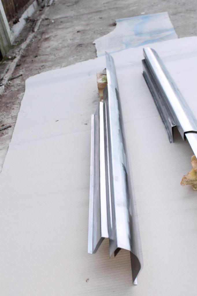

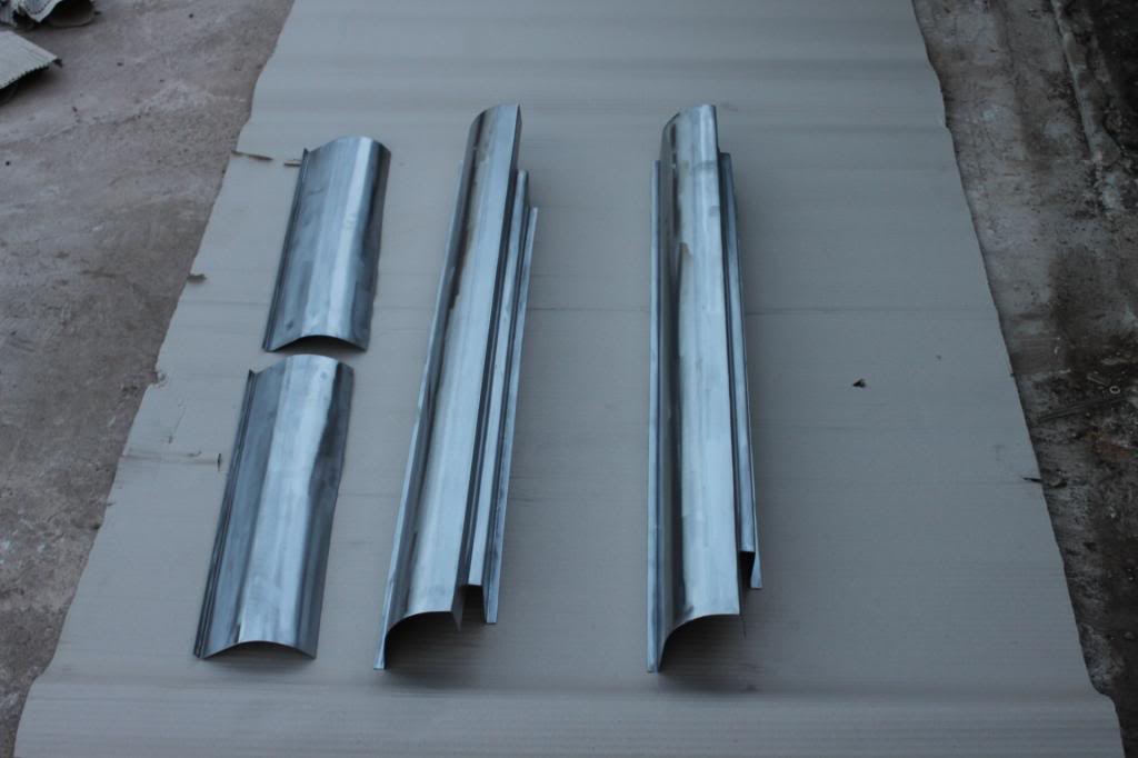

....by hand, over a rigid, round bar (steel scaffold) with lots of patience, stopping and checking. How experienced are you and what tools do you have?
Making good panels first time is a skilled process, so be prepared for a few wasted attempts and material.
You will need a few basic fabrication tools though to make the learning process easier.
As well as the art of bending, stretching, moving and folding metal It takes a lot of improvisation and preplanning, simple things that get overlooked such as how big the initial shape needs to be cut to allow for the bends and what needs folding/bending first.
Don't let it put you off though, a well made, properly fitting, homemade panel is highly satisfying and unhealthily addictive!
Depends what you have. With what I have I would start rolling the curve In my rolls, then flatten the bits required again before bending the flanges from the newly flattened parts.
