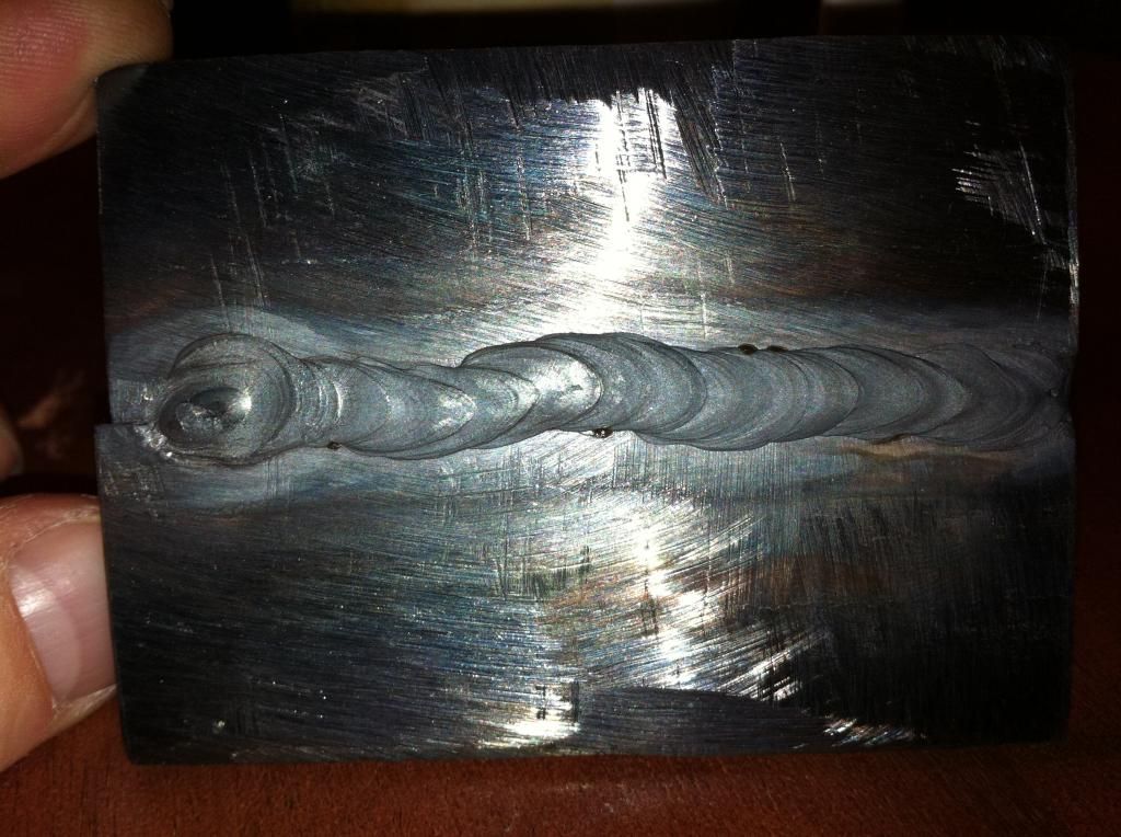

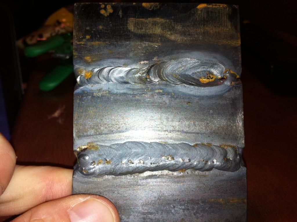

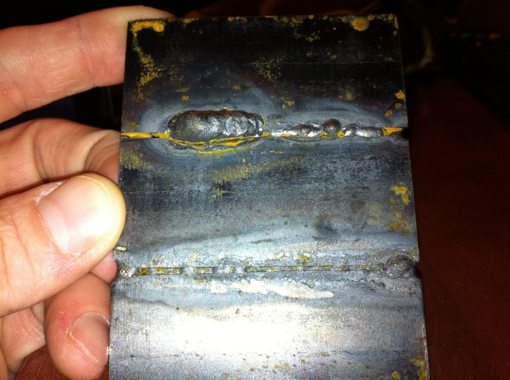

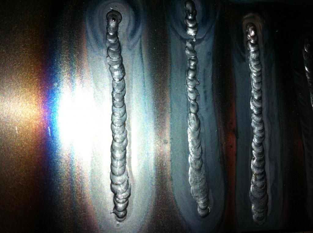

Seems way too hot, you don't want much more than about 100 amps, With the lower amperage you can be a bit slower and more precise on feeding the filler rod in, what sort of stickout and arc length do you have, stickout of about 6mm and an arc gap of 3mm at most
gas flow should be about 8LPM in decent conditions, finally a newbie that realises the importance of clean metal.

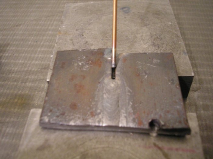

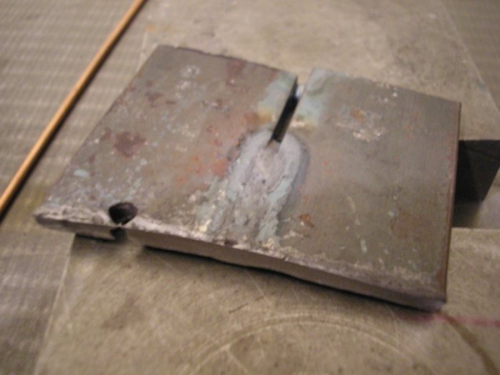

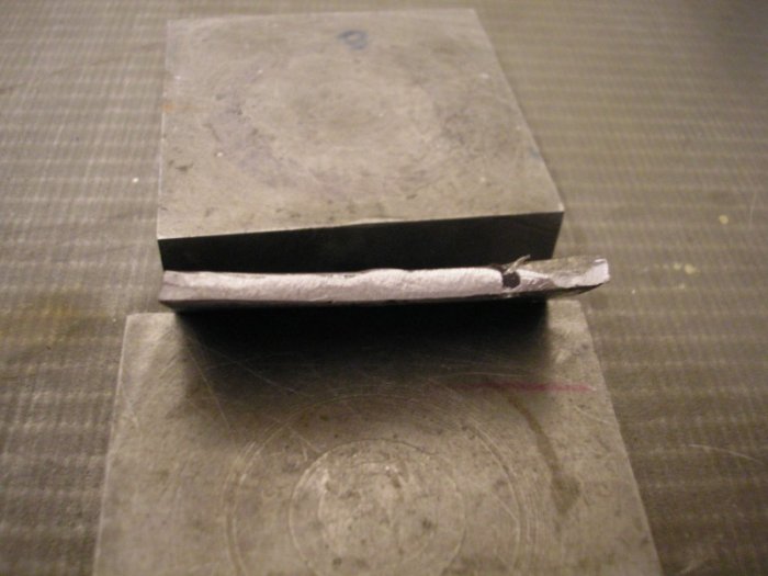

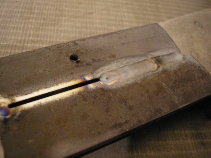

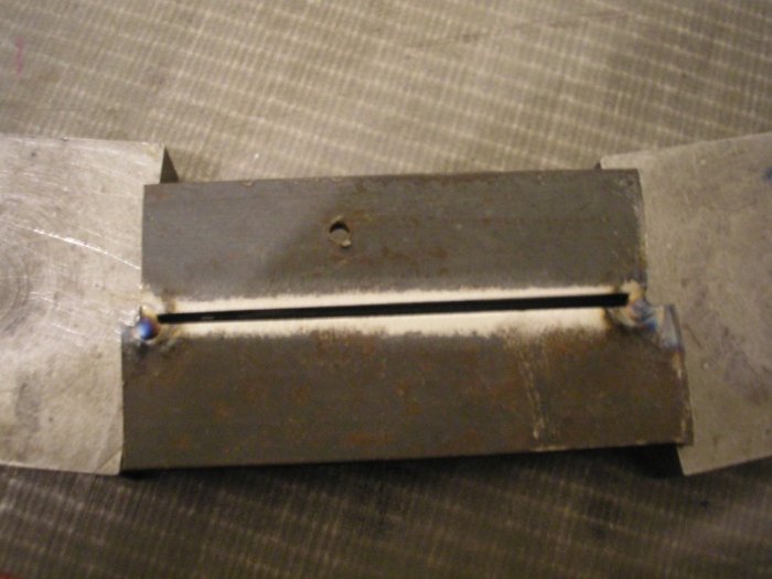

Leave a gap between the pieces you're welding. Use a piece of filler rod to set the gap and bridge the gap with tacks. As you weld, push the rod into the gap. You can use far lower amps, have more control and get much better penetration.
...and the plate will pull like hell with a gap?
How thin is 'thin'?
Or do you have another way of dealing with butts?

We don't really do much with plate/section under 5-6mm. Leaving gaps (with what we do anyway) is a receipe for pulling when welding up. Id rather see the plates tight together and a bigger prep.
